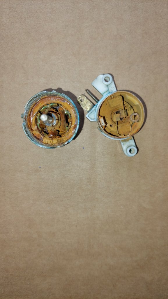

My washer failed to work last week and I've just discovered why:
The motor is rusted solid, no movement at all between the rotor and stator parts. The drain hole for the motor had become blocked and water has clearly found it's way past the seals.
Does anyone have a working one I can purchase?

You can take the washer motor out of the bag that’s the rear washer reservoir, they are the same motor
