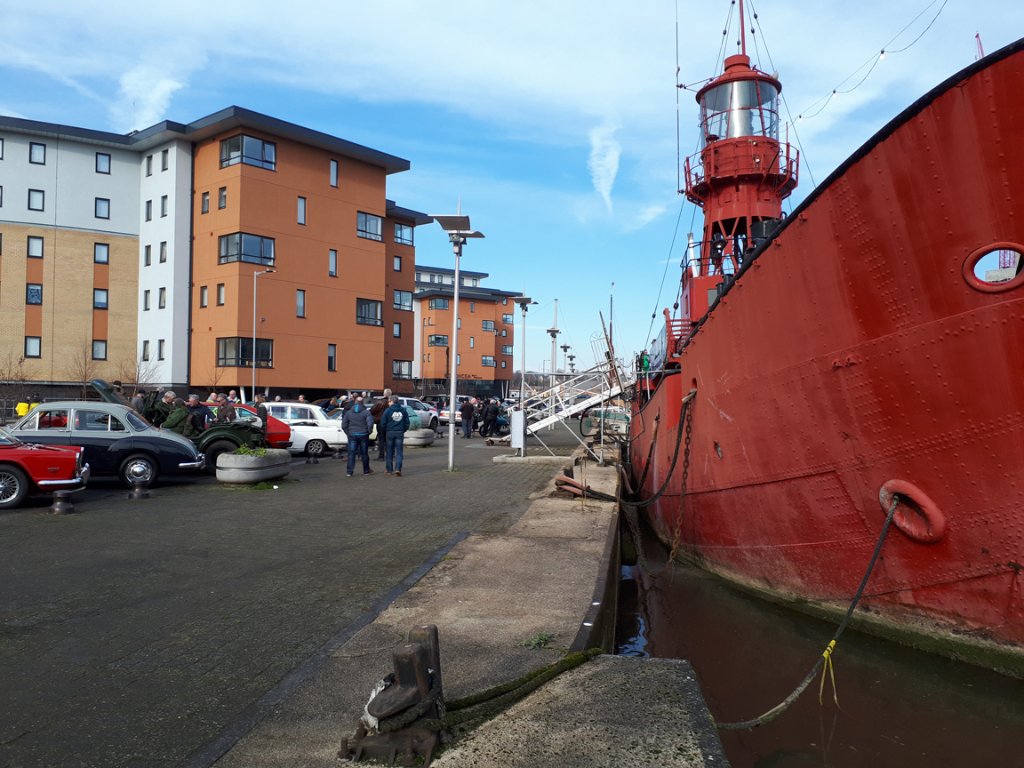

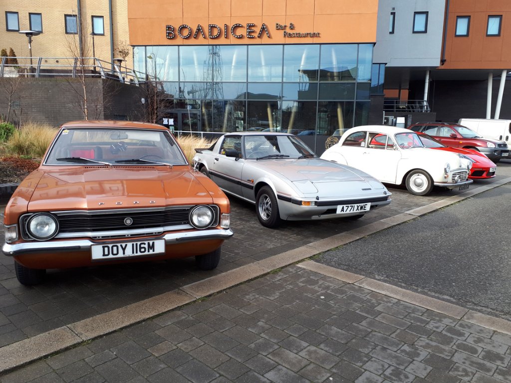

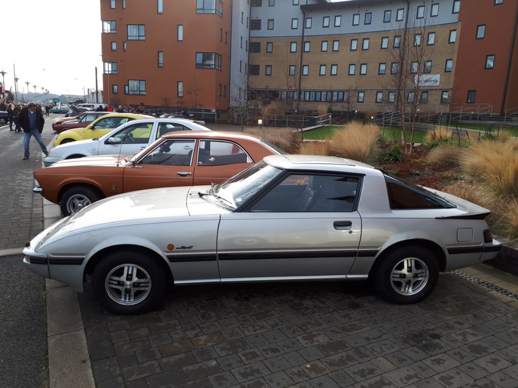

Nice weather today for a short trip to take KIMI 2 to a local car show alongside the river Colne :)
Good to see another rotary turn up too, a 2004 plate RX-8 (forgot to take a pic of it though :oops: ).

Decent day for it aye! That's a cool location too :D
