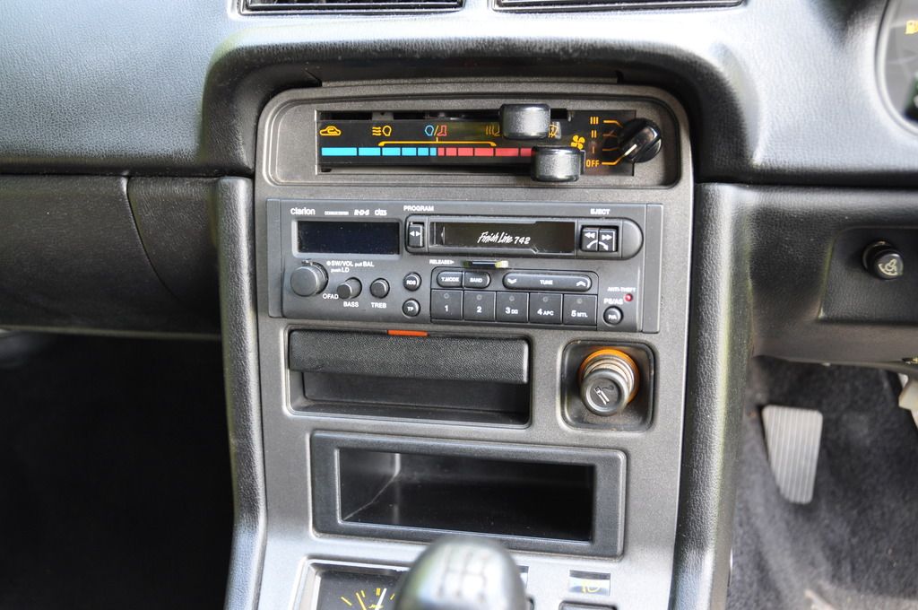

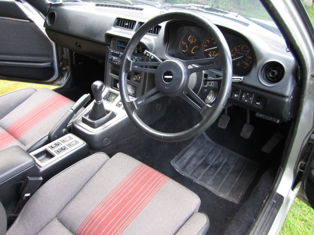

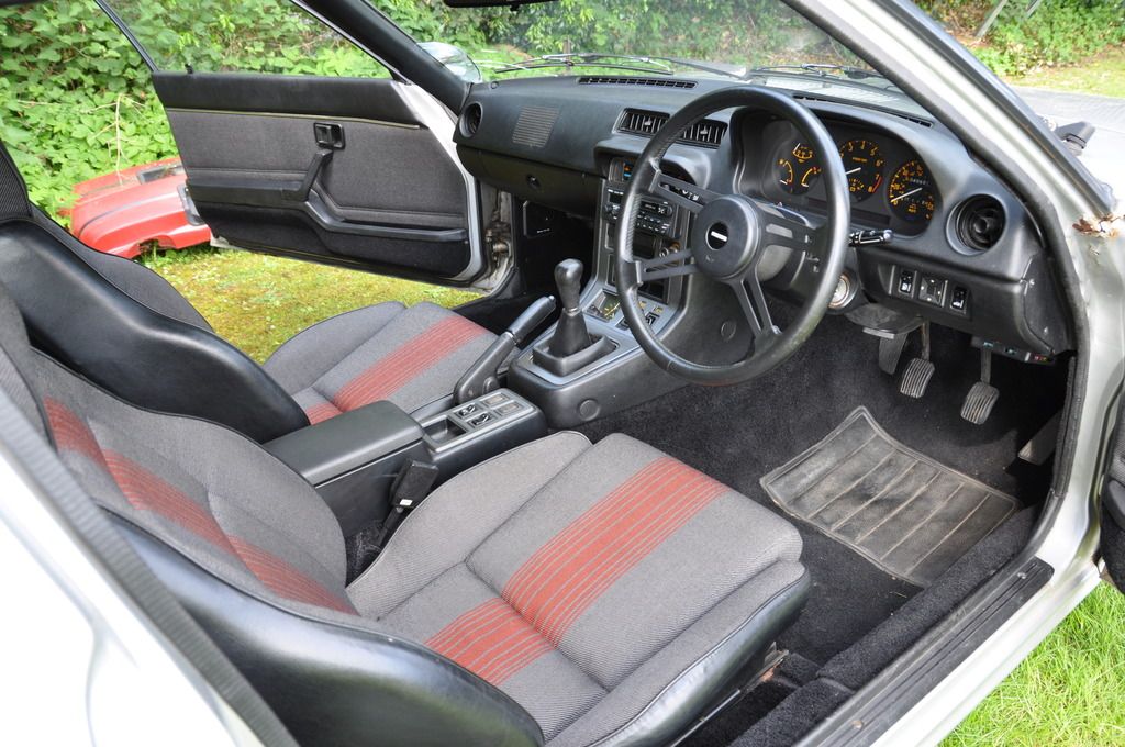

I just realised I haven't posted up any interior pictures. The condition of the interior is another reason I want to salvage this car as a runner;
And the mileage :D ;

it just goes to show how well these cars hide their rust.... Kimi 2 looks a very clean tidy car in the photos despite the corrosion lurking..... fair play to you Malcolm for restoring it though, it definitely looks worth saving, especially with that mileage and interior.

Well done for saving her, guys! That interior looks superb in the photos, I always liked the S2 seats best

Yeah, S2 interior all the way for me too.
