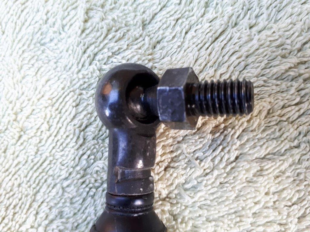

Casey wrote: Tue Jun 05, 2018 12:54 am (or you can prise off the ball head to get access to tighten).
Any idea if one can prise the ball head off the original? That was gonna be my next move since that upper fixing refuses to budge. :evil:

I'll take a look at the old arm and see if the ball will slip out easily. Were you thinking of re-using the head by slipping it into a new arm? I'm not sure if the head sizes are the same. Again, I'll take a look.
Alternatively, can you carefully use a Dremel saw wheel, or similar, to cut the head off? Then you can remove the plastic side trim to get better access to the stuck bolt. I'm sure it must come out with good access?
Re: KIMI 2 - 1983 Series 2
I thought re using the head would be the easiest option. :idea: Dremel is back up plan.

KiwiDave wrote: Tue Jun 05, 2018 9:08 am
I tried to get the ball head to pop out of the OEM arm that I've replaced. I put the bolt in a small vice and used the strut as a lever, but no luck. The bolt just slips out of the vice jaws, no matter how tight the vice grip. Maybe with a mega vice it might be possible. The ball looks to be held in with a circular spring clip, presumably inserted after the ball and I can't see a way to remove the clip without destroying the holder.

Thanks for trying s(c) Plan B it is then.
