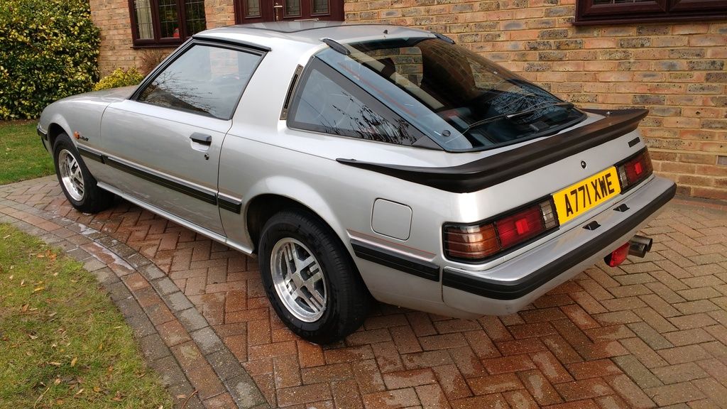

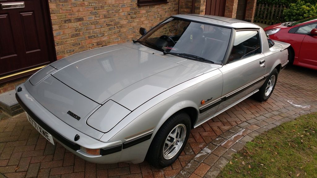

Re: KIMI 2 - 1983 Series 2
Gratuitous few pics - cleaned her to dazzle the MOT man and make sure she looks well looked after :D
The photos do flatter - the paintwork needs attention in a lot of places!
MoT is next Tuesday - not Monday as I stated above :oops:
Casey looking good, silver does scrub up well.
Thx guys, the pictures flatter her, but she's pretty good overall.
