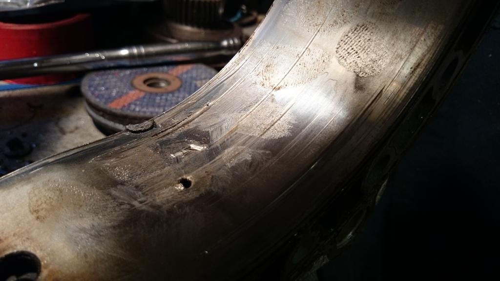

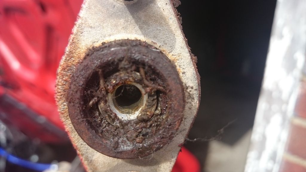

TWiR is up to her usual tricks again. Was going to swap out the tie rod ends today since it was nice. Not a big job really. But the second split pin snapped and is now jammed inside the bolt with the loop end inaccessable ( well, to me anyway). Arrrgh! I've never not been able to remove a split pin WTF :!: More thought required for the second attempt.

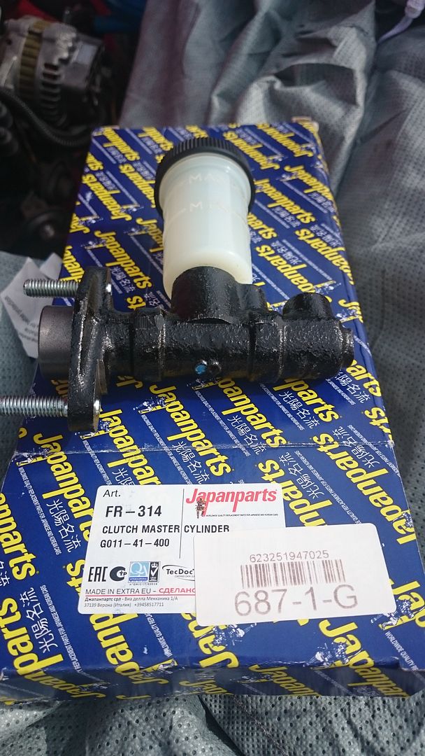

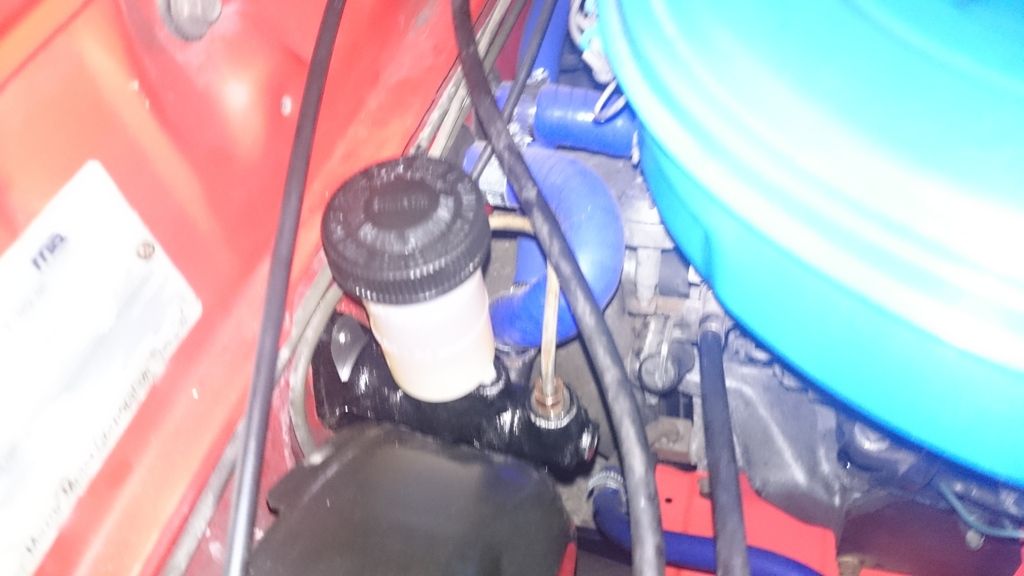

I decided to embark on something else so as to not waste the nice weather entirely. Swap out the clutch master cylinder for a shiny new one :D The fluid color has been getting progressively darker.
Crusty old one has stuck down a few times and there is evidence of leaking on the bulkhead.
Probably overdue for replacement
Access to the cylinder mounting points from inside the car reminded me that I am not in my teens or twenties anymore. :( However, after some cursing (which is always helpful), it all worked out in the end. I used a looped cable tie to keep the actuator rod straight while sliding the master cylinder unit into place. Whoever put that tip up on here, thankyou th:

haha, changed mine not long ago... it's a pain in the arse to get in there :)
While I was in there I wanted to do the master cylinder but this one appeared to be completely stucked on the firewall :(
I'll change it... some other time lol

Dave, I have just changed mine (inner & Outers) & I had the same problem with the split pins, in the end I had to knock the eyed end in as far as I could & then undone the Castle nut which just cut through the mild steel pin, the other one that sheared I used a masonry nail (having ground the point flat) & managed to hit with a lump hammer until the eye came out enough to lever out with a bradawl, another one of those "quick" jobs yay
Re: TWiR 1986 S3 TWR
Tiny HSS drill, about 1/16th inch and just drill gently down the line of the pin.
It usually fragments. Need to be gentle as the bit might 'grab'

Great tips guys. I'll take them under advisement. Quite liking the HSS drill option although I'll need to get the front of the car up a bit higher. Will have a go on my next days off. :)
