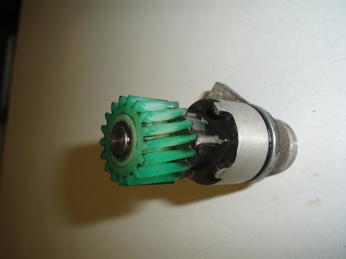

ian65 wrote:Remember though that you need a replacement gearbox from a series 3 RX7. Each series 1,2 & 3 had different speedo ratios and aren't interchangeable...... if you put a s2 box into your s3 car, your speedo will be miles out.
Sorry to hijack the thread - but is there a way of knowing what gearbox is what...I have a spare in my shed, but not sure what series it's from...
Re: C264 GJO 1986 Series 3 TWR
If you pull the speedo drive out Marc, the drive cog is coloured (green, white etc).... I can't remember which is which at the moment.... but I'll check it out later and let you know. It's the only way to positively confirm which box you have.

I'm confident this 17 tooth Green Speedo Drive is from an S2, 'cos I took it out of the gearbox.
I think S3's are Black colour??
