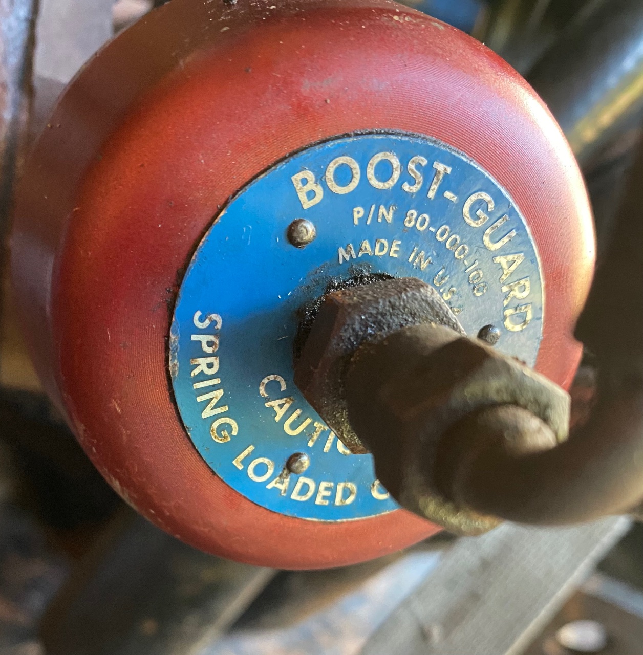

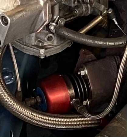

If you’re following my S2 recommission thread, you’ll know that I have taken the plunge and removed the elford engine, for a couple of small repairs.
I thought I had better have a look at the wastegate, as I have never removed it !!
OMG it was seized solid…. It took 20 minutes of tapping to get it free, good job I haven’t wound the old girl up fully yet lol 😜.
The more eagle eyed of you, might have noticed that I also replaced the OMP rod with a new cable, as the rod was sticking occasionally and holding the revs at 2000 rpm.
