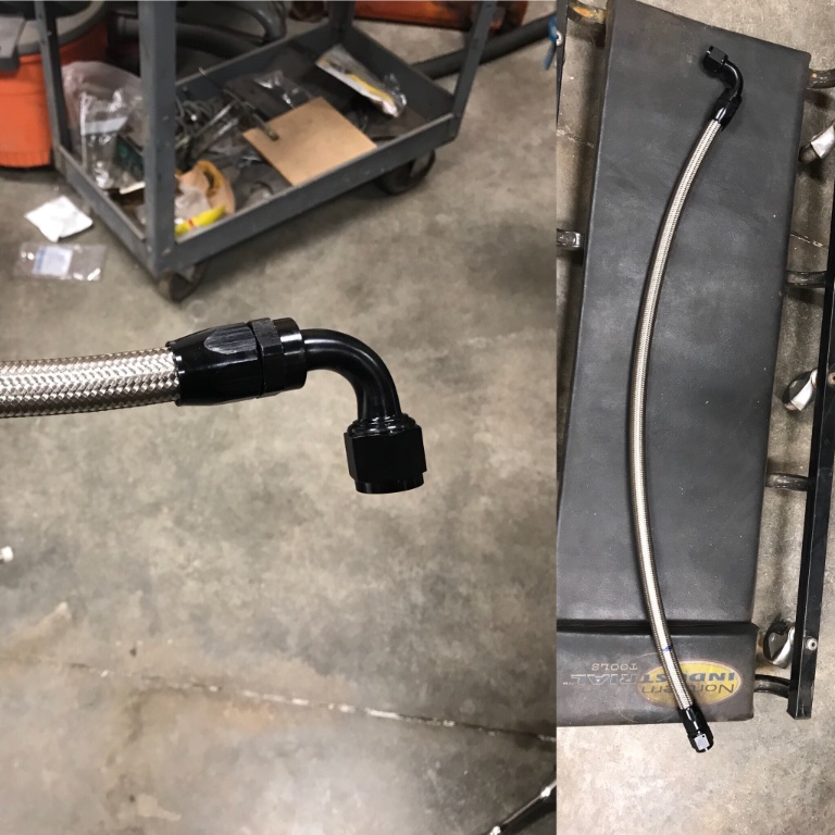

Attempted my first ever AN braided lines tonight.. think Innailed it.. what a bitch to work with haha
Oil cooler lines..
1 down.. the other tomorrow...
Re: 84GSLSE 13BREW Swap build
good stuff, that looks great.............and yeah, they are a bitch to work with :)
