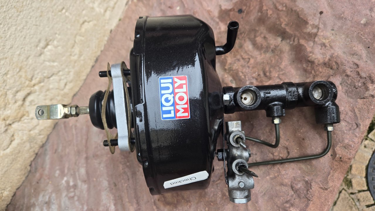

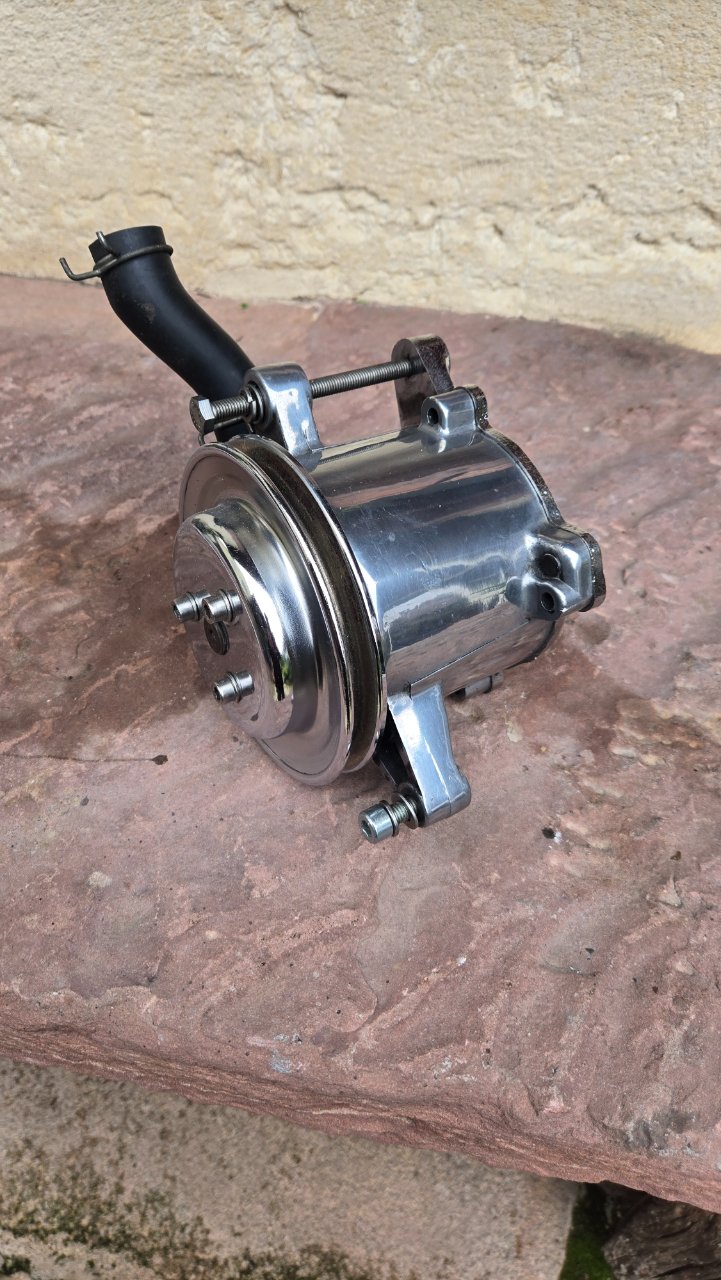

I haven't posted anything for a long time because everything is working great. Since I have many spare parts in duplicate, I am now restoring the parts that are in stock. Currently, brakes are my focus.
20251102_104635.mp4
(16.71 MiB) Downloaded 38 times
20240823_175625.mp4
(88.63 MiB) Downloaded 37 times
