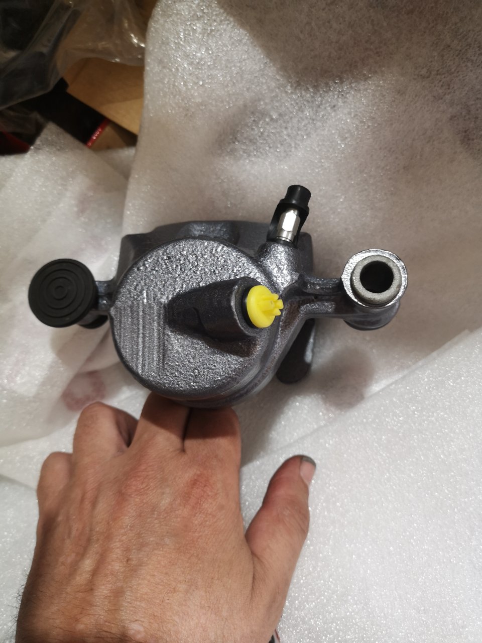

Not quite as sorted as I imagined ☹️
I need the boot that fits in the right hand side. Currently looks like this, that's not going to work. You can see the end of the slider pin!
Does anyone know where I can get the proper boot or a work around? Brake Caliper Services could not find the boot anywhere. I don't even know what it looks like.
Suggestions and remedies appreciated 3-2-1 Go

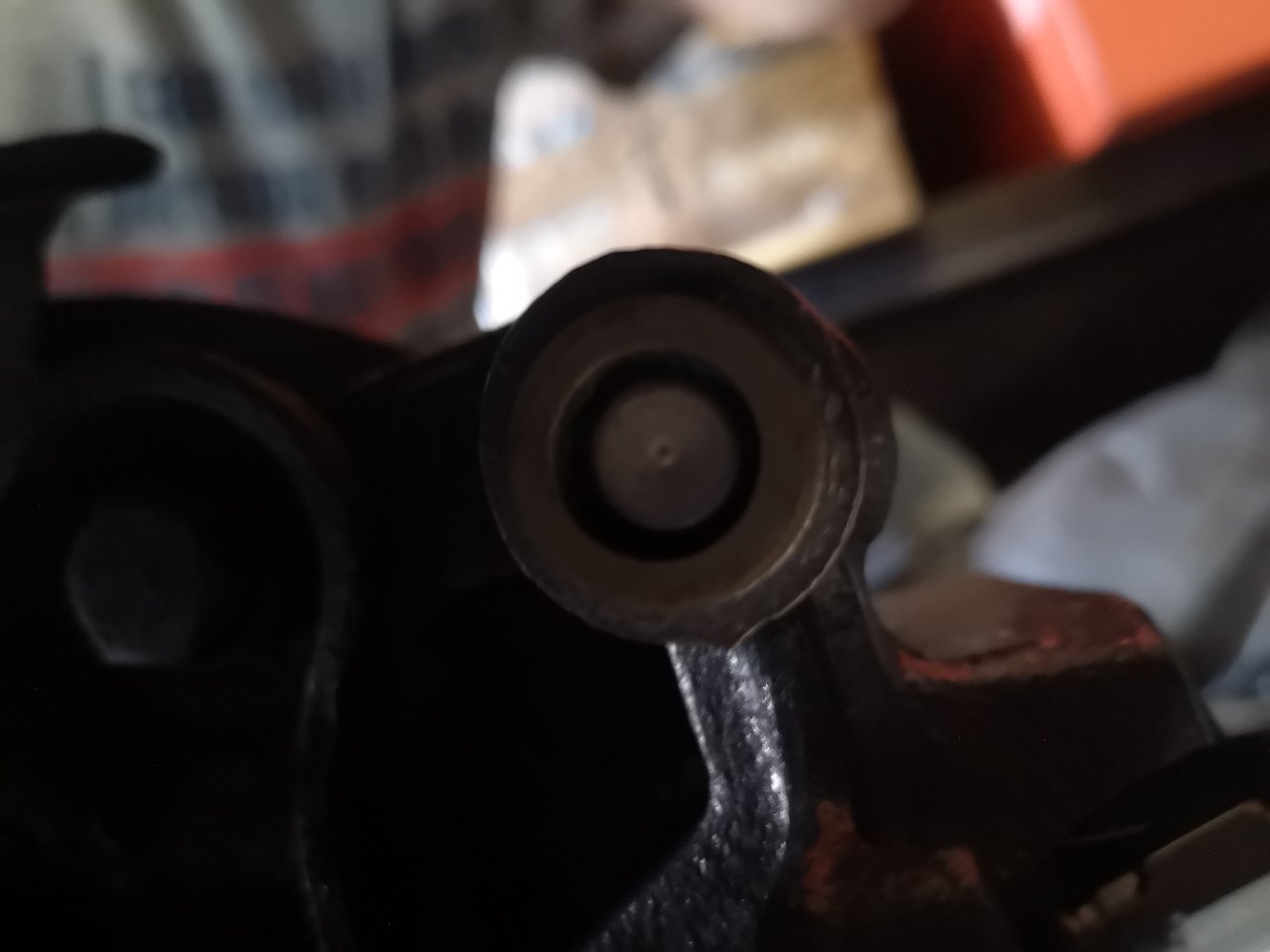

You could measure it for a brass plug/cap? Mine has tiny holes in the centre I’m assuming to allow the pin to slide back and forth without creating a pressure differential. You could fit a brass cap and drill a tiny hole in the centre
Re: S3 front caliper slider pin boots
Hi Victor. Could you post a pic of your setup, just so I have an idea of what to look for? No hurry, just when and if you can (or anyone reading this).
The calipers were sent to them with the old boots attached so I have nothing to reference.

Sorry Dave got confused with the pictures and thought the black rubber plug on the top photo was what was missing from the bottom photo! Now I see they’re both the same caliper !… I understand what you’re after now.. I might have a spare rubber boot as I kept the calipers from my parts car and they hadn’t long been refurbished… I’m offshore at the moment but will take a look when I get back

Actually I think I was right the first time around and it’s just a metal cap with a tiny hole.. no judgement please iv been working 9 weeks straight with no break so I’m exhausted 😂
I’m due home next Wednesday and il take a look then for you .. unless someone else is able to get to it in the meantime
