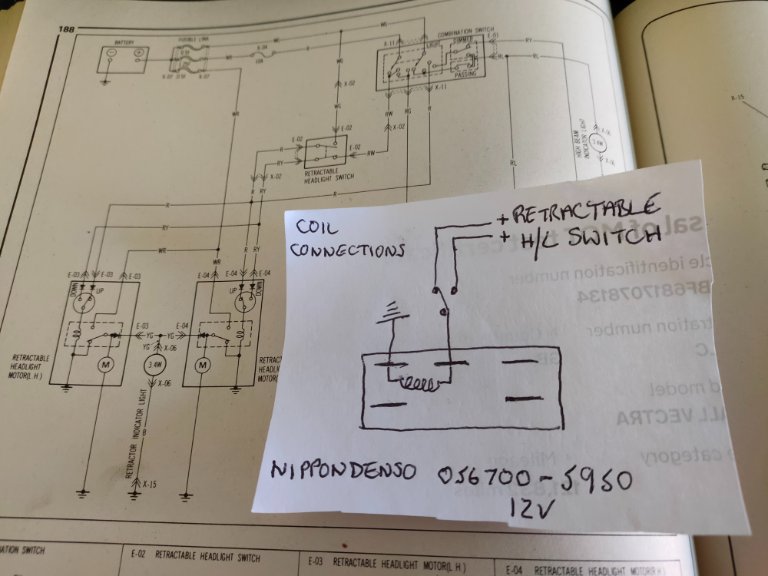

Anybody have the pin layout for Denso 056700-5950 Headlight Relay ?
Thanks
Phil
1of1
Posts: 26
Joined: Sat Dec 08, 2012 7:48 pm
Location: basingstoke
Been thanked: 7 times
Re: Headlight motor relay
Post by 1of1 »
Lights now all working.
Started off at the fusible links, all appeared ok.
Then tested feed to relay from Retractable light switch, also ok.
Tested RHS relay, all working.
Then found missing + feed on r/w cable.
After several linking out procedures to check light operation
traced back to where I started faulty connection in top fusible link spade connection.
Attached relay information for future reference.
