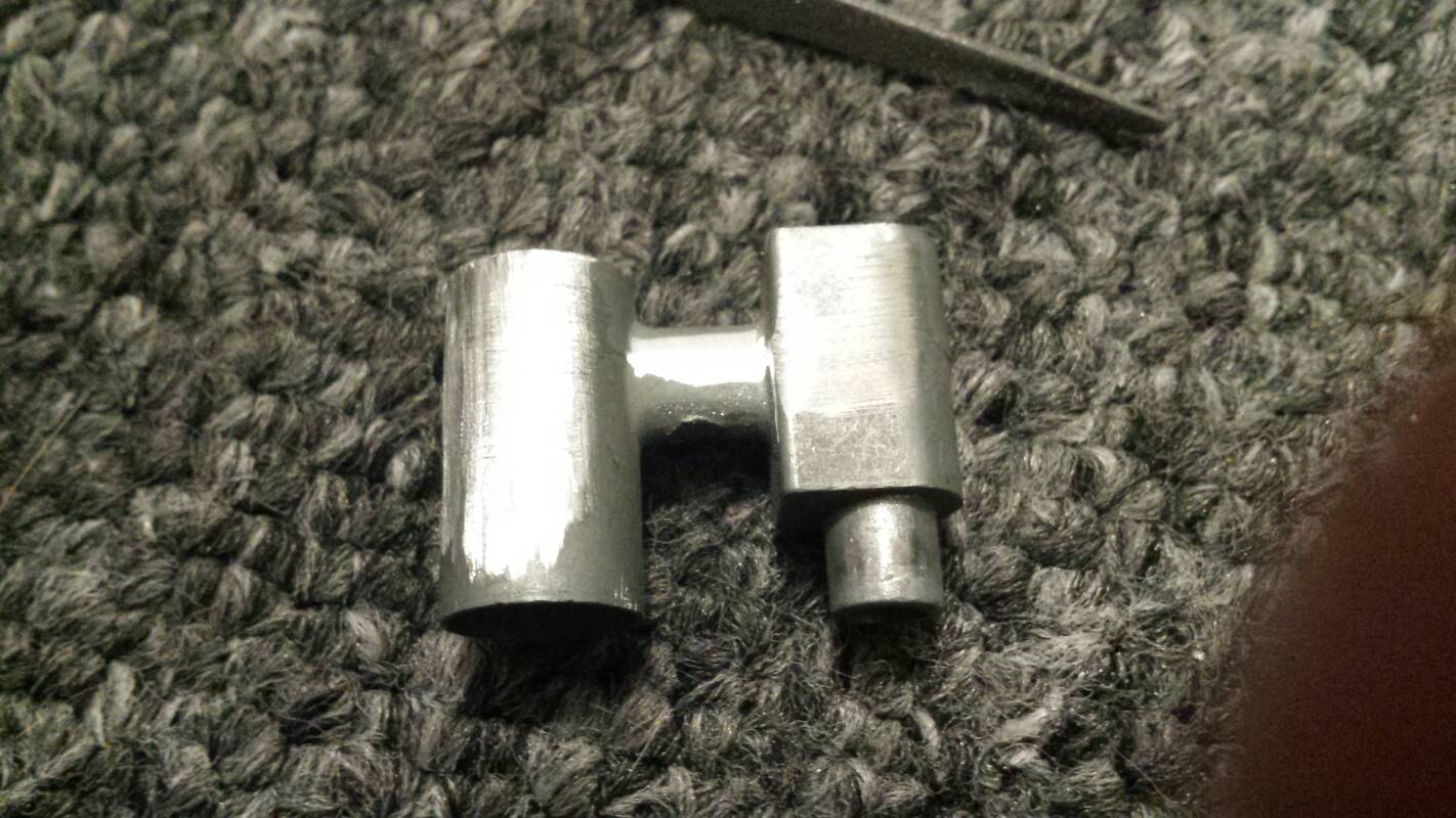

The booster venturis can arms can be cut back and filed to an aerofoil shape to help with the airflow. Polish them with 2000 grit for extra slippery-ness.
