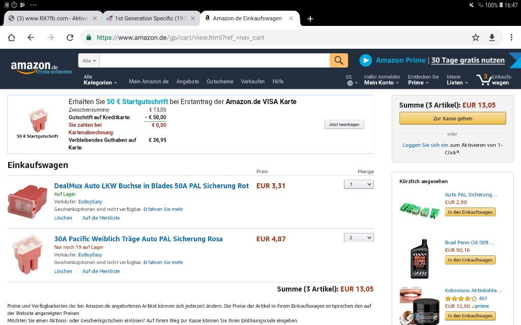

But for today, I've made do with a little improvement instead by replacing the 3 fusible links in the engine bay with PAL fuses. Unplug the old fusible links and plug these bad boys in their place. SIMPLES.
Re: TWiR 1986 S3 TWR
Thanks for sharing Dave. I try to get them from amazon!
