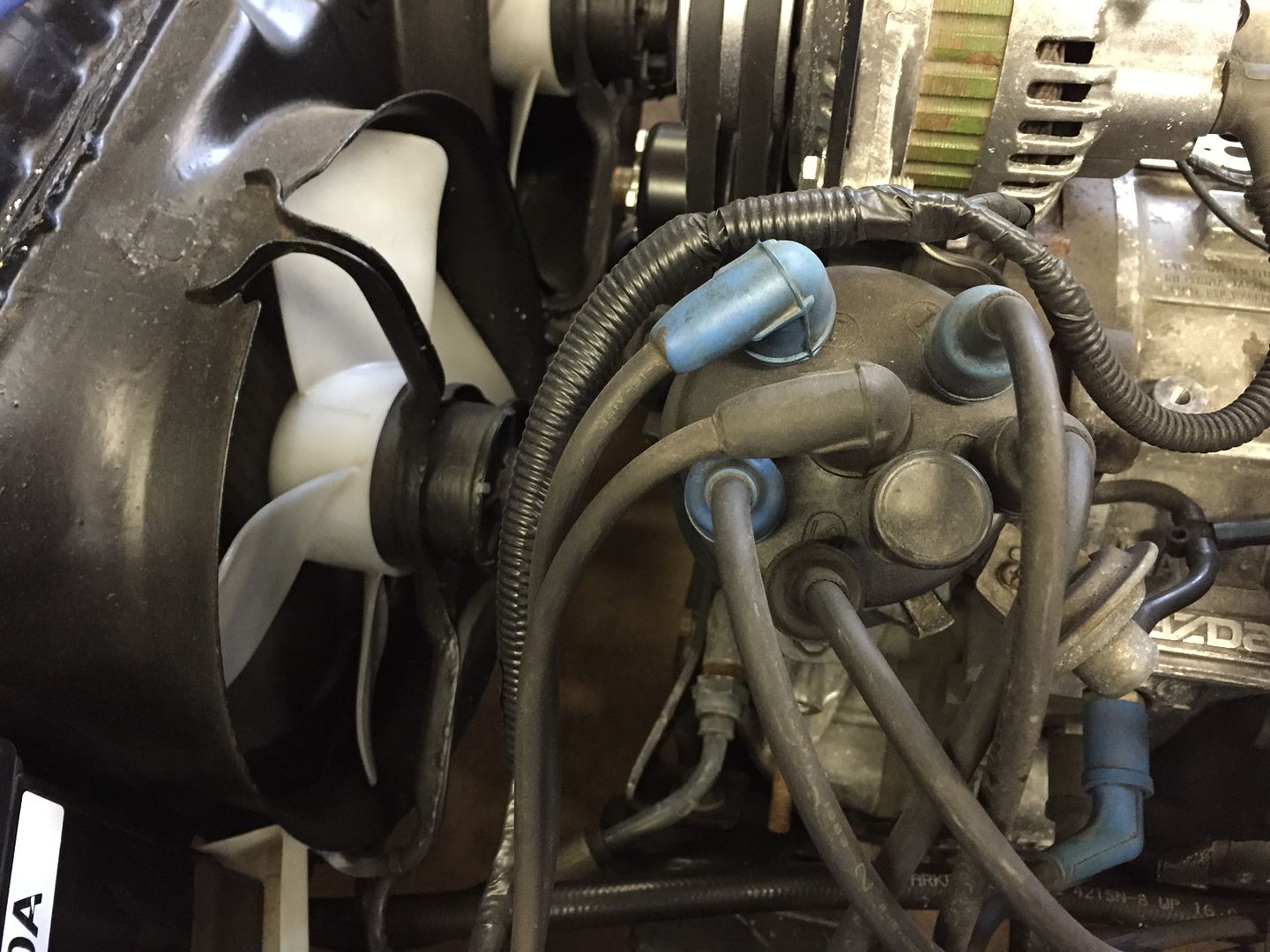

Hard to be sure from your pic on previous page, but I think you have the HT leads reversed on your front rotor?

Casey wrote:Hard to be sure from your pic on previous page, but I think you have the HT leads reversed on your front rotor?
Yep I was just going to say that, after checking myself - Could it really all be that simple !?!? :oops:

Distributor cap is marked.....L1, L2, T1, T2
Rotors are 1....2 from radiator. Trailing plugs are the top 2. So looking onto the plugs you have T1, T2 at the top, L1, L2 at the bottom.
Just trace the leads back on that basis.
Oh, and the metering pump lines look fine, no worries.
Sadly this wasn't it, although my battery does need a decent charge after the starting attempts today. Atleast it's connected up correctly now though.
