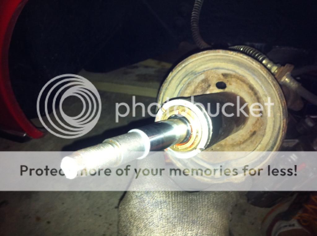

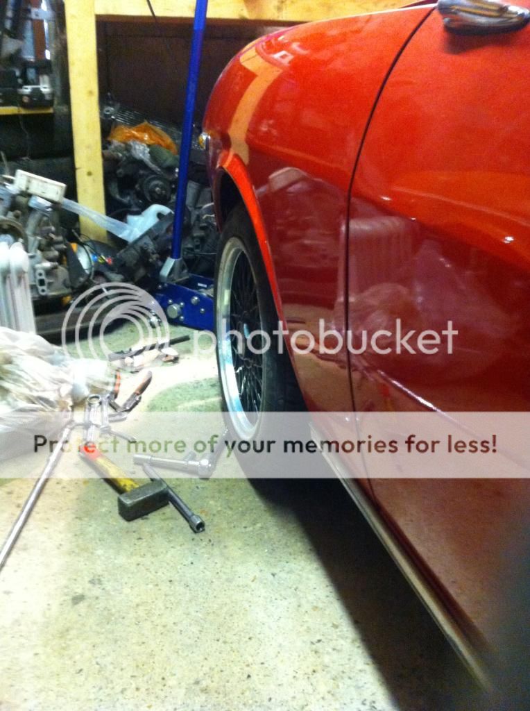

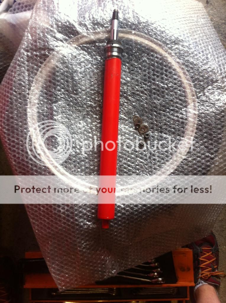

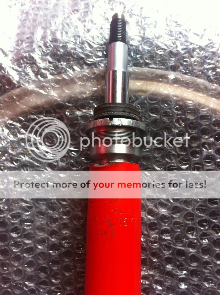

I got the shocks back finally. They look like this (Koni adjustable):
This is what they look like installed:

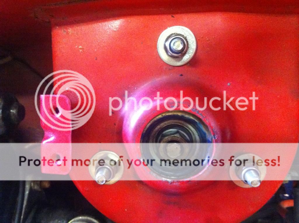

With the adjustable camber tops:

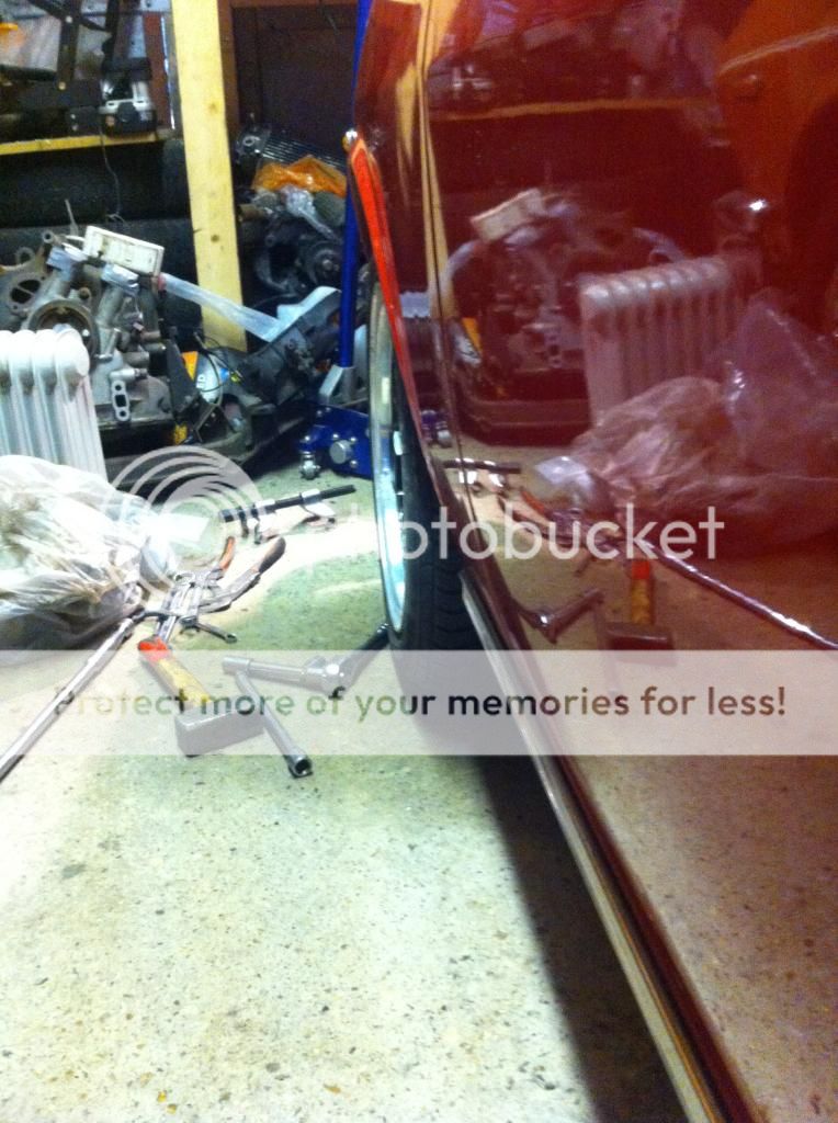

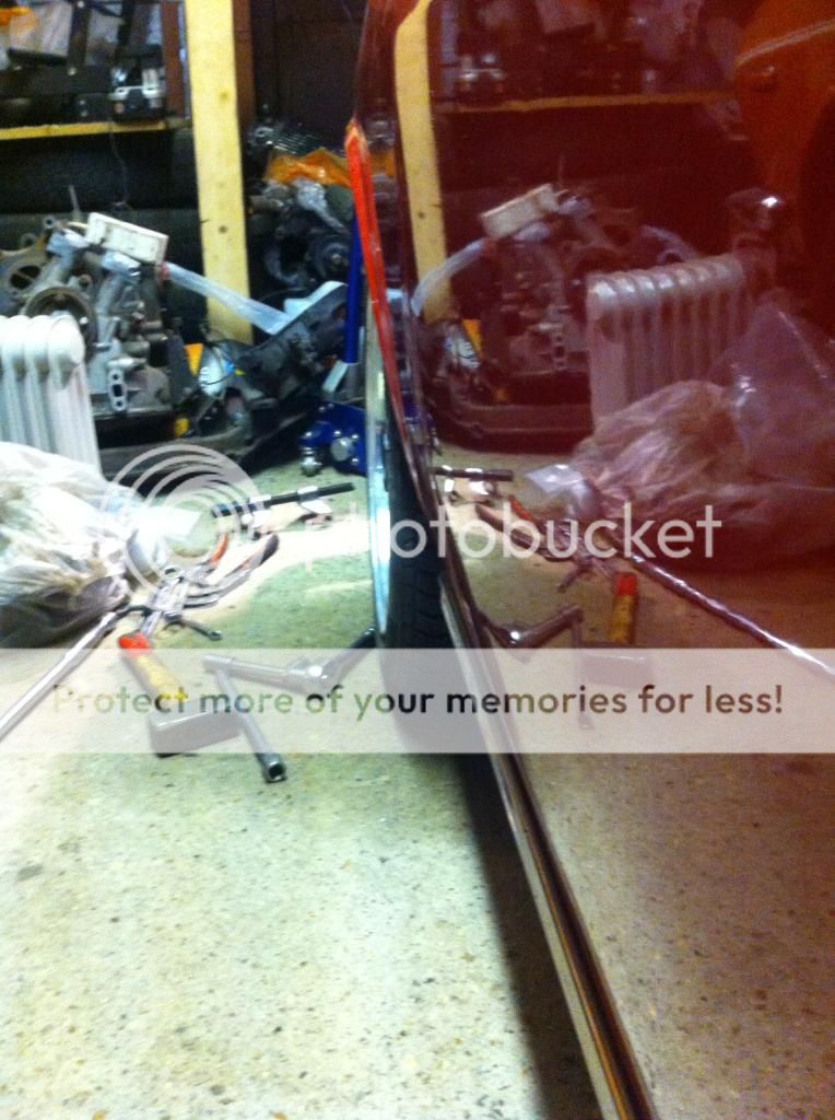

The result; negative camber:

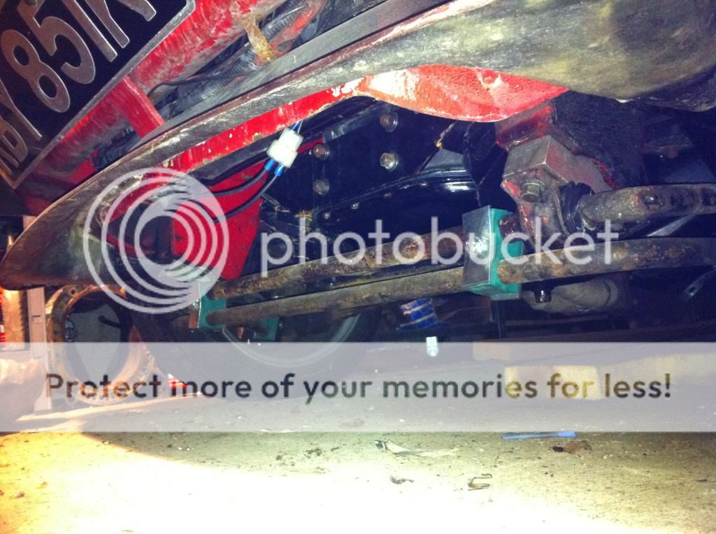

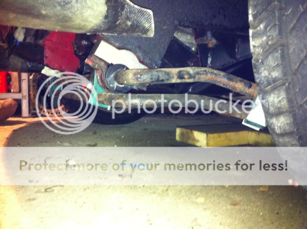

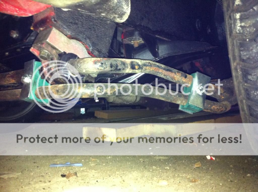

Now, the other thing I've done is fit a second sway bar to the front of the car. I managed to locate a second front sway bar for an RX2, chopped the ends off and bought some brackets to attach the second bar to the first bar.
Should stiffen things up a bit. No sway bar in th rear as the RX2 needs to be kept loose at the back allegedly.

[quote="TOOL"]Now, the other thing I've done is fit a second sway bar to the front of the car. I managed to locate a second front sway bar for an RX2, chopped the ends off and bought some brackets to attach the second bar to the first bar.
Imagequote]
I did something similar with my RX3 a long long time ago (bodywork helpfully modified so you can see the suspension upgrade) :roll:

Exactly Dave. Hence the "oldschool" in the thread title. No need for fancy swaybars and coilovers.
Incidentally, the original swaybar is 2mm thicker than the extra one anyway.
My rear shocks are beefier units too.
