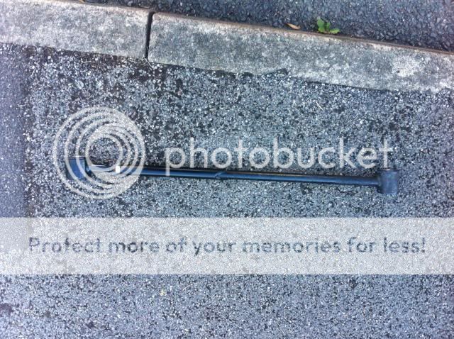

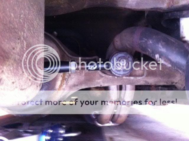

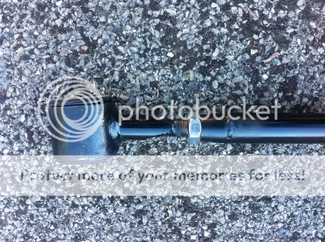

The front and rear suspension is similar to the FB. MacPherson stru up front, live axle in the rear with coils ( not leaf springs like RX3 and RX4), and a panhard rod, not a watts link.
