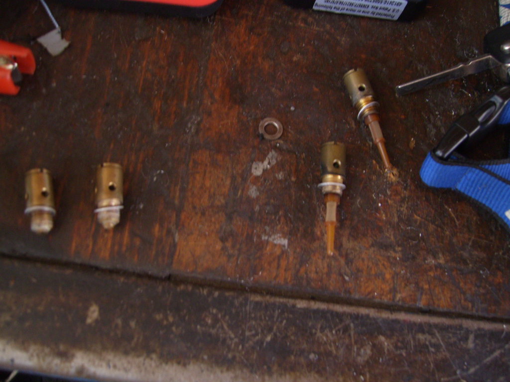

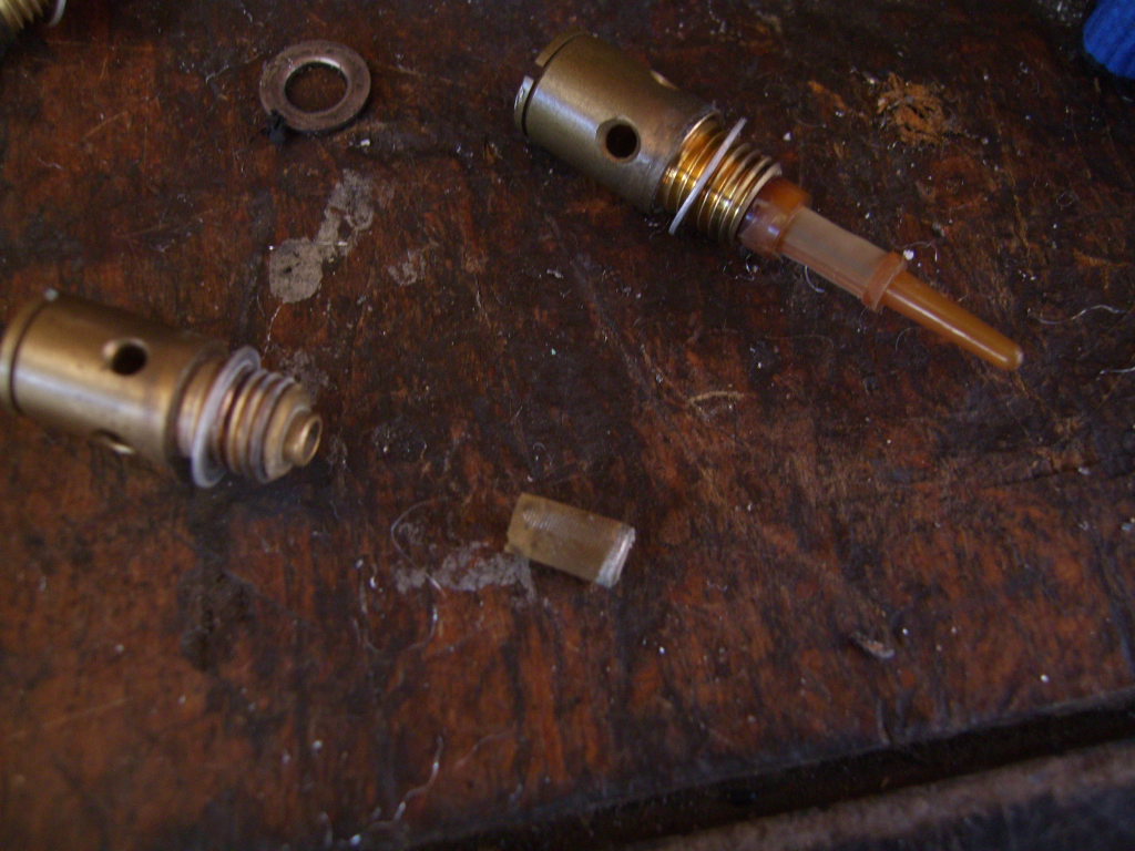

that'll be a good result if it solves the problem.... well done on finding that filter... I wonder how many people don't even know that it's there? The carb models also have 2 tiny mesh filters the size of a finger nail that aren't listed in the workshop manual.... I spent 3 weeks once trying to get a car to run until I discovered those filters and it had been to 3 repair shops before me who couldn't get it running and gave up.Any chance you could put a short description of exactly where you found it in the 'Fuel, exhausts & emission systems' section of the forum? That might be very useful to someone suffering fueling problems on a GSL-SE and that will probably be the first place they look for help.
Hope it sorts your problem
