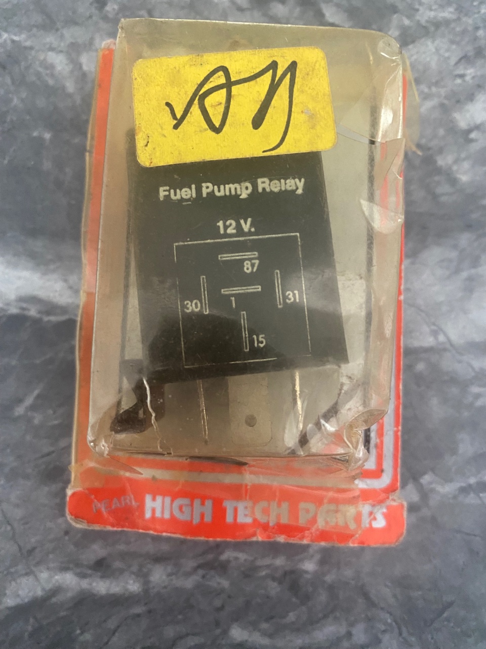

Would anyone happen to know if the Oil Pressure sender can be used as a negative trigger for a relay? I’d like for the PAS pump to only become live once the engine is running. So that I can still have the ignition on for radio etc without it kicking the PAS pump in and draining the battery

Re: Electronic powered steering ?
Post by Porters2 »
Hi Vic,
Sorry mate, but in my experience the switch goes to earth at low pressure, so that will have the opposite effect and run the pump when engine is off ☹️
Steve.
Had a thought though !!
The old xr3i escort had a multi pin fuel pump relay, if my memory is correct one of the pins was a coil input so that the pump only runs when engine running, I think your steering pump would only prime until the engine fires with one of those 👍

Hmm depending on the voltage output of the sender, that might still work..
The Escort relay is a good shout though! Il do a bit of research and see what can be found .. thanks Steve!

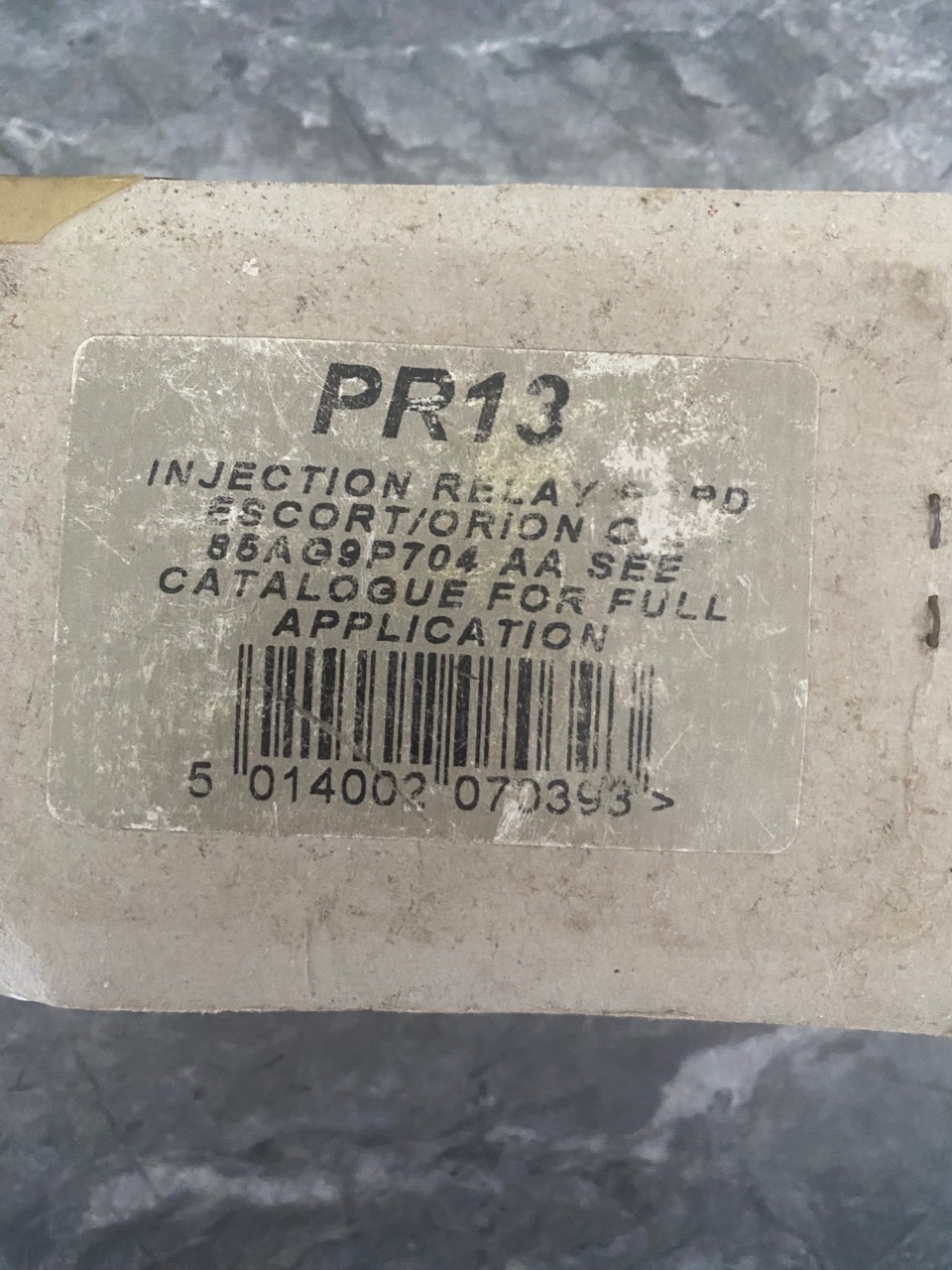

Post by Porters2 »
:thumbup:
It’s not pretty, but it’s 20 years old NOS lol.
Yours if you need it matey.
Steve.
Post by Porters2 »
Victorsanders wrote: Tue Jul 29, 2025 12:15 pm
Porters2 wrote: Tue Jul 29, 2025 10:02 am :thumbup:
Steve.
You sir are a legend! Yes please.. pop me a WhatsApp with how much you’re after please mate and il send it over
Don’t be daft, I will whack it in the post when I get a chance, I’m up to my neck in a wheel bearing on my daughters audi at the moment.
