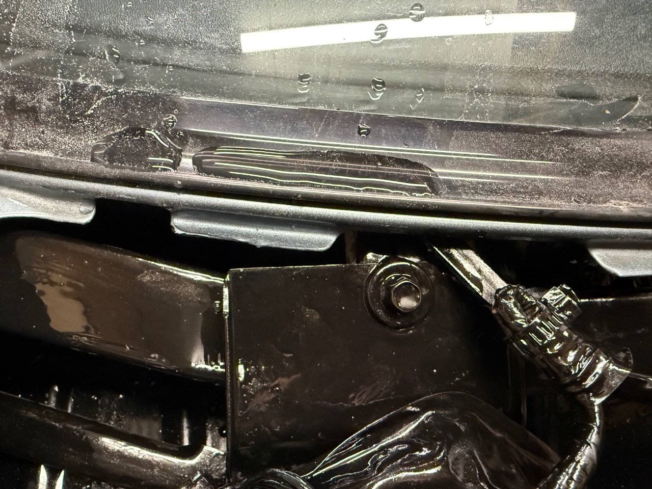

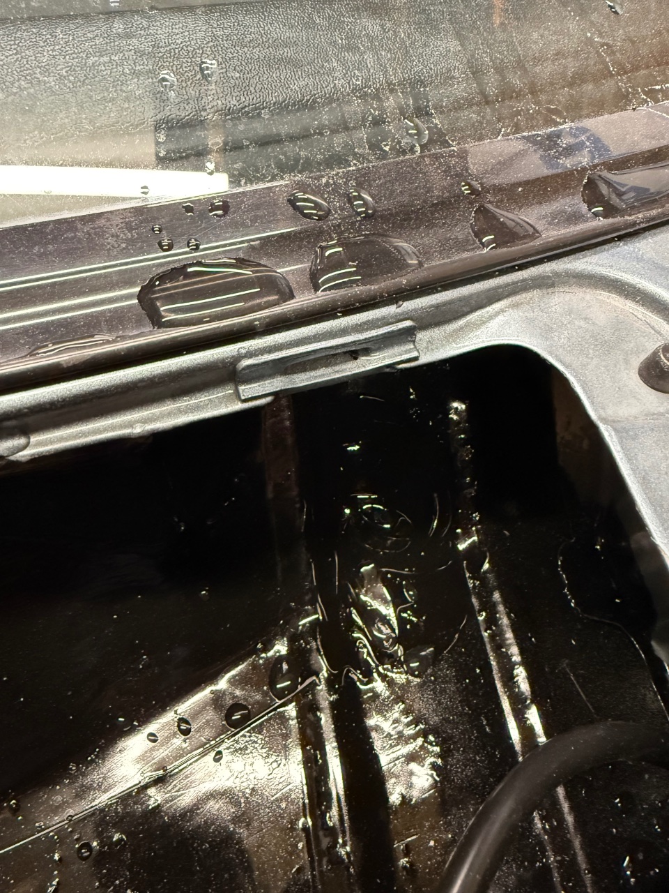

My scuttle rattles a bit on bumpy roads.. noticed 2 of the clips were missing!

I think if all 3 were missing then it would sit flat and wouldn’t rattle.. but having one means it sits slightly lop sided and rattles.
Iv made up some clips with some old Teflon parts I had laying around. That should do the trick!

I used some teflon feet I had for an old 3d printer and just cut them into the right shape .. when I’m back from my next job, il mock some clips up on the pc and get some printed in TPU. Il let you know once done and il send you some over mate .. might be a few weeks though as I’m busy as hell at the moment 😂
