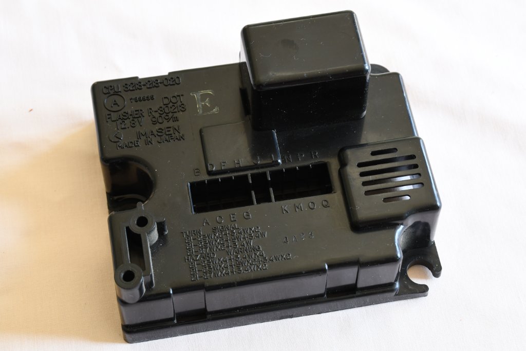

Thanks to Kiwidave, who supplied a spare (possibly faulty) unit, I have been doing some investigative work on this module, tucked up on the panel near the driver's knee (UK model).
This is early analysis results, so excuse the quality of the diagrams, which I hope to refine and post up later.
Here is the unit in question, which seems to appear in versions A thro F (white lettering on the module). My investigation is on a version "E" module. Circuit board has been removed in this photo:
It's a bit fiddly to remove as the three nuts holding it in place are a little hard to access. There is one large connector block and one smaller, single (or double on some versions I believe) connector. Once the three nuts are the two connections disconnected, it is easily removed.
3 rubber grommets hold a metal shield on the back of the unit in place. Slide these grommets off to remove the metal plate, then two self tapping screws hold the circuit board in place, Remove those screws and unclip the board from the edges of the casing to reveal:

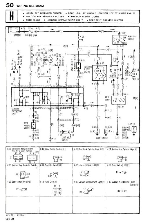

These Mazda wiring diagrams helped to identify some of the external connections to the module. It's made harder as the diagrams cover functions not available on UK models, such as seatbelt warning buzzers, etc.
However, the letters M, C, K, J, G and E enabled me to sketch out this circuit and determine it provided an intermittent signal to the dashboard mounted buzzer to sound when a door was open and the car lights were left on (left hand part of the circuit below).
Additionally, the right hand part of the circuit provided a roughly 20-30 second "ground" to the ignition barrel light to illuminate the key area, triggered when a door was opened. I have managed to confirm these circuits and their operation by hooking up suitable inputs and outputs.
