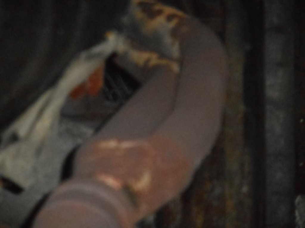

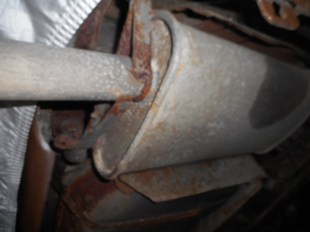

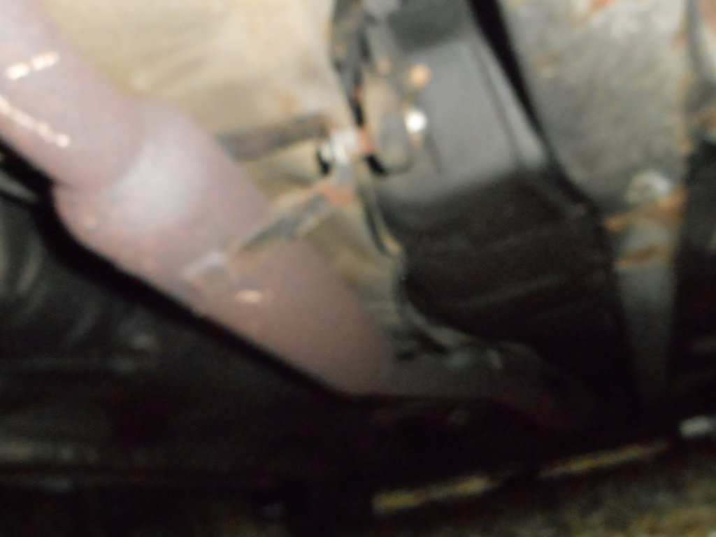

our exhaust is scabby from sitting but very solid so given a good clean and paint should be just fine. The back box is a single pipe so def. not standard, the middle box is small and like a curved bomb style. The downpipes are twin and quite long. I can find no pictures in my manuals of a standard system but wondered if it could be an aftermarket performance one.
What did a standard FB series 2 manifold/downpipe look like?
I will try and picture ours when I get the car in the air to remove fuel tank.

a bit out of focus but think the set up can be seen.

Re: exhaust
That is an aftermarket Janspeed system.The back boxes are quite substantial items and do a reasonable job. The resonator is prone to failure as it is fiberglass packed. The system gets louder with age as the fiberglass packing in the resonator breaks down. Having said that, I ran a system for years and got on with it fine.
Weak point is the 2 into 1 collector. Exhaust systems on a rotary engine get incredibly hot and the constant heat cycling takes it's toll eventually.
I might still have a back box or two sitting around somewhere. What components are you looking for?

Re: exhaust
Dave is spot on - I can also confirm it's the Janspeed exhaust system, same as I have in KIMI 1, with Janspeed clearly visible on my chrome tail pipe. Plus I bought a spare (new, old stock) Janspeed manifold and it's identical to the one I have, and the one in your photo.

Re: exhaust
cool, thanks. I did suspect Janspeed. I had a janspeed system on an MGB circa 1984 ;0) with weber 45, stage 2 head etc.
I dont think I need anything for the exhaust, it all looks sound and no blows.
