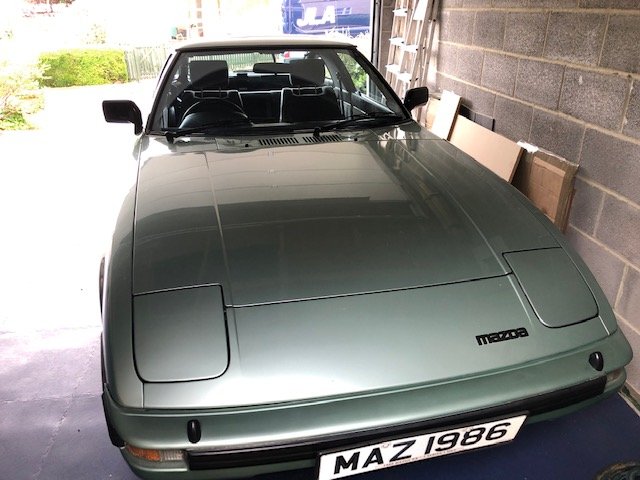

I was planning to take some decent ones on Saturday when I get on the road. I have these from the garage yesterday as a taster.

Looks in really good condition, based on those pics :thumbup:

s(c) th: Lucky man! Cool colour combo green/grey and i like to see the old rotary owner club sticker. Let me remember the old days in Haddenham on Jimmy's farm :lol:

spirit r wrote: Tue Jul 28, 2020 2:35 pm Cool colour combo green/grey and i like to see the old rotary owner club sticker. Let me remember the old days in Haddenham on Jimmy's farm
Yes I am lucky Mazda ran out of the Brown interior near the end of production so car was fitted with the grey/black interior.
Old sticker is for the American RX7 club which I was a member of back in 1987/88 before there was any real UK club. Car was at Haddenham on several occasions. First time in 1995 was with the previous owner and it had reg C845TGX
