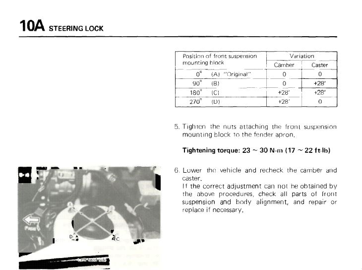

Re: Self wheel alignment on FB
Post by KYPREO »
Refer to this diagram
strut top alignment.jpg (55.49 KiB) Viewed 6748 times
Position 'A' (in towards the engine and towards the front of the vehicle) is the factory position.
I personally recommend position 'B', which adds approximately 0.5 deg of caster and improved steering geometry. You won't notice heavier steering with such a small adjustment. Further caster can be obtained by adjusting the caster rods. More is better, but how much you're willing to add if a function of how much steering effort you're willing to tolerate.
