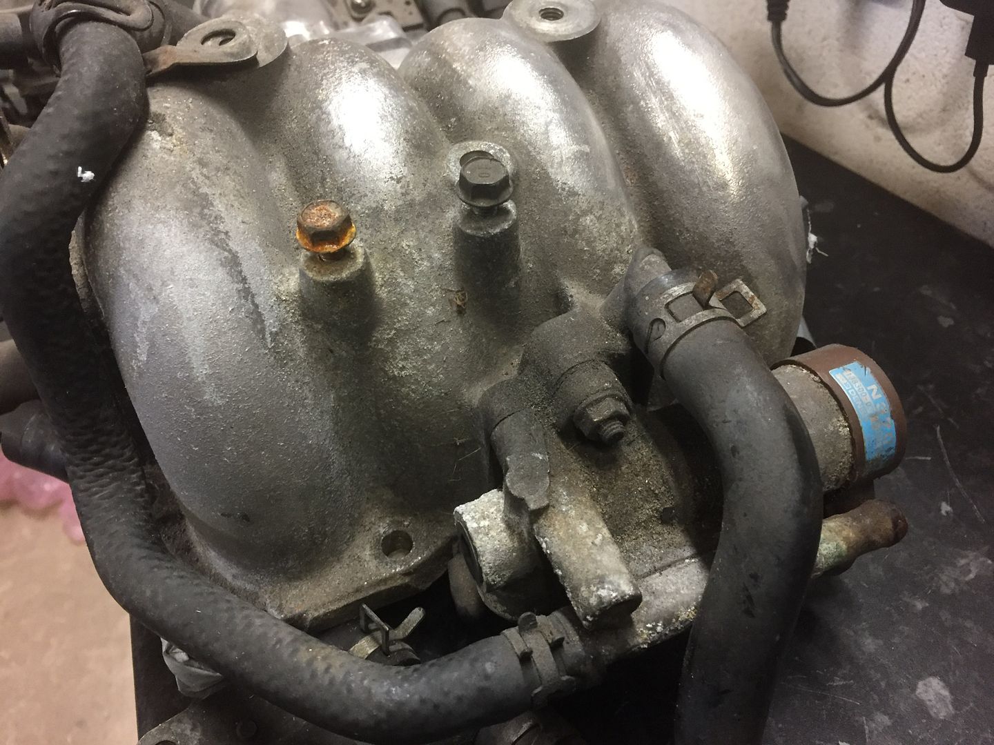

I want to paint the inlet manifolds on my engine. I can't be bothered to polish them and if I clean them back to clean alloy they will just oxidise again so I reckon painting is the way to go...
I want something pretty durable and tough.... thinking of something like this...

Does it suggest any sort of acid etch primer first?
Re: Painting cast alloy inlet manifolds
It seems to be OK as you won't exceed those temps, so should be fine. You will have a lot of prep to do.

DKWW2000 wrote:It seems to be OK as you won't exceed those temps, so should be fine. You will have a lot of prep to do.
I'll use trade alloy wheel cleaner..... an acid solution to clean the manifolds back Pete.... this will get rid of the crud and etch the surface for paint at the same time.... the dirt and oxidisation just drops of using this stuff.
They were like this yesterday...
and after 20 minutes they looked like they do in the pictures in my previous post. I could just clean them back with wheel cleaner and top coat them with lacquer but I don't know how that would stand up.
Whatever I end up coating them with I'll have to clean all the crud off them first.

Might not be the look you're going for but I love the look of red crinkle finish VHT
What about powder coating? It was fairly cheap when I took that whole lot to get done. I was really surprised aye. Could get a few bits done at the same time? I believe there is a chrome type colour if you want shiney :lol: . They do all the work also :D
