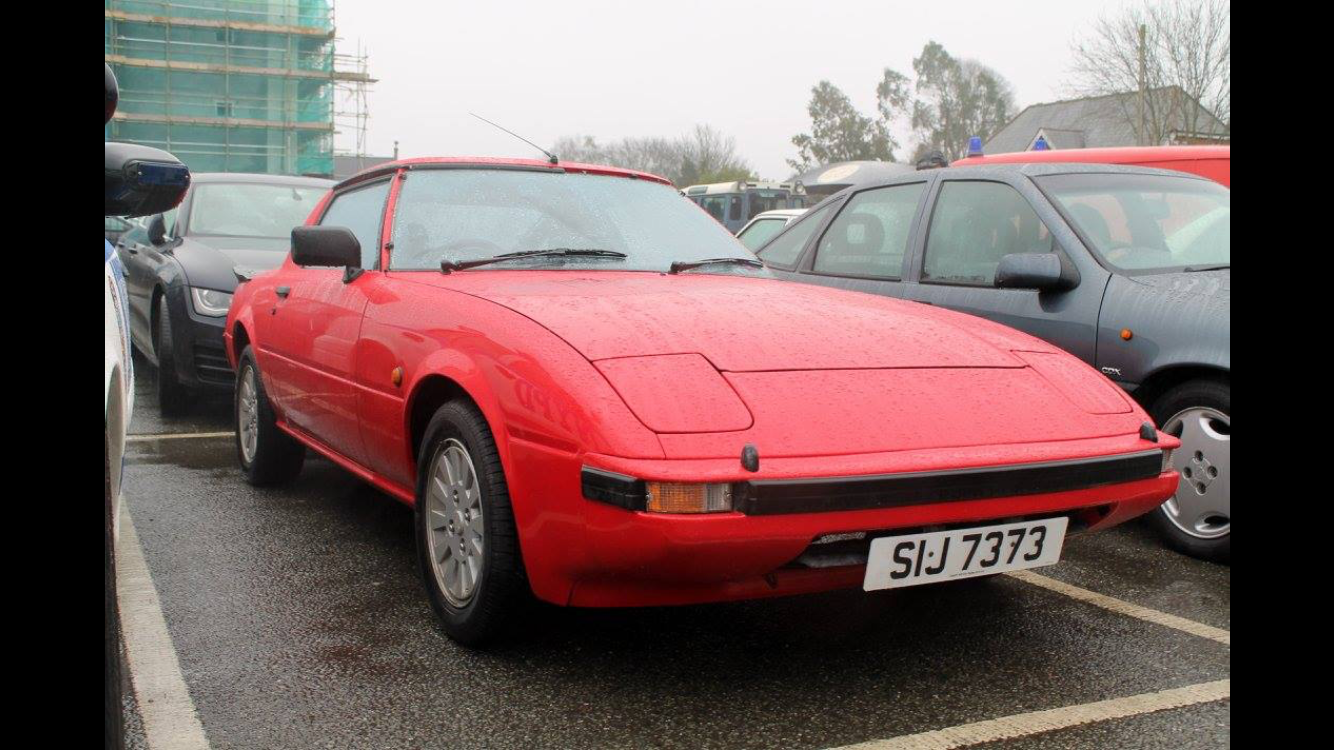

My names Matt, I live in Essex, England and I now own a reasonably clean FB!
I’ve had a few oldish Japanese cars, namely s14/14a’s, a couple of s13’s, skylines, soarers and then other stuff like e30’s, 420sec and a '70 bug etc (the rest isn’t as interesting!)
After a few years away from ‘fun cars’ I now have this!
From what I understand it used to run a ford 1.8 pinto lump. The guy I got it off fitted the 12a engine again and didn't quite get it finished… so I intend to! I have issues with bogging down when the car comes onto the second choke (but I will find the appropriate forum to stick up a post for that… or use the ‘search’.) it’s had the rats nest removed so I'm currently trying to swot up so I can be comfortable with this type of engine – I’ve had fun driving it so far though…even if only on the first choke!
As said, I am in Essex, so if anyone if reasonable local and can shed any light – get in touch!
Enough chat - PICS! (disclaimer - I have the windscreen trim... in the boot. needs to be fitted)
Image]

Nice looking car you have, the bogging down could be many things, check the simple stuff first, fuel delivery, fuel filters (there is a small filter in the carb), float levels, are the secondaries even opening? (vacuum operated).

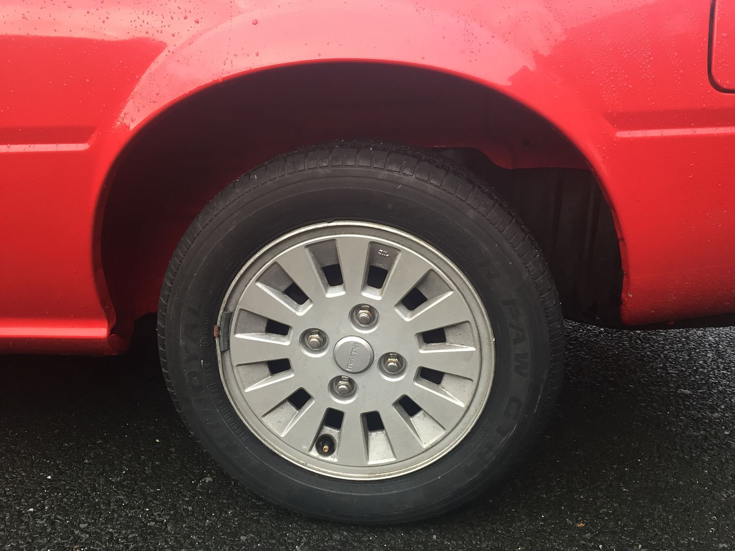

Judging by the rear ride hight I'd say its out of fuel :lol:
