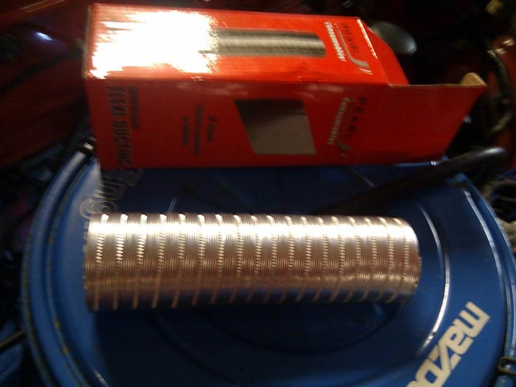

Don't you just hate it when your bits dangle untidily in mid air? Well I do and I decided to do something about it!!
Because TWiR has spurned the factory exhaust manifold in favor of some Janspeed headers (or extractors if you will), there is nothing to connect the warm air ducting that goes to the air cleaner assembly. And this kinda got me all OCD until I consulted the big interweb entity which is called EBay ....
Please can I have 1x flexible ducting tube and 1x thermal reactor heat sheild?
And as luck would have it, the mountings still contained screws
The dishwasher did such a good job that painting can wait for a while!
One job down, no added performance plus added weight

Neat job Dave, but you know what you need to top it off................A nice blue blanking plug for that unused pipe on the air filter box.
P.M me your address and I will pop you one in the post, beats gaffa tape
