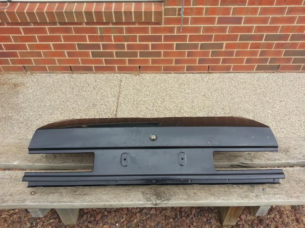

Well, I'm now on the look out for a new rear panel/beaver panel (see attached image). The hatch rust is fixable but in a difficult location so the panel needs to be unstitched and removed for repair on a bench to ensure all the rust is gone. It will be more economical to just put in a replacement panel, assuming one can be found. NLA from Mazda Australia, Japan and the US but there appear to be lots floating around the place. They seem to come up on ebay etc from time to time.
As a last resort, Phils Rotaries in Queensland, Australia, is having reproduction panels reproduced in China. They should have one available for purchase by the end of May, but no idea how this will compare to an original OEM panel.
I'd be grateful if you guys can keep a look out for me.

Have you asked multirotor? That’s the sort of thing he would have.

No I haven't. I haven't been suggested to contact him before and didn't receive a response last time. Do you know the best way to contact him by any chance?

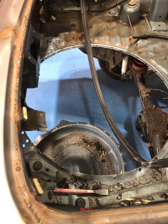

Bye bye fuel tank
Oops. I better not puncture a tyre now.

Nice progress lately aye! What's happening with the spare wheel well? Going to a fuel cell? I've debated this for my EFI conversion as it's be easy to make an aluminium tank without the spare wheel there
. Can't decide if I'd want to risk not having a spare wheel though?!

Close! Spare wheel is being replaced with flat floor to provide extra clearance for the LPG tank. My LPG tank is a cylinder and is much taller than the factory tank when installed. The upshot is that it's also shallower so there is more room for an adjustable panhard rod.Hobbawobba wrote: ↑Wed Apr 18, 2018 9:33 pm Nice progress lately aye! What's happening with the spare wheel well? Going to a fuel cell? I've debated this for my EFI conversion as it's be easy to make an aluminium tank without the spare wheel there. Can't decide if I'd want to risk not having a spare wheel though?!
I could have tried to fit the tank without body modifications. But, for safety reasons, there are stricter minimum ground clearance limits for LPG tanks. Plus it will look nicer with the tank tucked into the car more.
Australian series 3s got a space saver spare wheel, not a full size one, and it's a very different rolling diameter to my wheels and therefore basically useless anyway. I will keep one of those emergency foam inflators in the car.
