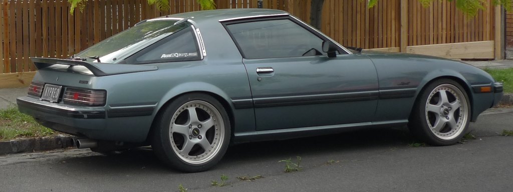

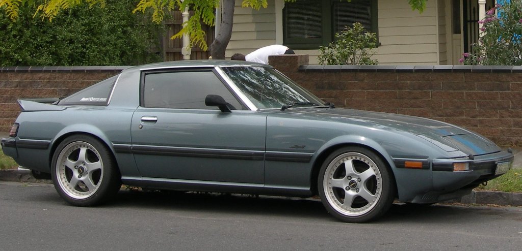

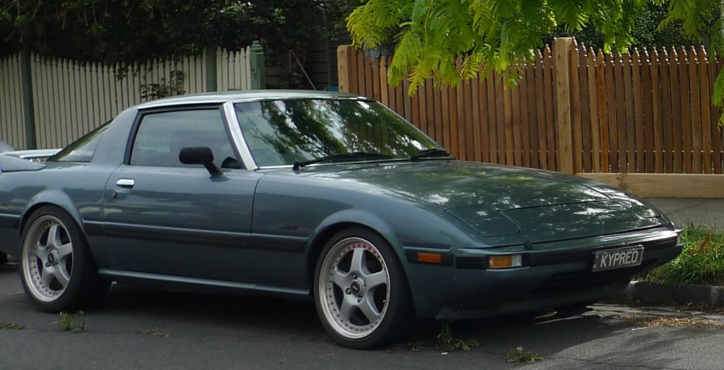

Here is the ride now:
And now for what's in store...
