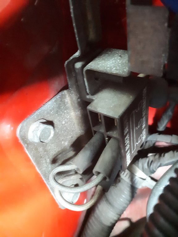

2nd little job was to tidy up the fuse block near the battery.

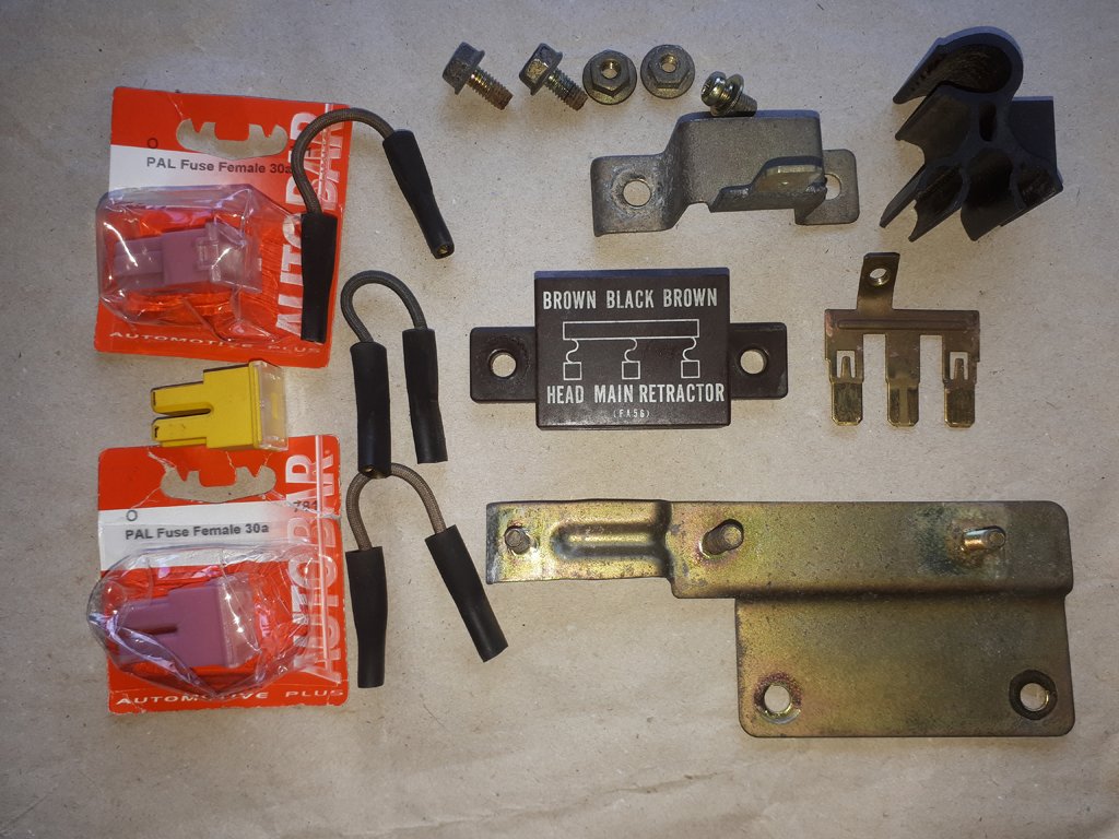

Removed and dismantled:
Fusible Links 2 1024.jpg (182.78 KiB) Viewed 5674 times

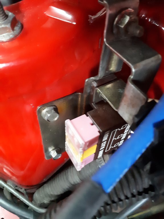

Cleaned up, lacquer applied to metal bracket, PAL fuses (bargain Eurocraparts "end of line" items, about 65p ea)
Fusible Links After 1024.jpg (88.1 KiB) Viewed 5674 times
