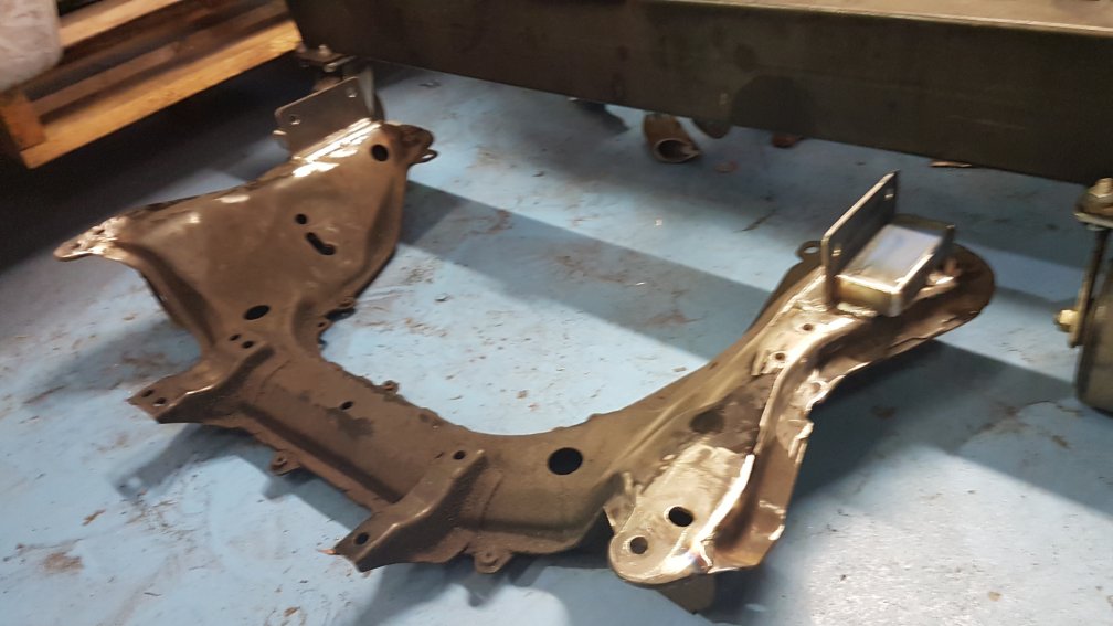

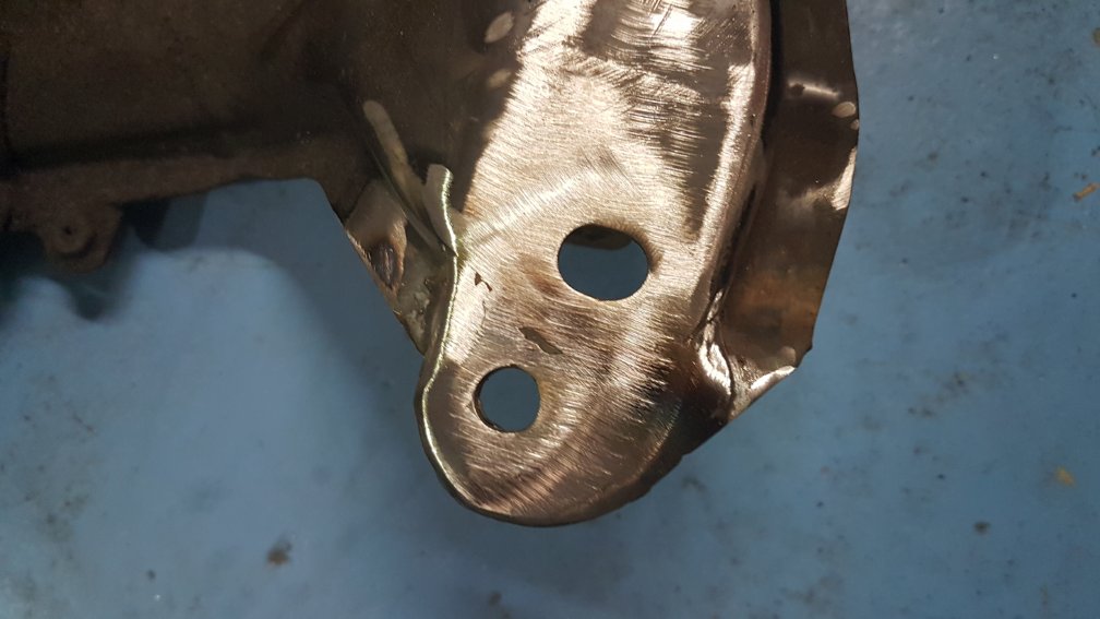

Some more progress. Modifications to the FC subframe are complete. Unlike the write-ups of the FC conversion you'll see on the internet which essentially bolt on the subframe, mine looks like this:
Basically, extra metal has been added to the front chassis attachment points with new bolt holes drilled. This allows the subframe to be bolted to the factory 1st gen crossmember mounting point, but 20mm further back to restore the factory axle centre line. The angle of the mounting face is altered also to allow the rear of the subframe to sit slightly lower (explained further below):

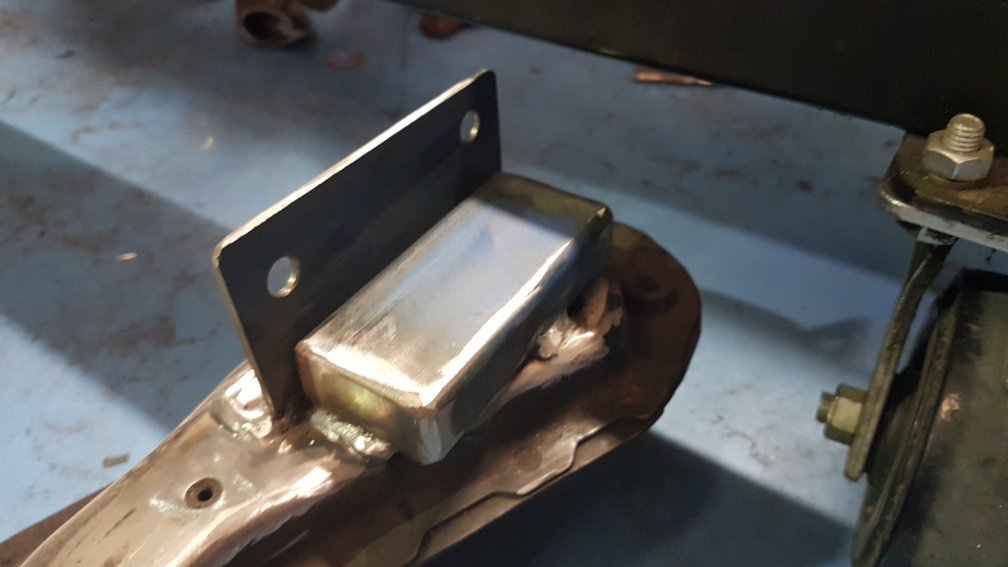

The rear of the crossmember then has 2 new mounts added. These attach to the factory steering box and idler arm pointing points but also tilts the back of the subframe sown slightly. This way, ride height, engine and transmission sit as per factory;

this is awesome.... if it solves most of the alignment issues right from the start it will be a great mod... the only reason i haven't done mine is that no-one seems to have definitely solved the issues the fc subframe swap throws up. This is very cleverly thought out though.

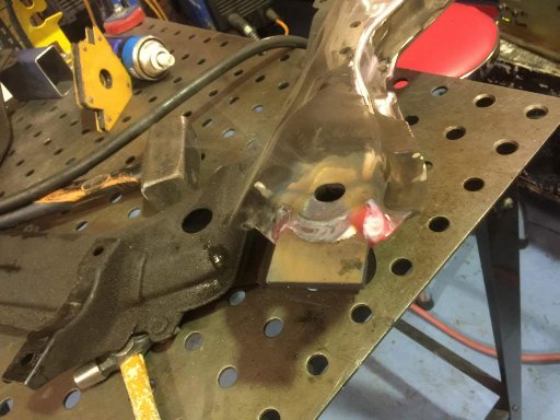

Can you explain a bit more about the front mounting point... I can't quite picture it. I get that the subframe mounts 20mm back to centre the wheel but how have you used the FB front mounting point? Redrilled the front holes on the FC Subframe?

ian65 wrote: Can you explain a bit more about the front mounting point... I can't quite picture it. I get that the subframe mounts 20mm back to centre the wheel but how have you used the FB front mounting point? Redrilled the front holes on the FC Subframe?
No problem. the subframe isn't actually long enough. So, a new section is welded on to the subframe to effectively extend the mounting face further forward:
This newly added section was then shaped and a new hole drilled to end up like the end product i posted earlier.
