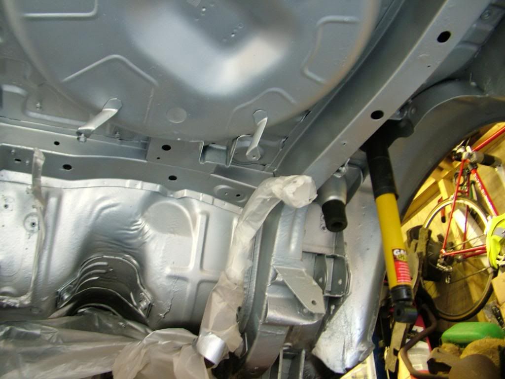

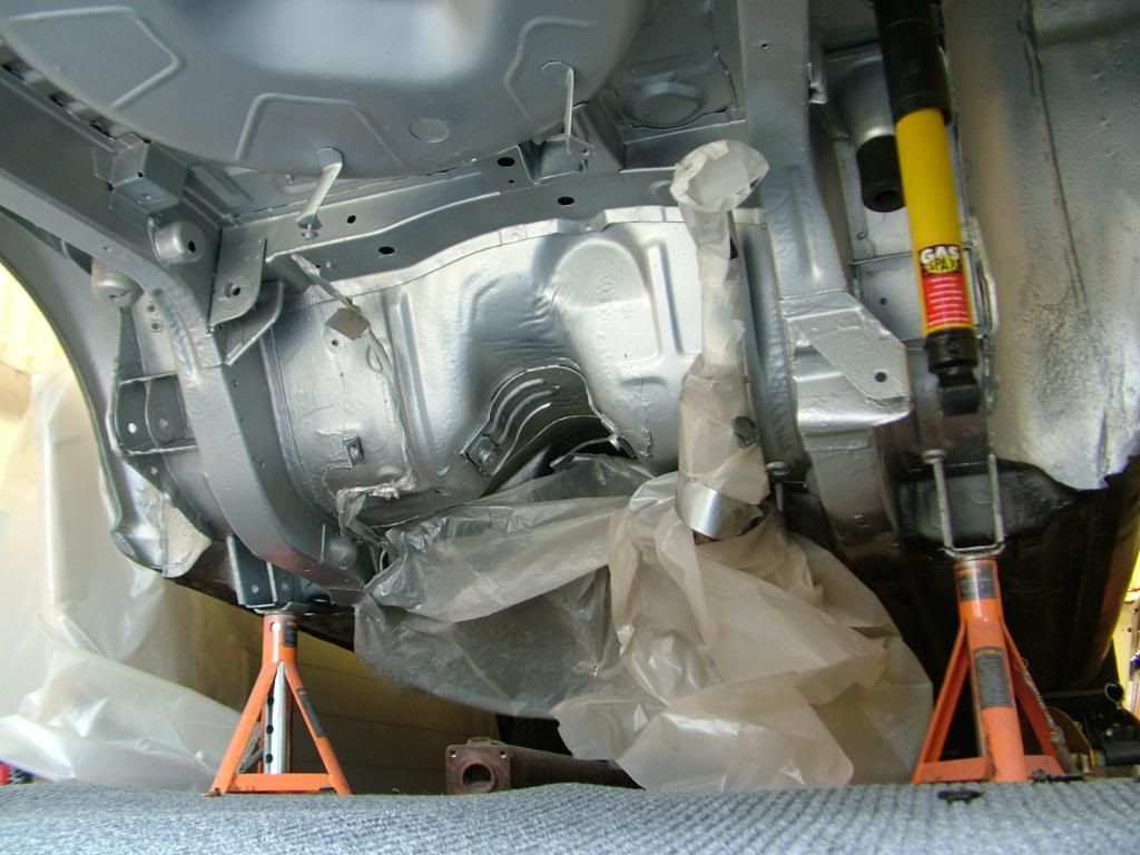

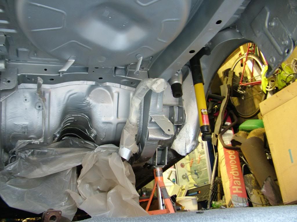

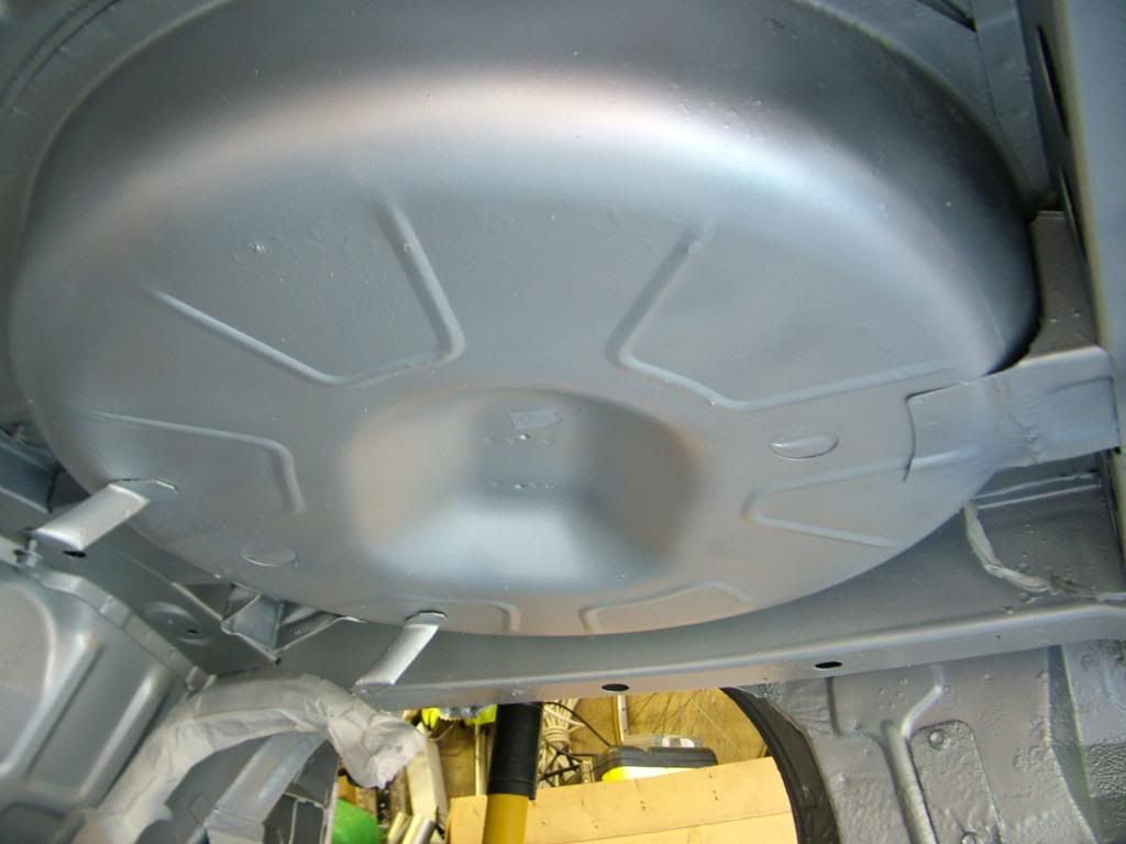

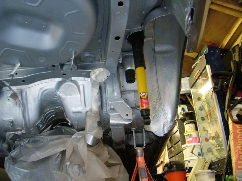

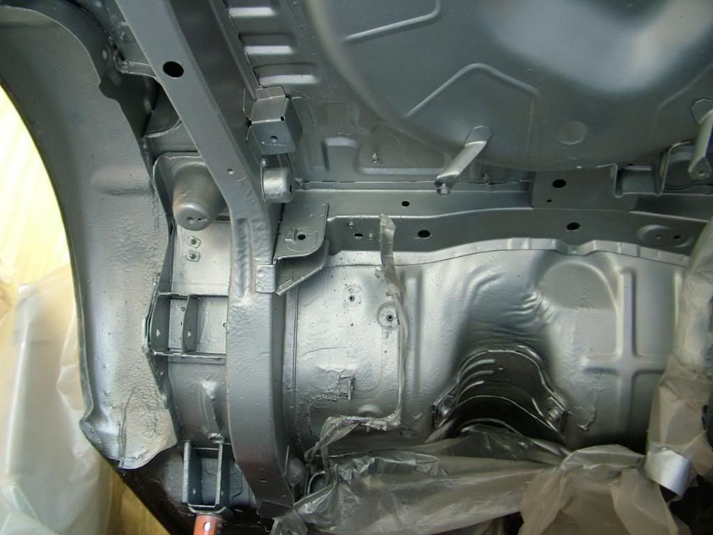

Got the rear underbody of the car complete now to start building it back up again...
The axle, fuel tank and fuel lines are ready to go back on so I should be able to build it back up over the next week or so.
