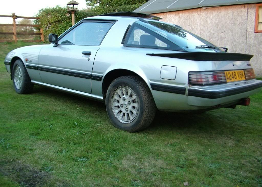

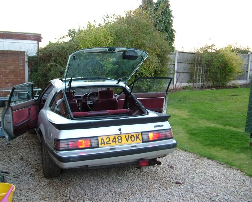

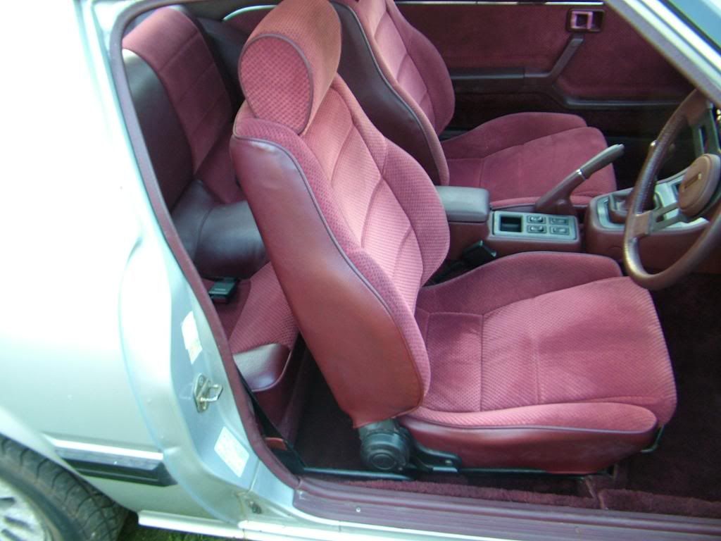

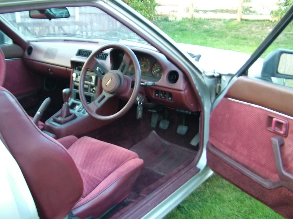

The car is totally original... factory exhaust, air pump, everything. Robert tells me it's never been repaired in any way and has only ever been worked on at his main dealership. The interior is factory original and in wonderful condition, just a touch mildewy in places.... the underside in straight and unmolested with no jacking dents etc although there are a few rust scabs on the outer panels. It looks very smart with its silver coachwork and wine coloured interior.
A bit of love and affection and it'll be a stunner... and is just so original right down to the dealer stickers, everything.

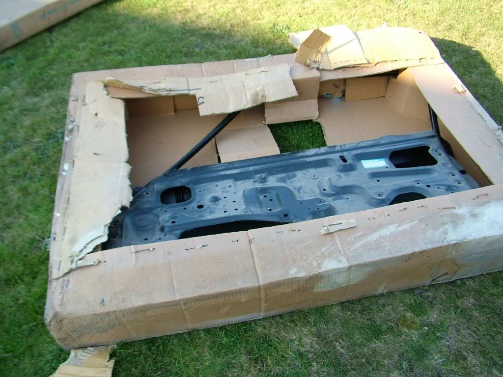

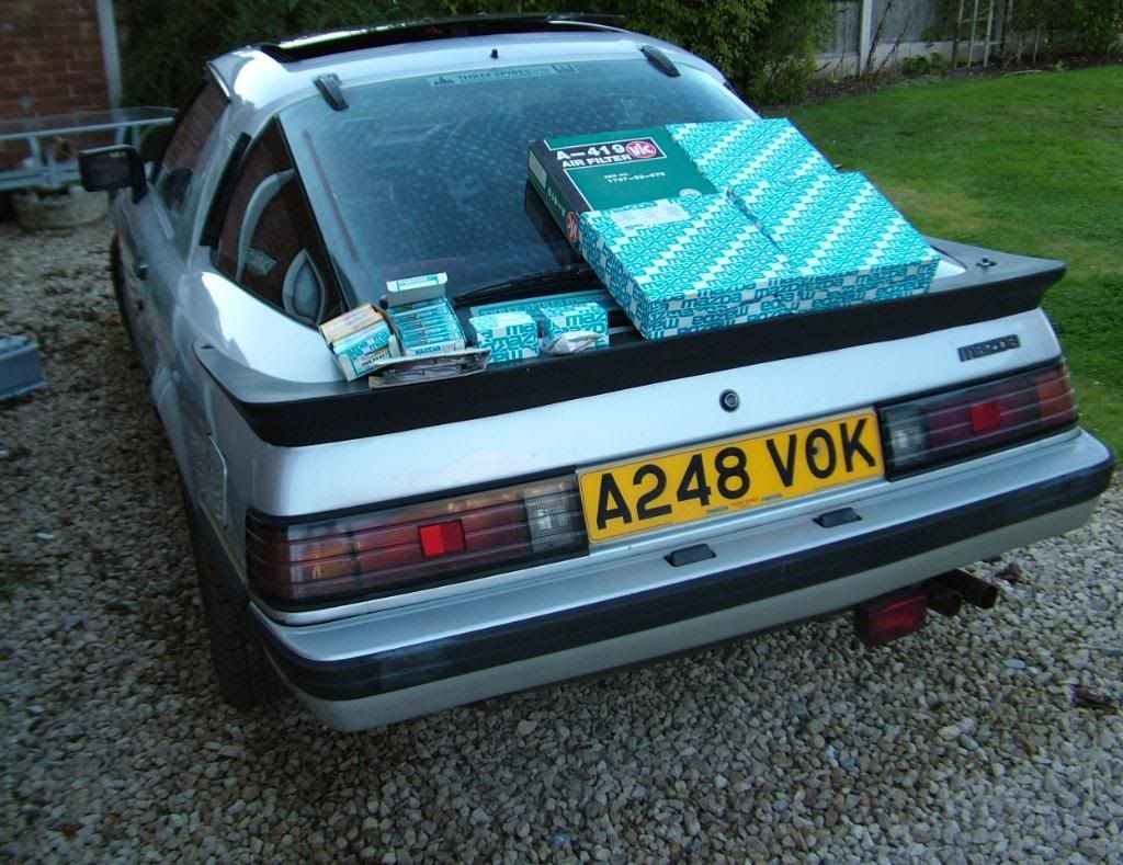

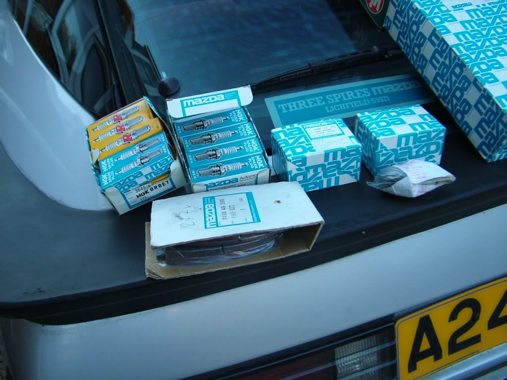

He also had some parts to go with the car..... a new drivers door, still in its box, a glass sunroof, and numerous Mazda service spares that came from the dealership. I bought the sunroof and door off him and he gave me the service parts for free, another great and much appreciated gesture.

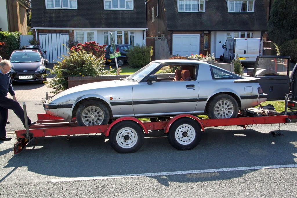

I got the car collected on Wednesday and taken to my house...

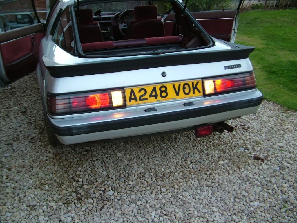

Pics from when I got the car home...

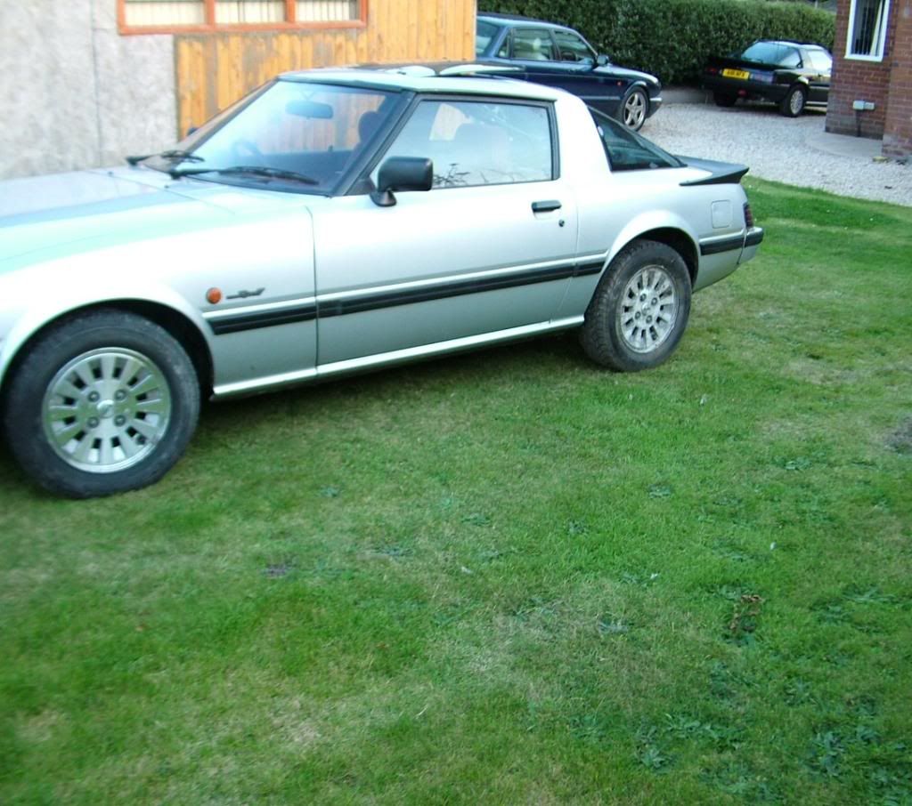

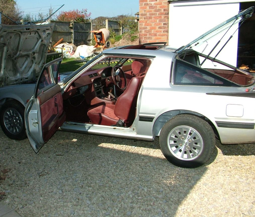

Although the car has been laid up for a long time,this works for it and against it..... it's suffering the usual 1st gen inactivity woes.... sticking brakes, clutch hydraulics, old tyres but the underside... sills, arches, floors are in superb condition .... probably helped by not having to suffer years of salty roads.
The doors etc shut like a new car.... it's got the potential to be a nice car.

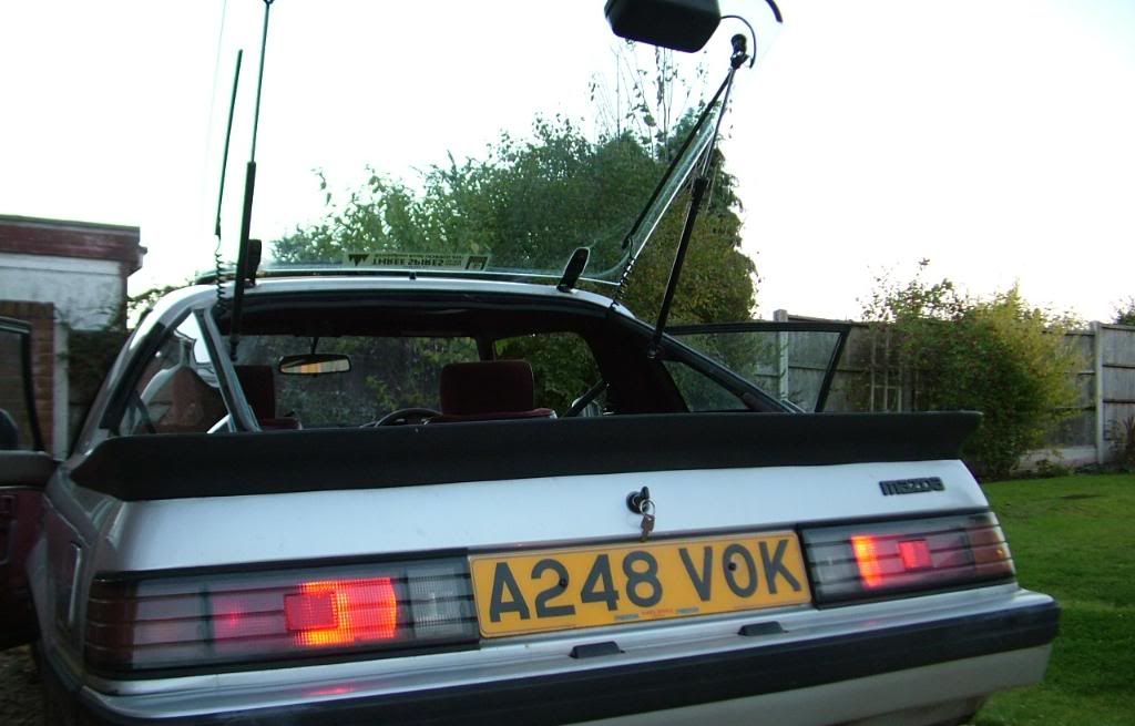

All the electrics work... even the electric aerial! 1st priority is to fire up the engine. Robert filled the rotor chambers with redex when he laid it up so I'll try and smoke the neighbours out Saturday.

Here’s a few of the parts....
Service parts...
The Pacific T-top glass roof ( fitted to the car)...

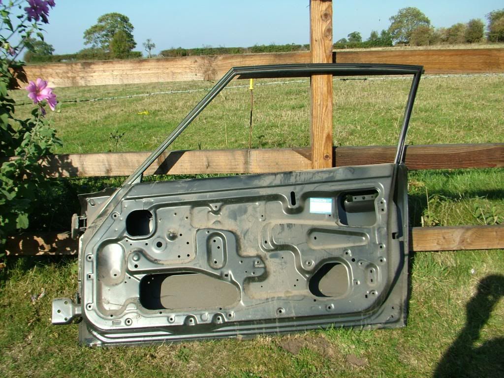

Drivers door NOS...

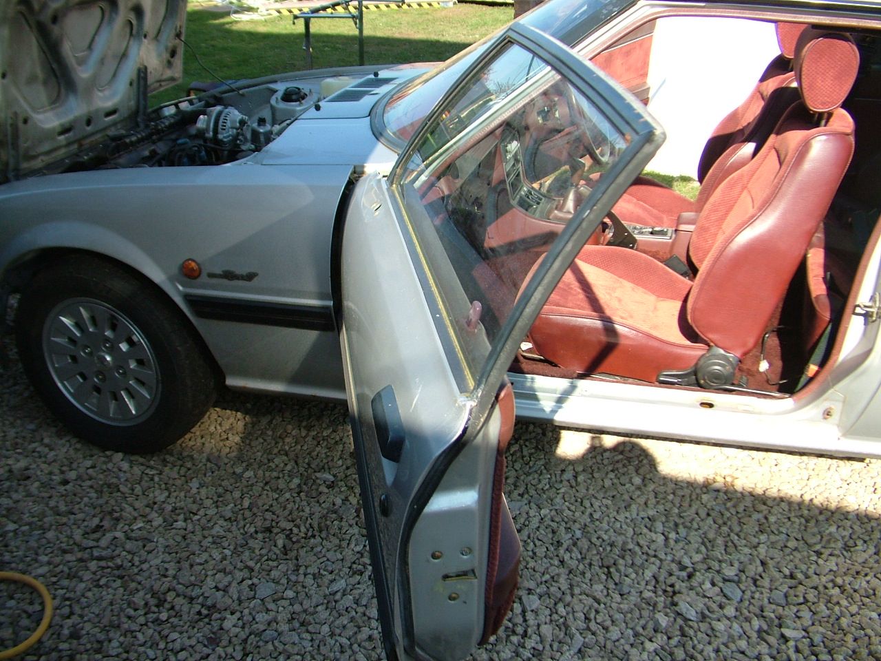

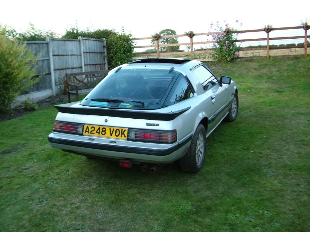

The car does need a repair to the drivers door... someone backed into the existing one but as I’ve got the NOS door that's an easy fix.... not even worth trying to repair the old one... just build up the new door and get it painted.
It's had a new windscreen as well at some point and has developed some rust under the windscreen pillar trims... this seems to be common in cars that have had the screens changed.... maybe the way they seal them in or something..... on a positive, it'll be easier to get the screen out to fix this as replacement screens are easier to remove... the factory bonded screens are a bitch to get out... I can then get National windscreens just up the road to re-bond it for me.

looks a nice series 3, i wonder what the rear bumper is like on the passenger side as seems a bit rusty?

yeah, there are a few rust scabs on the body but nothing major... the shell is ace and that's the important thing.... most rust spots have come from blocked drains and leaks..... this is so solid and clean though it's got the potential to be a show car .... especially given its originality.

but it goes to show the hidden gems knocking about just waiting to be found. that interior is like new.

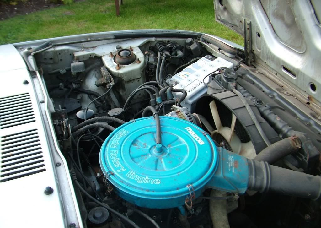

this car hasn't been run for over 15 years so the first job was to see if it would fire up and run.
Redex was put into the engine to protect it when it was laid up in the 90's and the engine turned over ok by hand.

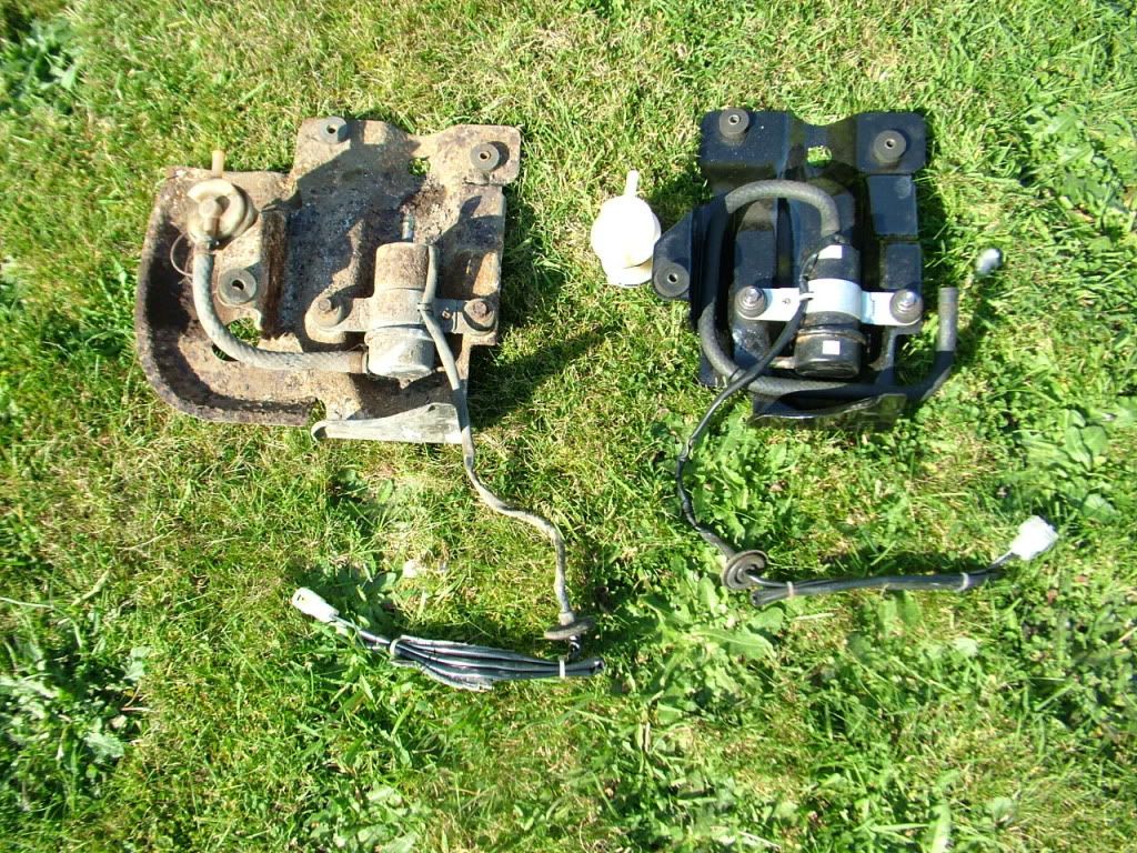

I decided that rather than mess about with the existing Nikki carb that was probably in need of a rebuild due to being gummed up with old fuel, I'd use the good clean Nikki that I took of my black s3 when I turbo'd it last year.
It's an easy 30 minute job to change the carb ..... I left the existing rats nest on the car.

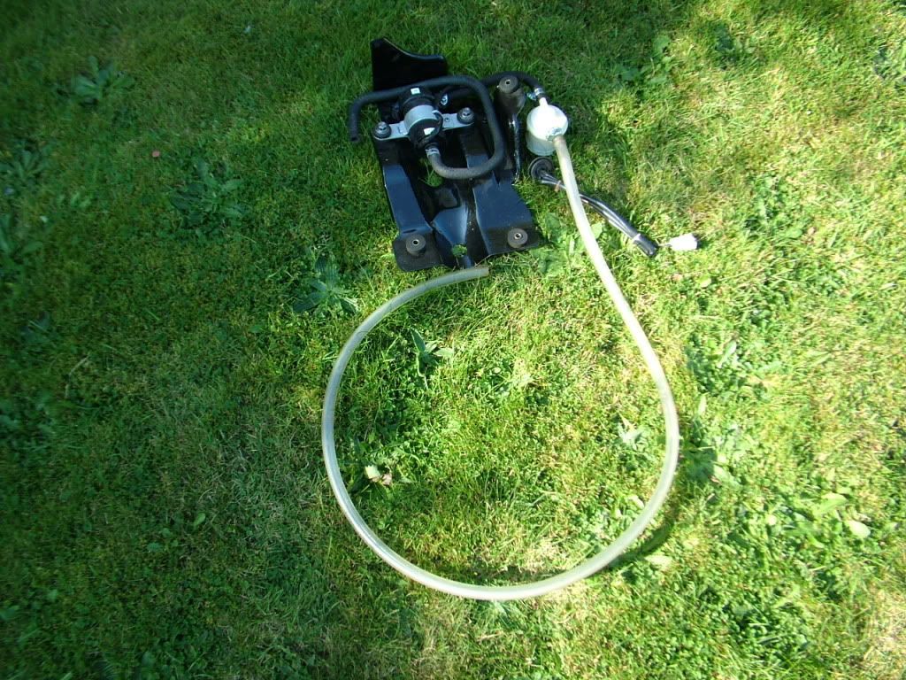

The fuel pump was then taken off the car and I put my own spare pump on in its place and fitted a new fuel filter...
The stale fuel in the old fuel filter smelt like varnish.
I then disconnected the fuel flow and return lines and blew them out with compressed air...
As the carb, lines and pump were then known to be clean and as , at the moment, I don't know how clean or otherwise the tank is, I decided to run some tube from the fuel pump to a petrol can of new unleaded.... that way I could be sure that everything going into the engine was clean....
I then put a spare battery on the car, pulled the plugs out and spun the engine over to blow out any excess redex/ oil. I cleaned up some spare plugs that I had in the garage and put them into the engine.
The engine was then spun over without the fuel pump connected to get the oil pressure up and to make sure it lifted.
I was about to fire it up when Keith called in so he helped me try to start it...
1st try the battery was flat so we jumped it off the wifes Peugeot.... after some spinning to get the fuel through, it fired up and ran great.... we left it running for about 10 mins and most of the redex burnt off.... but when we revved it up, there's some right dust and crap coming out of the exhaust... 15 years of rust, dust, and anything else that's crawled up the exhaust.... it needs a good blast on the road to clear it out.
Here's the video.... the horrible popping and rattling noise is the Peugeot.... she went out this morning and came home with a broken exhaust... another job for tomorrow....
The car ran and ticked over nicely and sounds great.... the redex did its job..... when it got hot and I gave it some stick, the fanbelt started to shred... and surprise surprise, the bloody viscous fan is very stiff so I need to sort that.... also the choke doesn't hold on the magnet maybe a loose wire , or else I'll have to fit one out of my spares cupboard...
All in all, I'm very happy. Next job is to sort the clutch so that the car will move under its own power.
