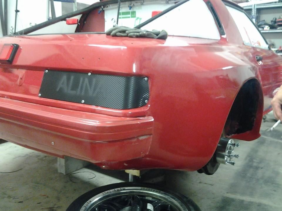

"Rear lights". Bro printed his son and daughter names and painted them on top. Cheap and easy idea and looks good. Notice 51mm spacer...

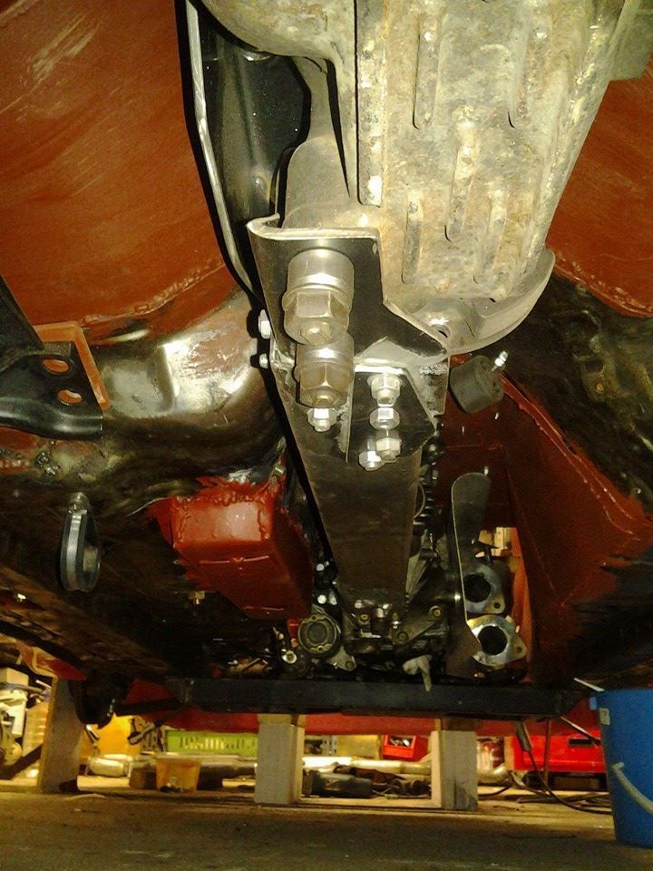

Rear suspension and stuff. Quite ready, needs some paint though...

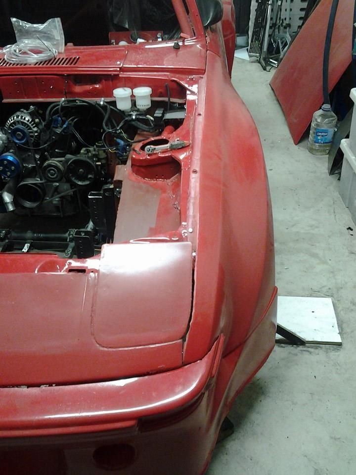

Nose, some big holes and gaps but it doesent matter
It really looks like snowplow or something like that. I think it needs to modified, its to low...
Starting to look like a car. All nose panels needs new paint though...
Bro´s custom made PPF. Its massive and weights alot but it should take lots of beating
