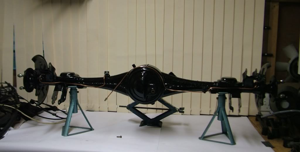

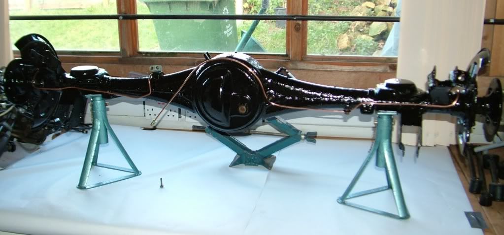

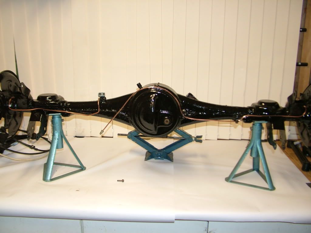

the rear axle now has now been stripped of its surface rust, acid cleaned and given its first coat of POR15.... I used black gloss POR for the first coat but the second coat will be a POR15 in a black satin finish which I prefer as it looks more 'factory'
I've also made up some new copper brake lines to fix to the axle...

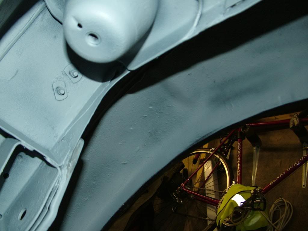

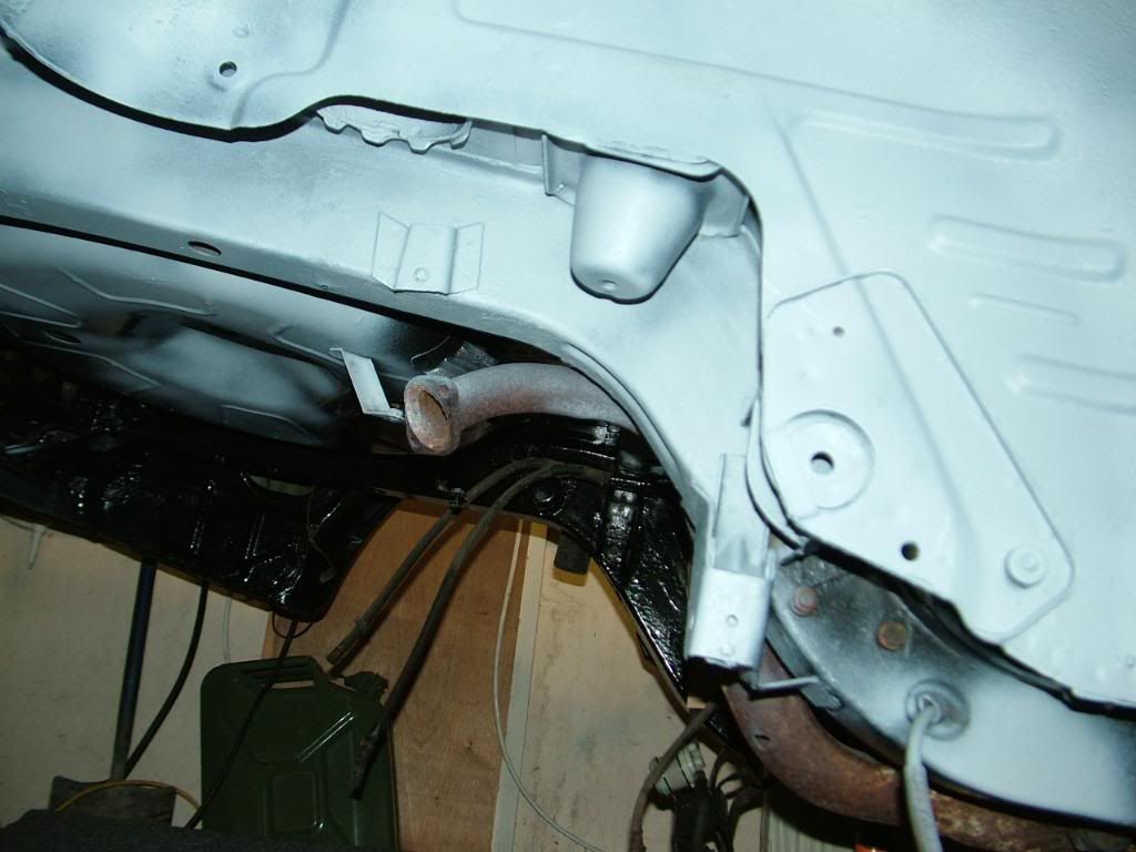

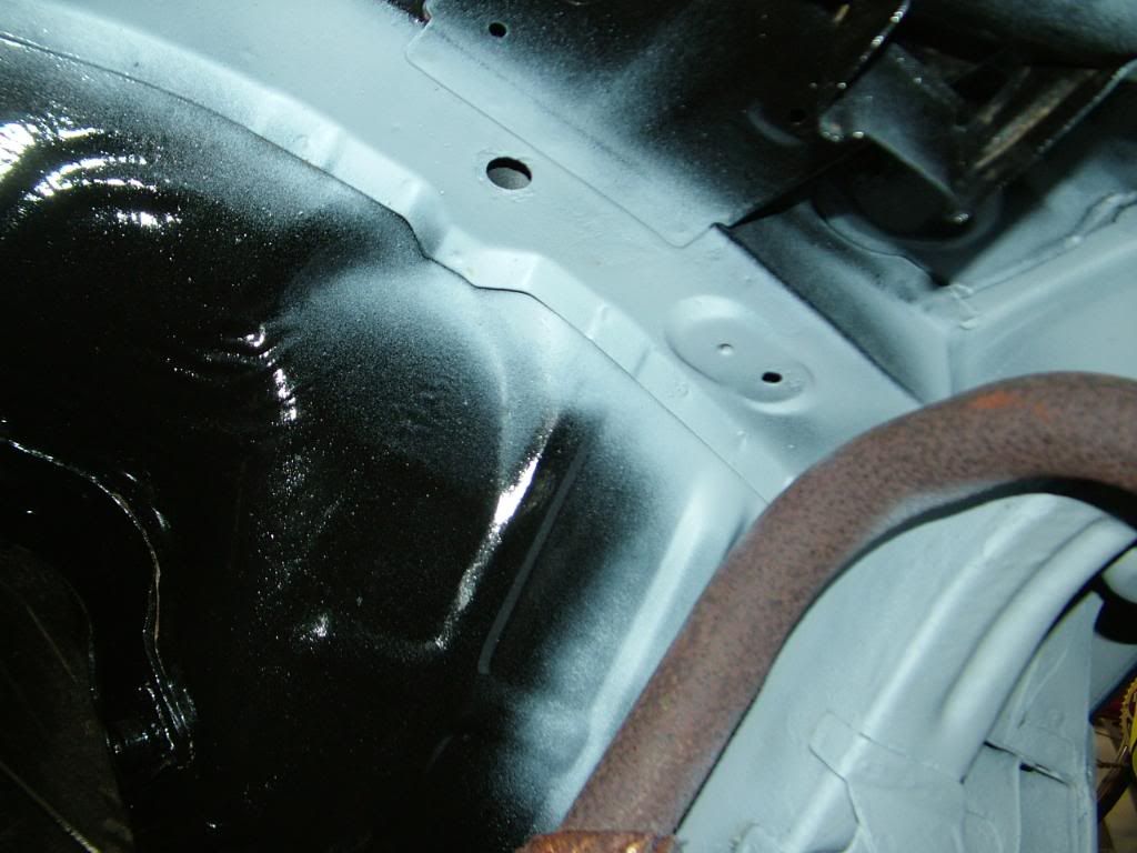

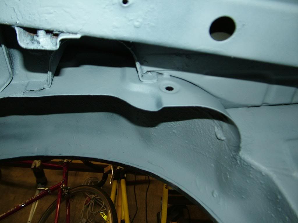

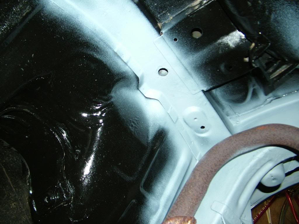

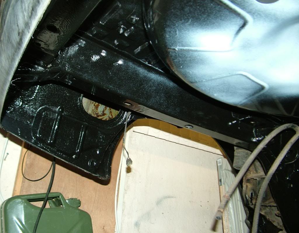

haven't got into the garage much recently due to work and cold weather but managed to spend a few hours last weekend.
The fuel tank has now been cleaned out, and coated externally with a heavy coating of POR15. This is ready now to go back on the car.
Everything underneath the car from the rear seats backwards, has been removed and the underbody thoroughly cleaned, coated with POR15 and then I've started to spray some primer over the top of it prior to topcoating it with K3 sunbeam silver...
Once this is done, I'll re-install the axle, suspension,brakes, tank, heat shields and fuel lines.
Here are a few photos of the work in progress...
Should be better than when it left the factory when the top coat is on.

Nice work there Ian - looks as if you have been extremely lucky with the condition of the underside and how simpler it is with all the relevant suspension/axle/exhaust out of the way, the ease of access. Are you benefiting from the 'Pit' at all?
It'll look good painted in Sunbeam Silver and as you say, be better than when it rolled off the production line all those years ago.
