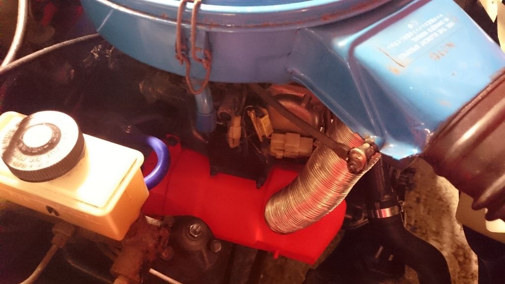

Stuff what I done today ,,, devised a method to fit the bonnet all by myself. Now this might be nothing new to most of you but it was a little victory for me

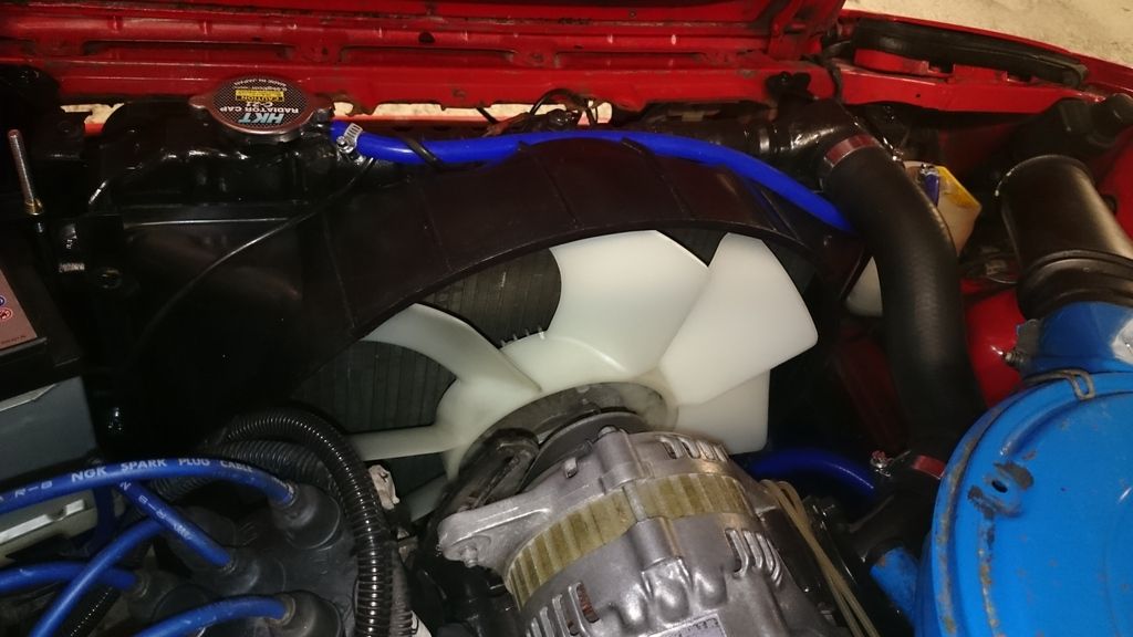

Clean fan is hell a clean. Electric version to follow a some point

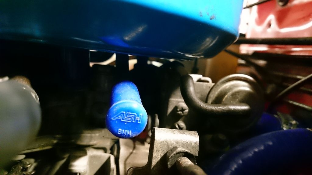

Little details
T'other side perspective

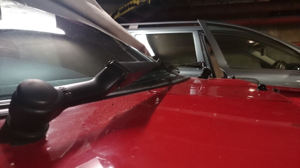

And started on fitting these ... MX5 wiper arms like wot Nik got
The only questionable bit was the replacement crankcase breather. As I've got a good set of long reach sockets now, I selected Mr 21mm and tweaked that a little more plus tightened the hoseclamps on the silicon hose which runs to the filler pipe.
Backed the mixture off a little more and ran the motor at 2000 rpm for a good 15 mins. No discernable glow but hard to tell without proper darkness.
A few bits and pieces to finish off before the next BIG THING which will be the MOT
Little details
