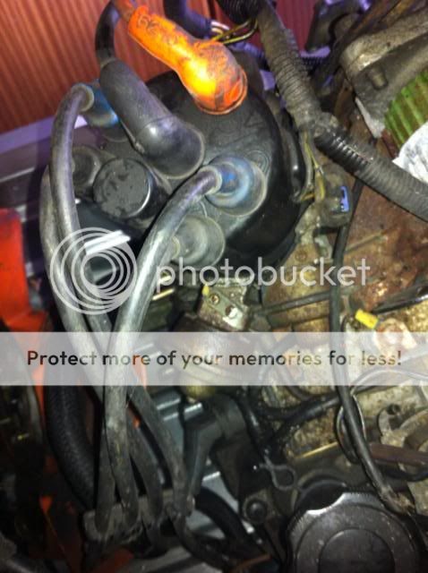

This is a factory JDM 12AT dizzy with the boost retard. It only came out on the S3 12AT motor in Japan.
Do you have on of these or are you talking about the dizzy off your Elford, which will be a regular dizzy?

Tool: FYI the engine in Tim's car is actually a genuine 12aT with Elford externals if that wasn't clear, so the Dizzy could be the standard one from the 12aT seeing as they were both electro mechanical. I would suspect it is a stock NA/Elford type - but certainly could be either.
Re: Roxy
Must have missed that. Where's the pics?
