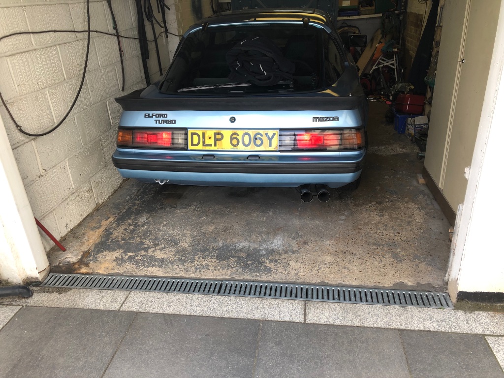

Spent this morning fixing the horn button and the washer pump, I reckon she is ready for the mot now.
Thanks to my daughter for the new Elford badges, far nicer than the clunky chrome ones ( my opinion lol )

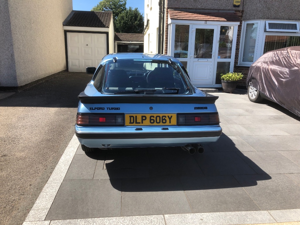

BTW, the more eagle eyed of you may have noticed, that it no longer has the “housebrick” fog lamp 😁
I replaced the outer bulb holders with twin filament stop/tail type, and moved the fog lights to the inner ones.
Looks so much cleaner to me 👍.

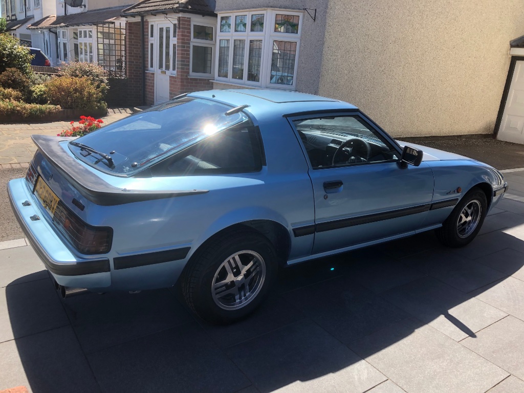

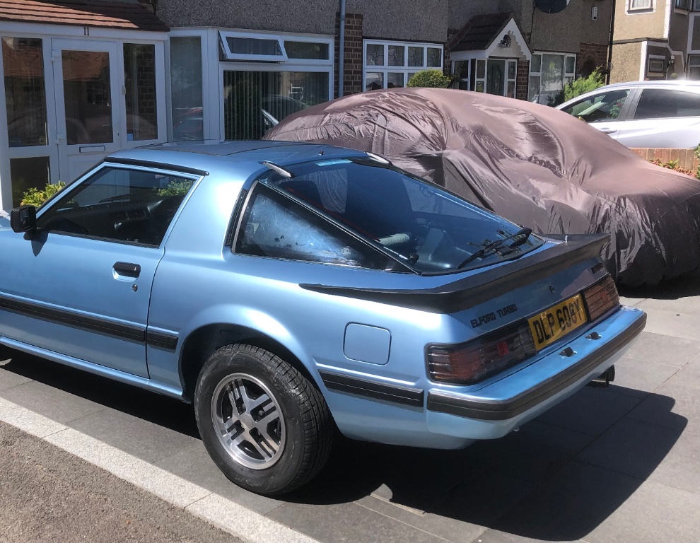

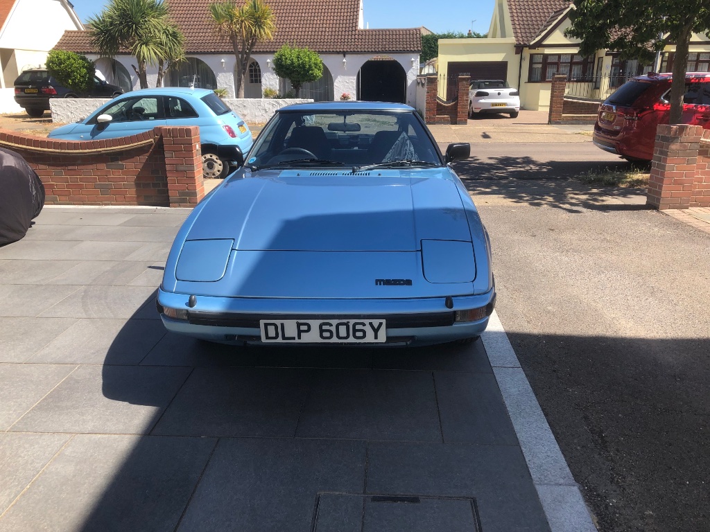

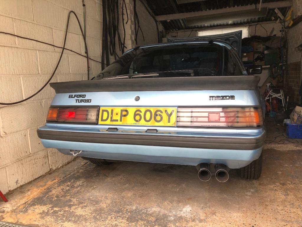

Quick update, been flatting and polishing the car and annoyingly have a few shading issues with some of the panels, only to be expected I suppose, due to me having to paint the car in pieces as not enough room in the garage to hit it in one go,
I have decided to get it mot’d and run it around a bit for this year while the weather holds out,
Have attached a couple of pictures so you can see what it looks like 👍.

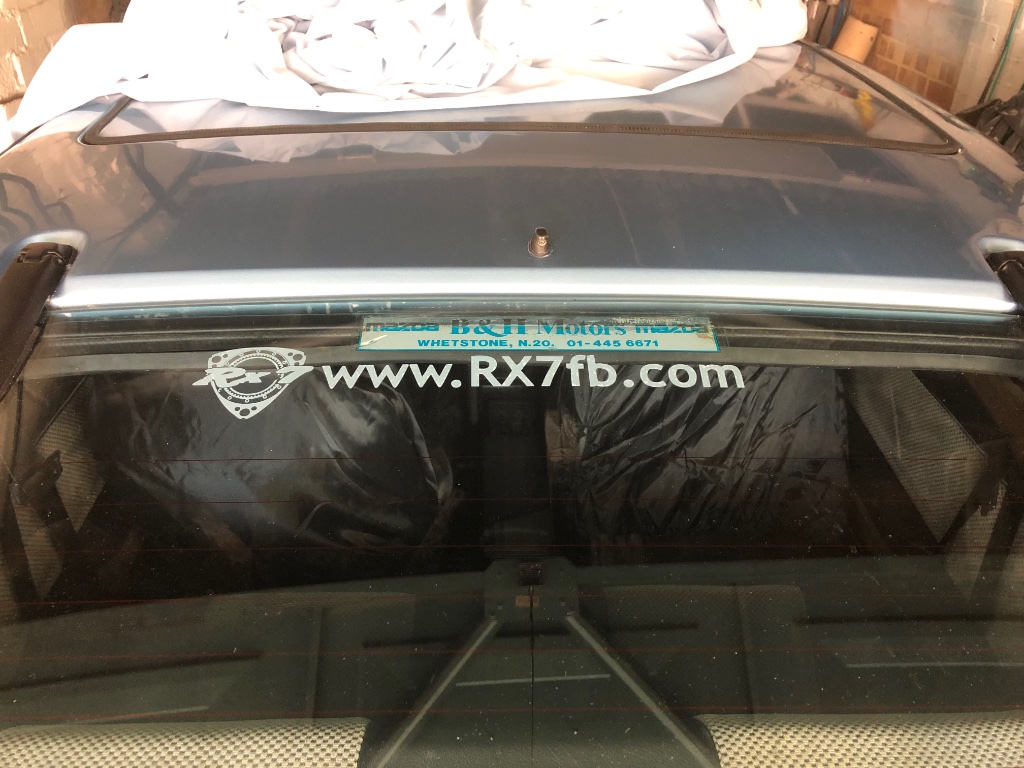

My daughter left her vinyl cutting machine at ours for the weekend, sooo….
I think it’s ok for a first attempt.
