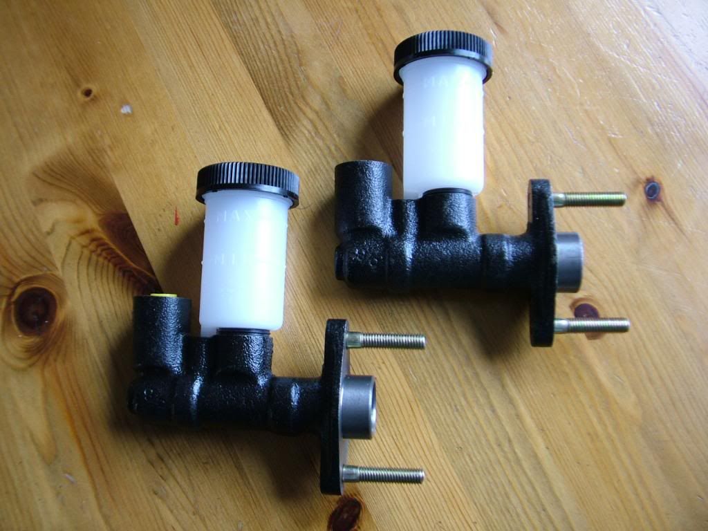

as the clutch hydraulics went on my black Elford, I needed to order a master cylinder from Rockauto..... the parts are unbelievably cheap but the shipping is the bit that costs so I decided to order 2 masters, to be shipped together and put a new one on each car...
I've now put a new master cylinder and slave on this car and have got a clutch pedal! Great!

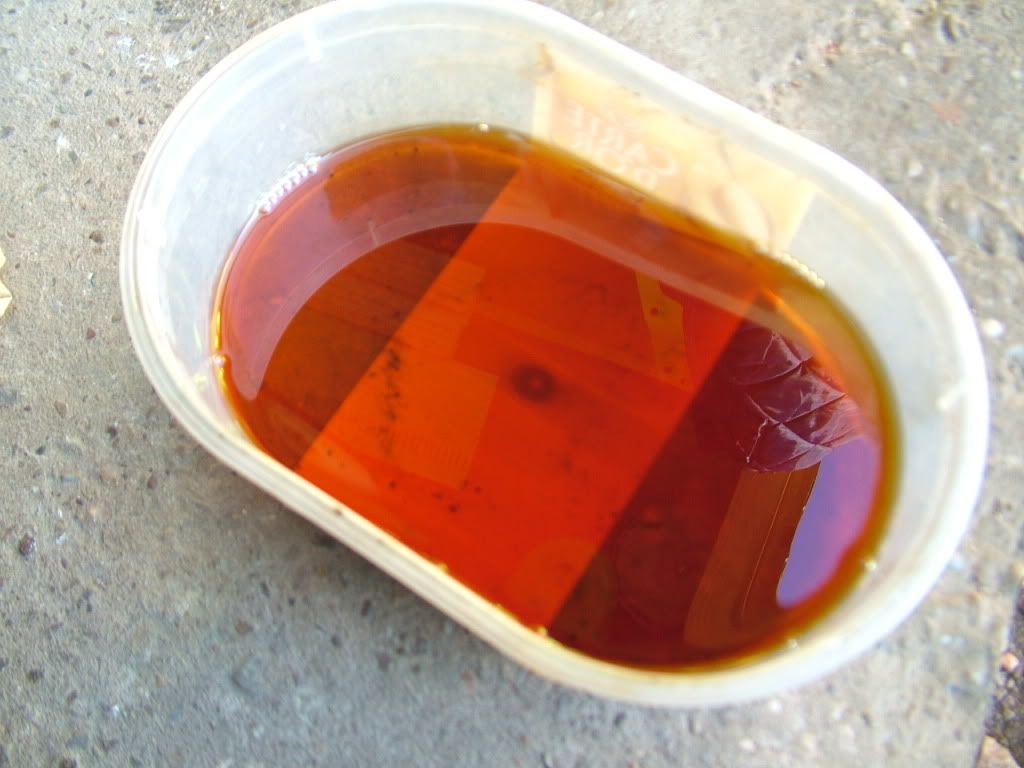

took the drain plug out of the fuel tank today and drained off the remaining 16 year old fuel.... I also wanted to see if much rust came out of the tank...
There was only about a litre of stale fuel in there, it looked like vinegar and smelt like thinners.... horrible.
No rust came out though... the bits in the bottom of the tub were already in there.

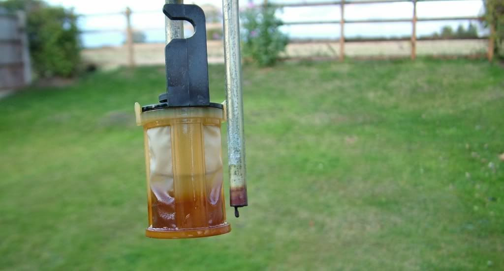

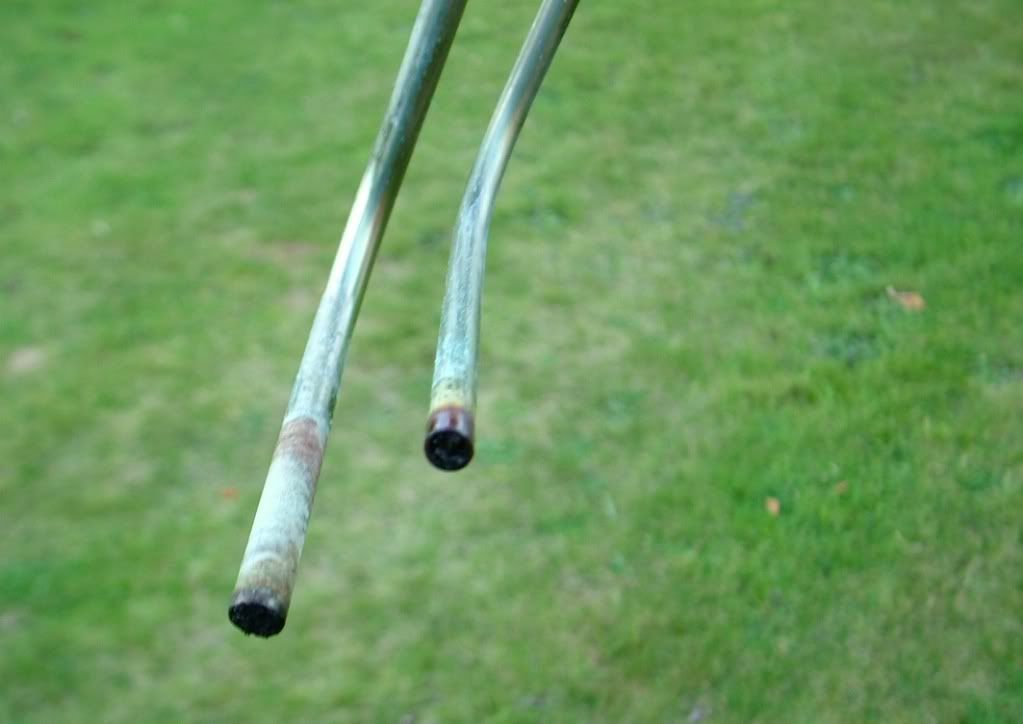

dropped the tank on this car today and took the pickup and return pipes out of it. This revealed the cause of my fuel starvation issue.... pulled the strainer off the pickup and found that both the pickup and return pipes were clogged solid with thick brown tar about 3" up the tubes......... I suppose it was petrol 15 years ago. I cleaned it out with a long drill bit and some brake cleaner then blew them through with the airline..... should be good to go now. The strainer is a bit discoloured but will clean up.

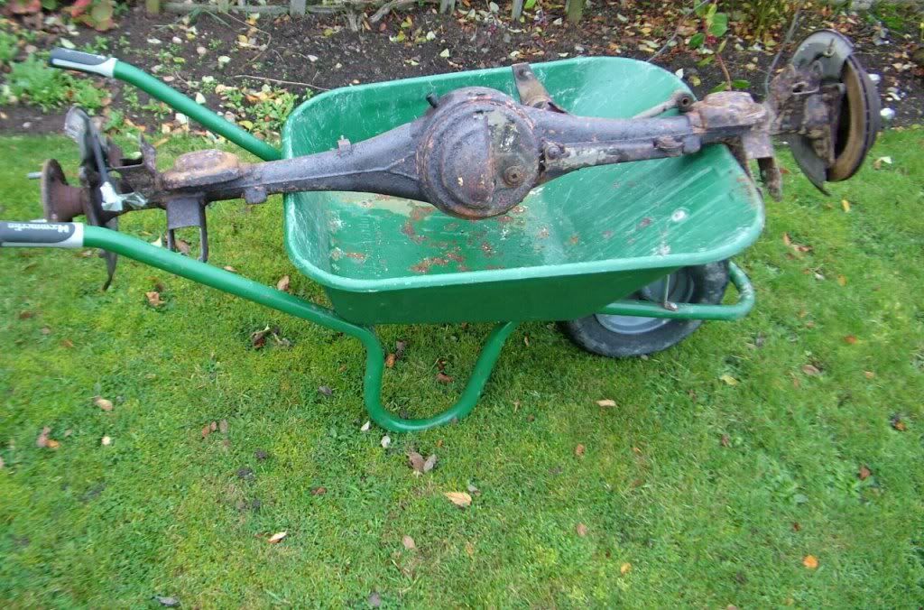

While I’d got the petrol tank off the car, I thought I may as well strip the rear suspension of it and refurb it..... the link arms were ok but the axle itself had a lot of surface rust and as the bushes are 27 years old, it’s worth replacing them to restore the handling and ride...
Getting the axle off was a real struggle... the trailing arm mounting bolts were unbelievably tight... I had to get a 4ft bar to release them which was difficult in itself as there isn’t much room under the car to get any leverage. The nuts are in such a position that I couldn’t get the buzz gun on them.
One bolt sheared off and I had to get plenty of heat on them to free them off.
Some of the arms had corroded themselves to the sleeves inside the bushes and took some moving and the watt link pivot was completely seized. The car would have handled like a broken shopping trolley with the suspension parts seized like this and without stripping it down, I don’t know how I would have detected these problems.
2 hours later it was finally off....

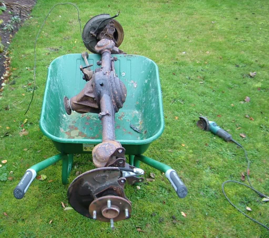

If getting the axle off the car was difficult, cleaning the rust off it was the stuff of nightmares..... 3 hours with the wire brush on the angle grinder....loads of bloody fiddly bits to get into...... glad it’s all done.
