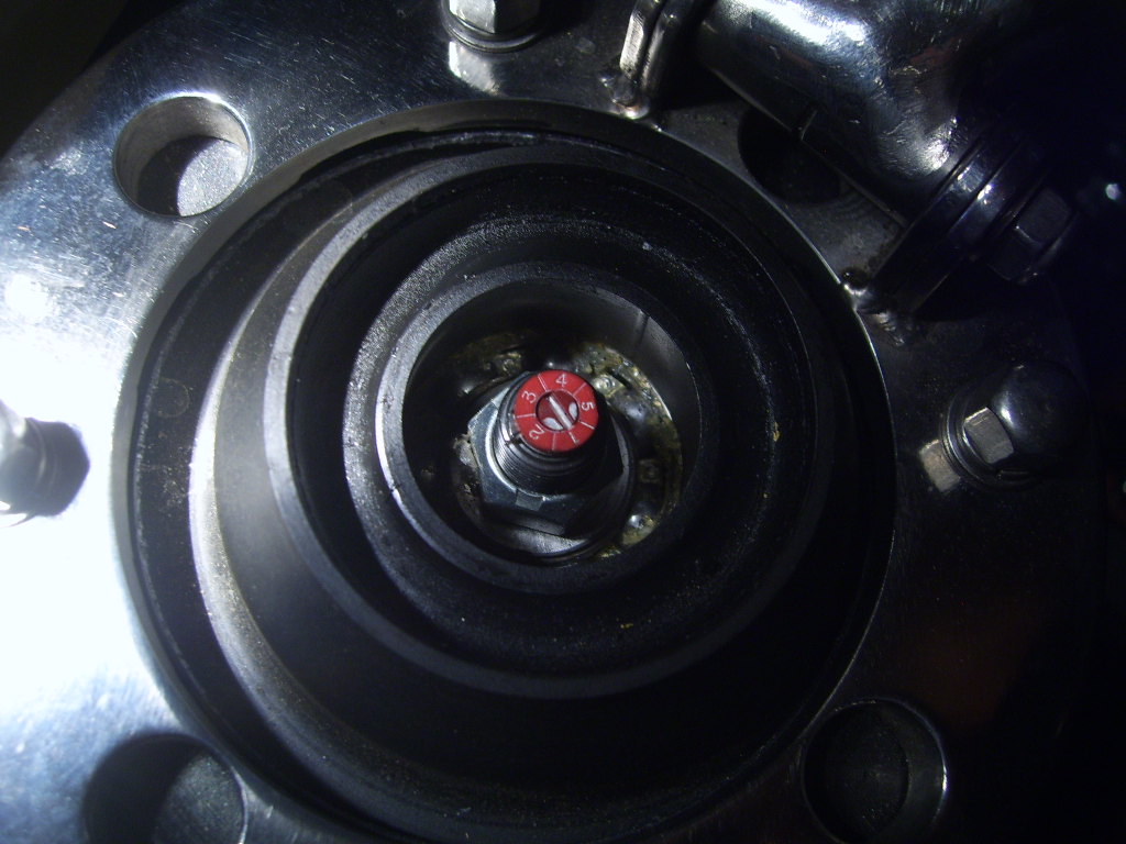

I got my new Tokico Illumina in the mail the other day. (Thank you Amazon!)
When I removed the LF strut I realized the blown one had been leaking shock oil over everything so badly that a complete strut teardown and rebuild was in order. I also noticed my ball joints were shot so I ordered new ones as well as aftermarket camber bolts in the mail.
After rebuilding the struts and packing the wheel bearings with fresh synthetic racing grease I'm finally getting around to installing the Energy Suspension bushings in the front end. I bead-blasted the lower control arms and strut rods to clean em up before freshly painting them. Why I decided to paint them white I cannot say. Probably not practical...

Got the ball joints in the mail today so I assembled and installed the suspension back on the car with the energy suspension bushings and replacement Tokico Illumina.
Drives better now of course that there's no blown shock in the front end! Doesn't even feel like it needs much adjustment in the way of alignment either which is a great sign for an old car with new bushings.

spirit r wrote:Tokico Illumina with Eibach spring my position is one and the car drive great.
What´s your adjustment on Tokico Illumina? (with racing beat spring???)
Hmm well the Racing Beat Springs are about 20% firmer than stock or 145lb/in front and 112 lb/in rear with a modest 1" drop. I use setting 3 which feels like the closest match with damping for the slightly stiffer springs. Which Eibach's are you using exactly? In the states we usually have either their PROkit, Sportline, or possibly their racing springs if you buy them through Ground Control. Each of those have different spring rates.
