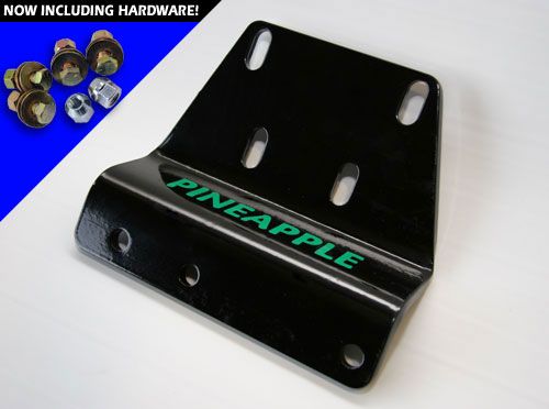

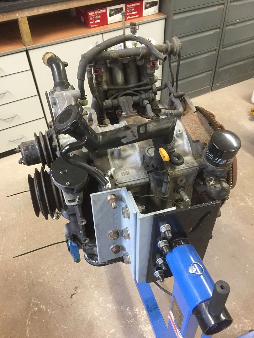

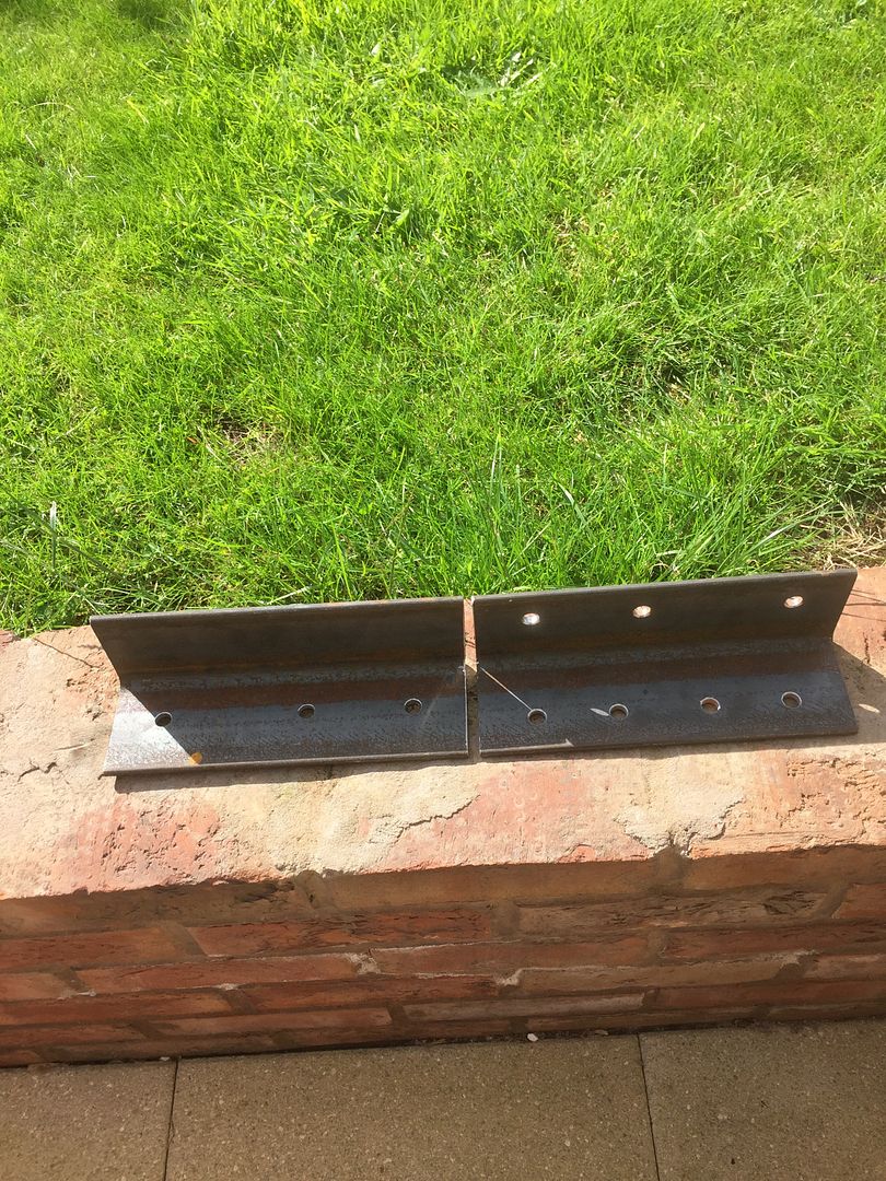

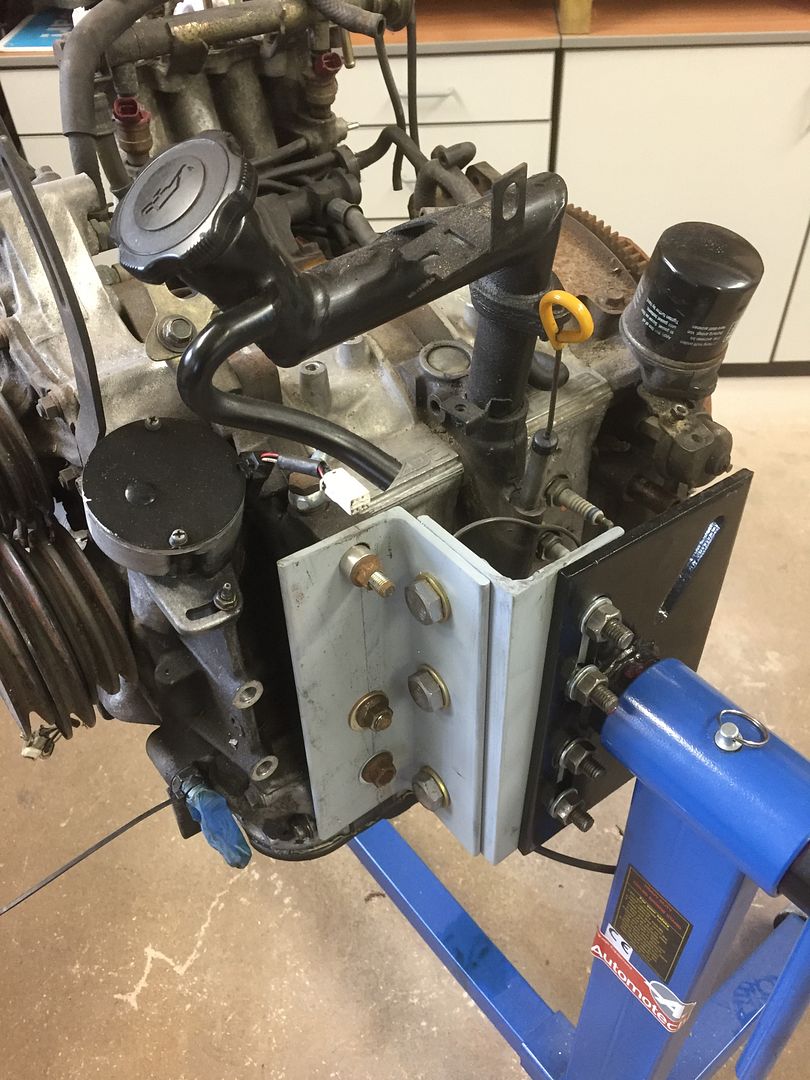

Last year I bought an engine stand to help me work on this TII engine..... the stand was a bargain at only £32 new from Automotec, the place I got my 2 post lift and engine hoist from and the quality is spot on.... mounting a rotary a bit more of a challenge though.
I wanted to side mount the engine and Pineapple in the US make an adapter plate specifically to mount a rotary engine...
without the adapter plate the engine isn't centered on the stand and is impossible to spin over safely...
the adapter shifts the centre of gravity to enable the stand to spin the engine block over.
Now, the Pineapple item is a nice looking thing and I would like one very much..... but, they weigh loads and by the time I'd paid the purchase price, shipping, duty, vat, and anyone else who decided to have a cut, I couldn't justify the cost so decided to set to work in the mancave and cunningly fashion my own.
I bought a 600mm long piece of mild steel angle 75 x 75 x 6mm, cut it in half and drilled some holes in it...
then gave them a coat of zinc primer and bolted them together with M16 Bolts. It now fits both the stand and the engine and works a treat...
makes spinning the engine over a piece of cake...
I can now get on with sorting this engine to go into my FB.... it'll need to come off the stand to change the front cover but it's only 3 bolts to undo it.... happy days

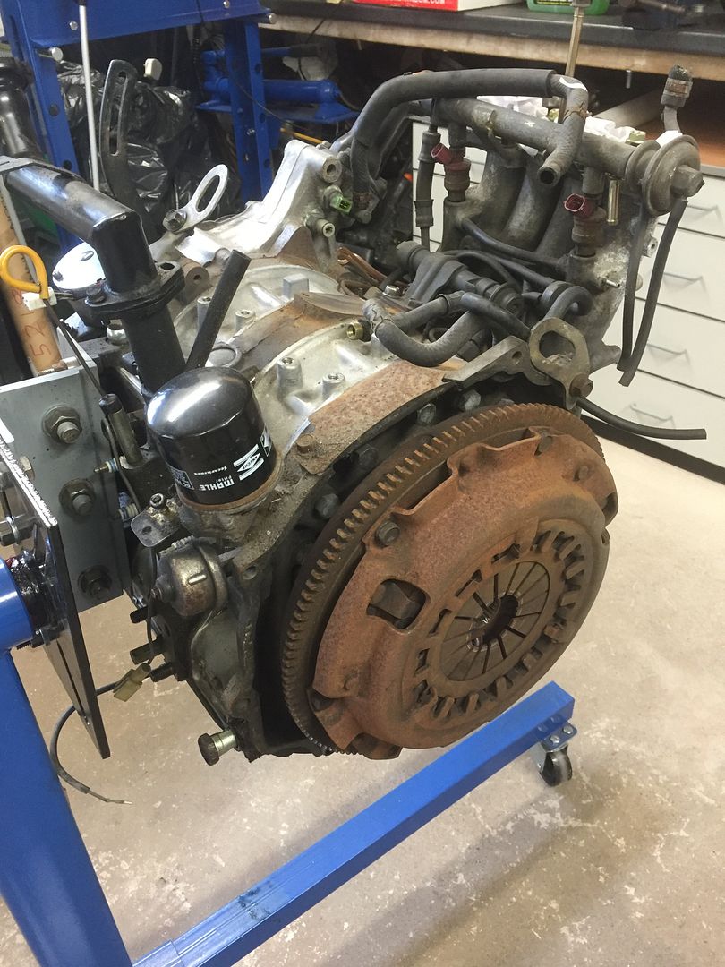

making use of my new super twizzler, I took the clutch off to check it and the fly..... the clutch pressure plate has lots of surface rust...
but is otherwise in excellent condition and doesn't look as if it's had much use. The clutch plate also looks nearly new...
and the surface of the fly is also fine...
I don't know what to do about the clutch I don't really want to buy a new one when this one looks hardly used but what to do about the rust.... could i just rub it down and spray it with cold galvanising or should I just bin it and buy a new pressure plate? Any thoughts?
  I don't really want to buy a new one when this one looks hardly used but what to do about the rust.... could i just rub it down and spray it with cold galvanising or should I just bin it and buy a new pressure plate? Any thoughts?.

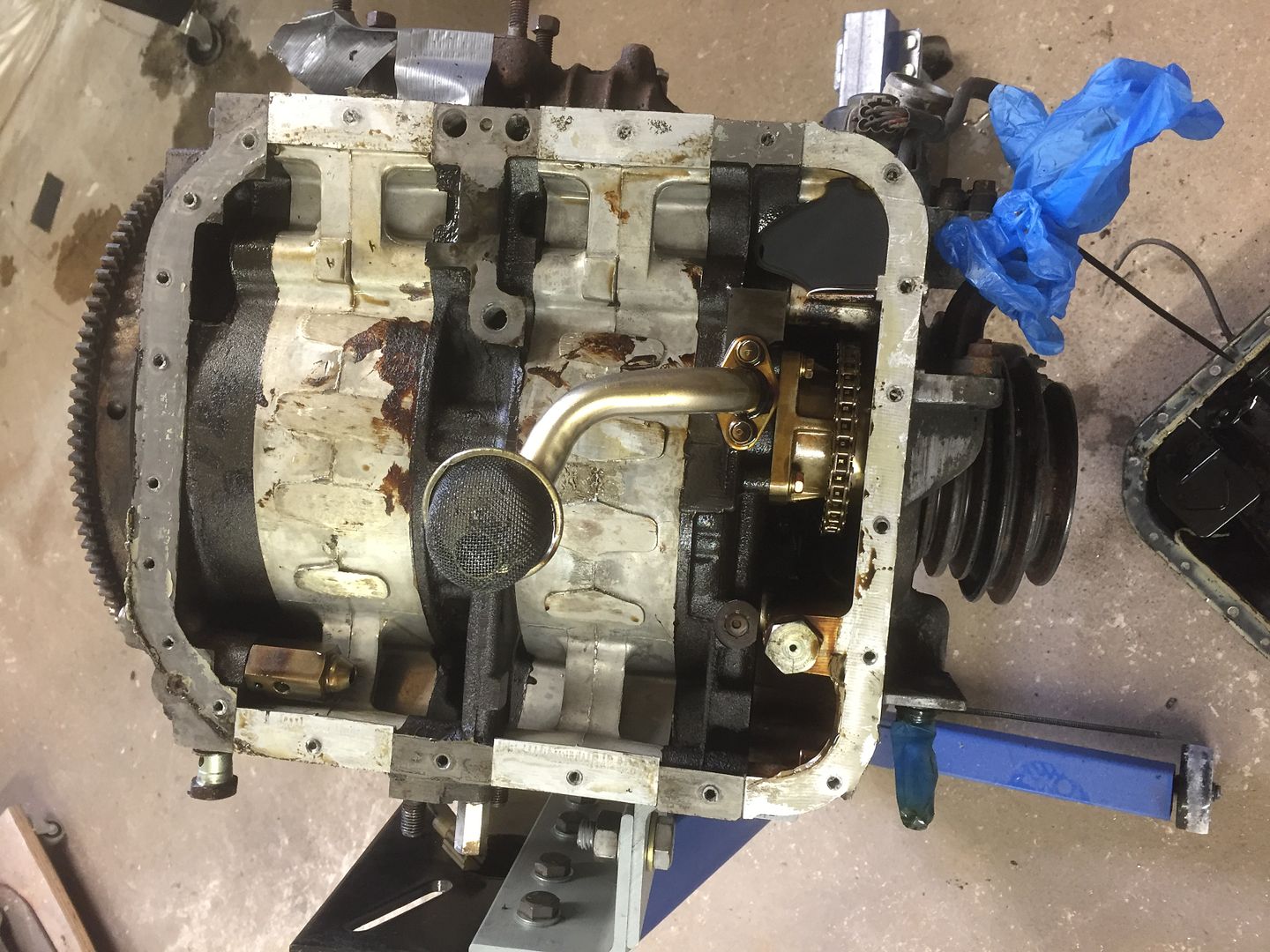

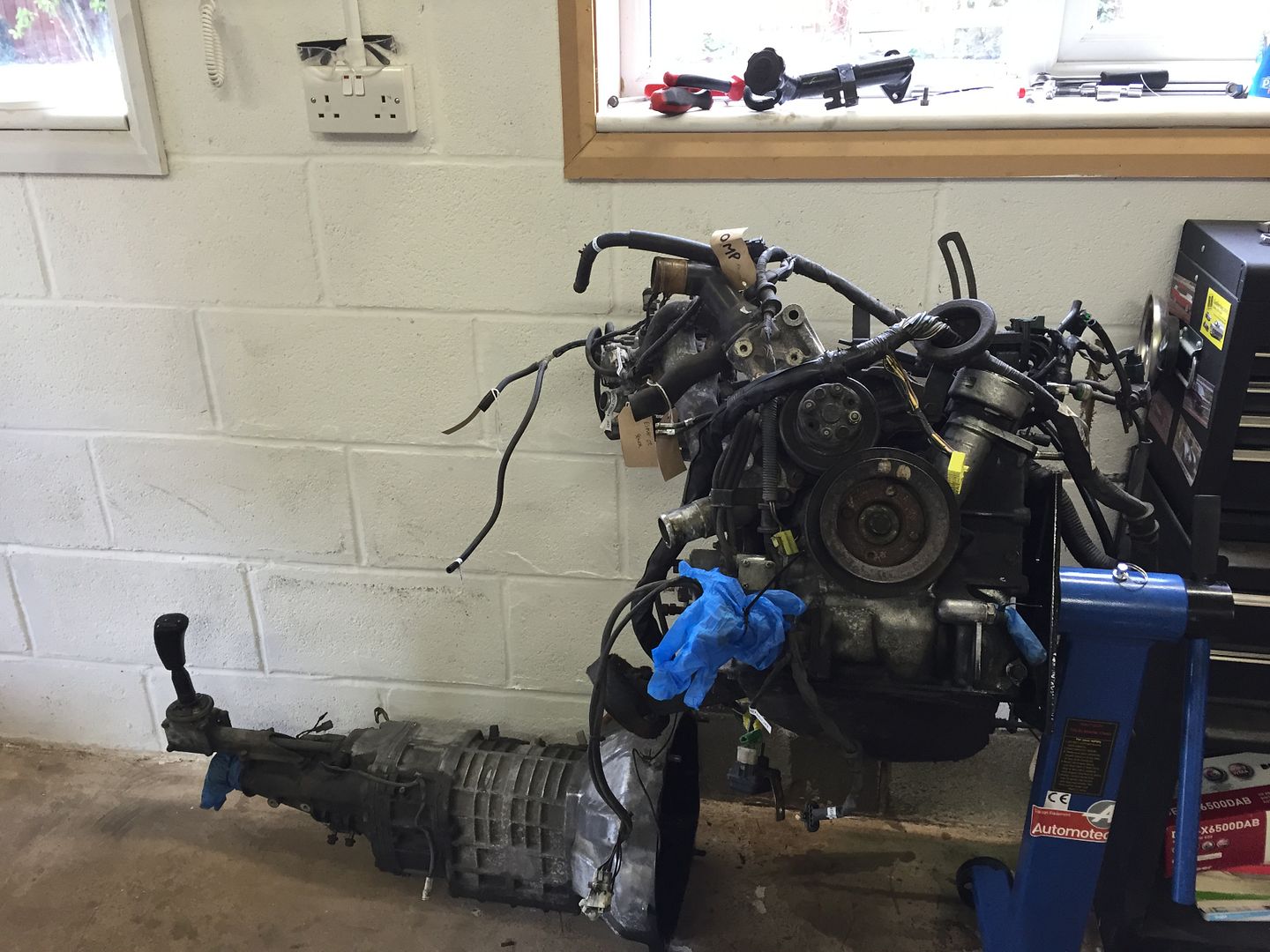

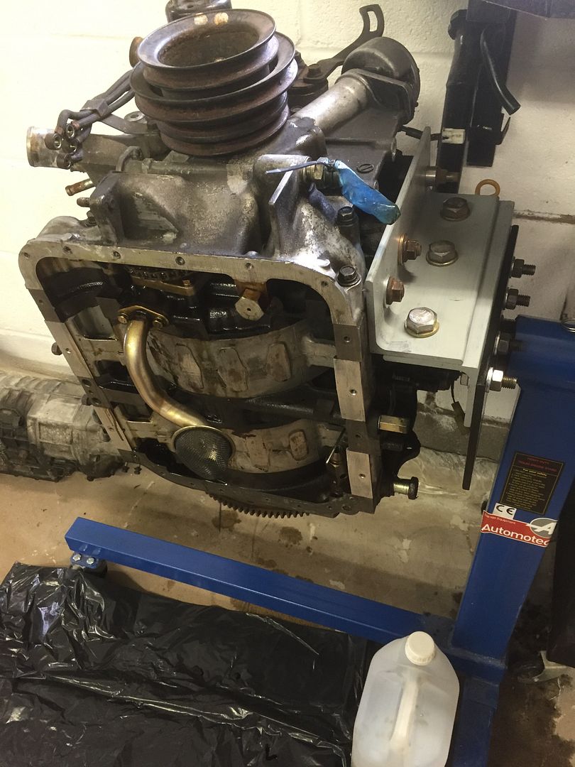

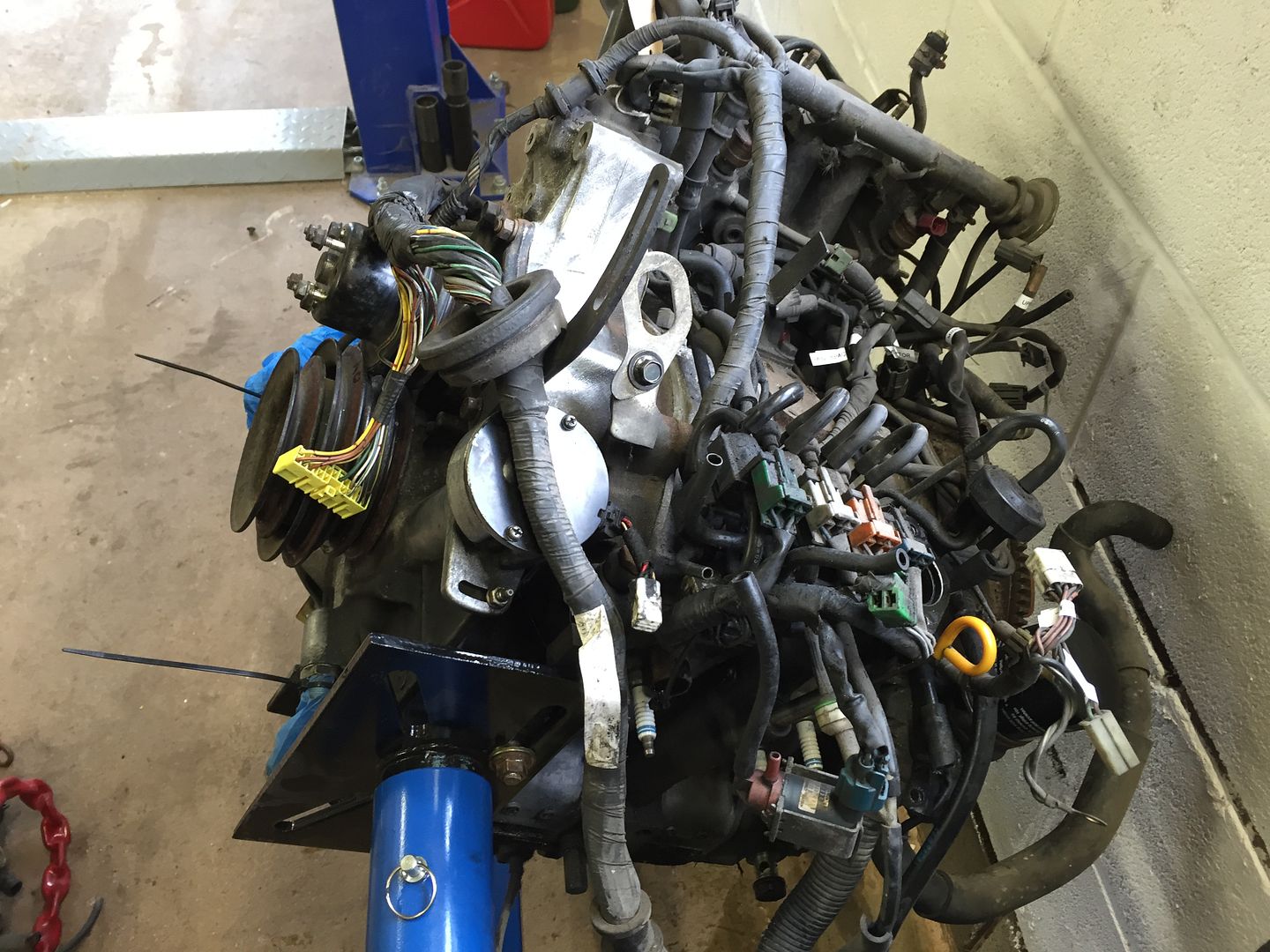

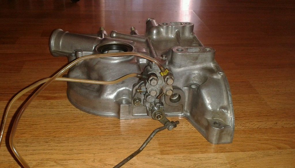

Next to go was the engine mount and the sump...
followed by the electric oil metering pump...
Pip has got a new GSL_SE sump on order for me from the States and I've already got the front cover so I need to get a front cover gasket now and I can swap the covers.

Great job on the adapter bracket.ian65 wrote:
I don't know what to do about the clutchI don't really want to buy a new one when this one looks hardly used but what to do about the rust.... could i just rub it down and spray it with cold galvanising or should I just bin it and buy a new pressure plate? Any thoughts?
Regarding the surface rust , I would remove rust with a wire brush & then apply some of this stuff,
http://www.ebay.co.uk/itm/HAMMERITE-KUR ... SwxH1T9MqV
Works wonders on Calipers/Drums & any other surface rust, goes on like milk but turns black & forms a hard surface.
I use it on all sorts of external parts & farm machinery etc.
- Been thanked: 24 times
Just rub the flywheel and pressure plate with a but of emery cloth.ian65 wrote:could i just rub it down and spray it with cold galvanising or should I just bin it and buy a new pressure plate? Any thoughts?
Surface rust will never be seen in the bell housing and won't affect performance.
If it fails later it'll be an easy job with a 2 post.
Check to see if it's an up rated unit too. What's the thickness of the diaphragm fingers?

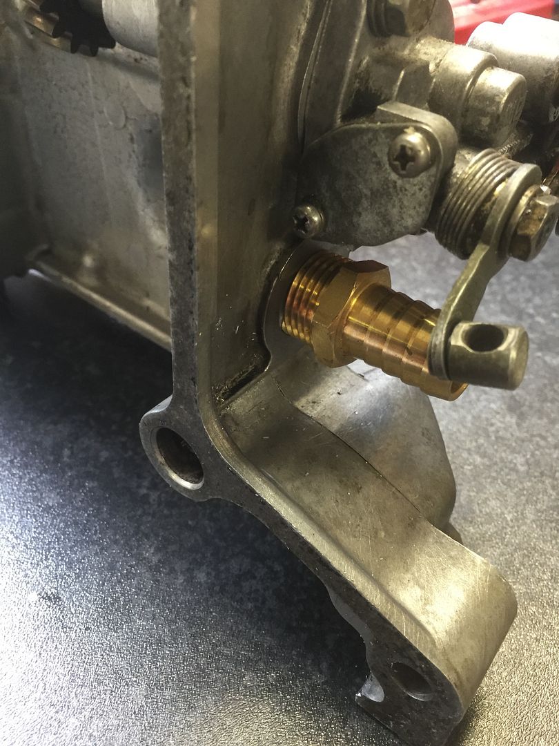

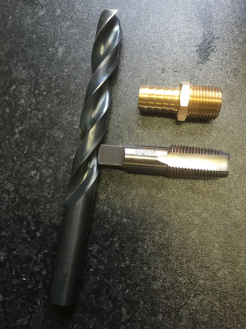

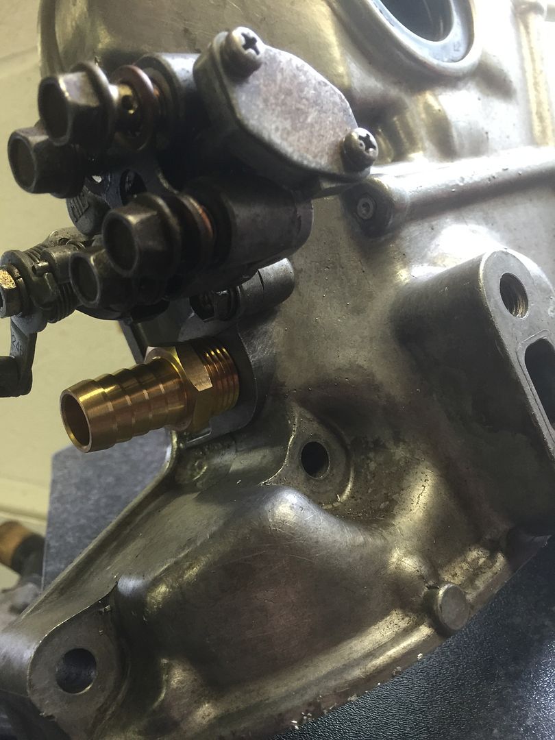

Drilled and tapped my front cover to take the oil return line from the turbo...
I bought a 18mm threaded brass union and a tap and drill bit to suit...

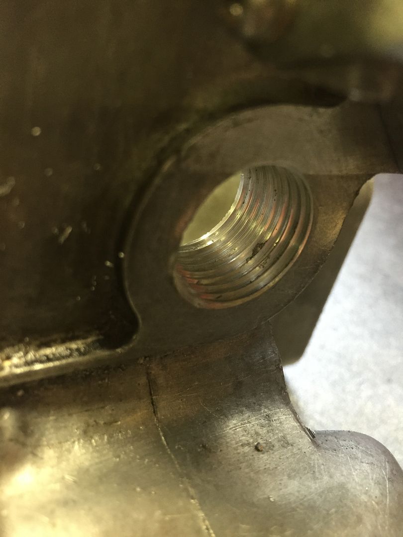

the main reasons i wanted a GSL-SE front cover, apart from it's capability to mount a S4 OMP, was that the area directly under the pump lends itself to threading in an oil return, the alloy around the pre-formed hole being very thick and strong...
I drilled it out and ran the tap through it...
and the oil return union fits a treat... just need a copper washer now before I tighten it all the way up...
