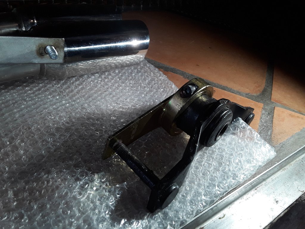

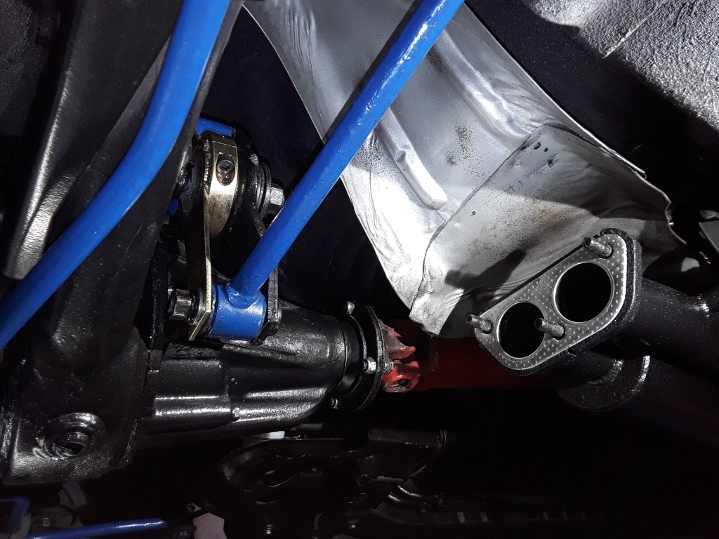

Suspension WATTS Link Anti-Shear Bracket for 79-85's mounted. I must corrected the screw before.
Thomas would you recommend fitting this type of Watts link if the rest of the car was standard ?
A7RXY wrote: Tue Jan 26, 2021 9:03 am Thomas would you recommend fitting this type of Watts link if the rest of the car was standard ?
I would recommend this type for more security if the centrifugal forces on your rear will be higher then standard or rust was a killer of your parts. So the two screw breaking on the road, you will need a new car i think.

I agree with Thomas quite strongly there. Many of these cars have bent watts link studs aye. :shock:
Any ideas where to get this link ?
https://www.mazdatrix.com/?s=Suspension ... +79-85%27s
