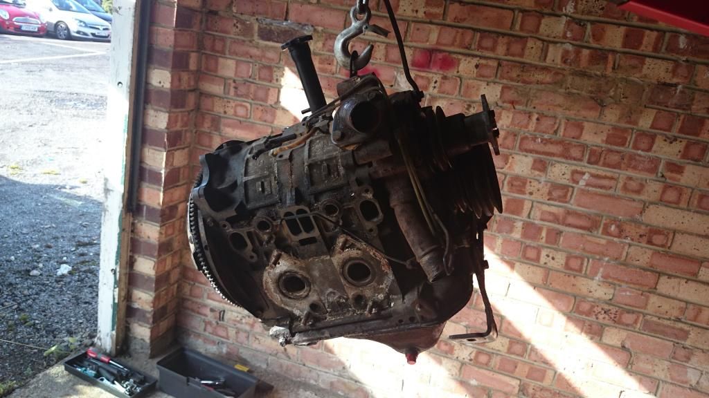

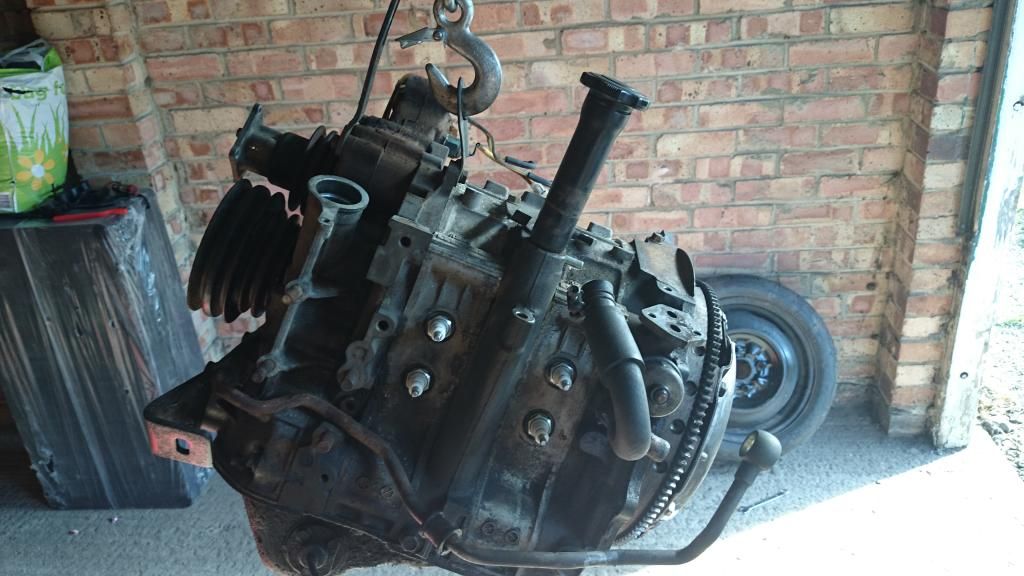

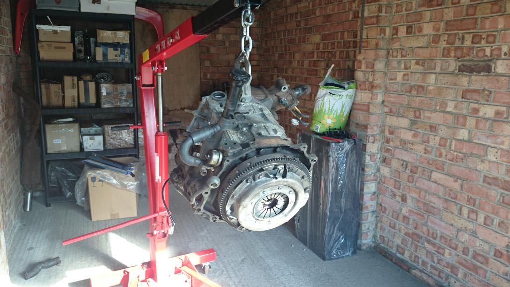

Had a bit of spare time so pulled some bits off the motor. It's so much easier when it's just hangin' on the crane!
Now all you have to do is wait for the inevitable 'how does it go back together'? questions :lol:

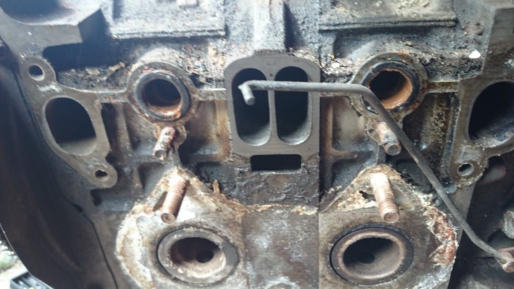

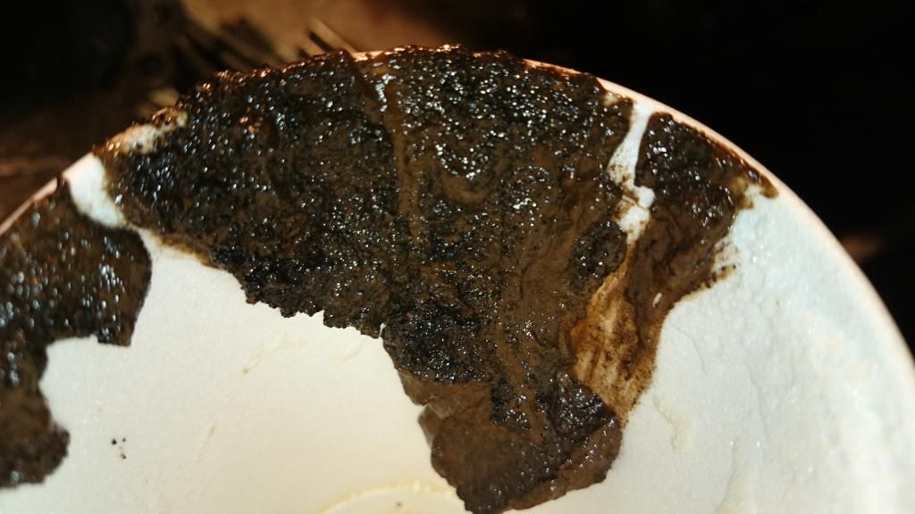

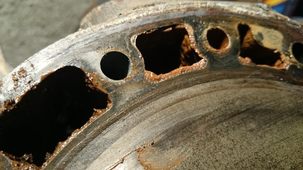

This is what blocks up your water passages. I've only ever seen it in dry solidified form but it is, in fact, the consistency and color of baby diarrhoea dark brown! It filled the whole chamber and is seen here almost all scooped out
And here in a coffee cup for your viewing pleasue ... yum :)

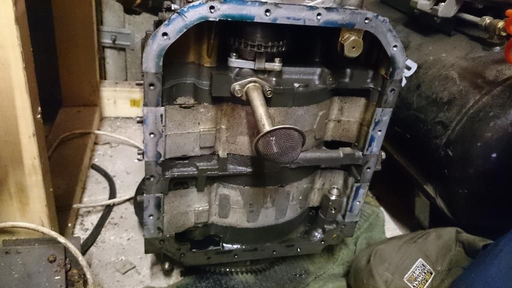

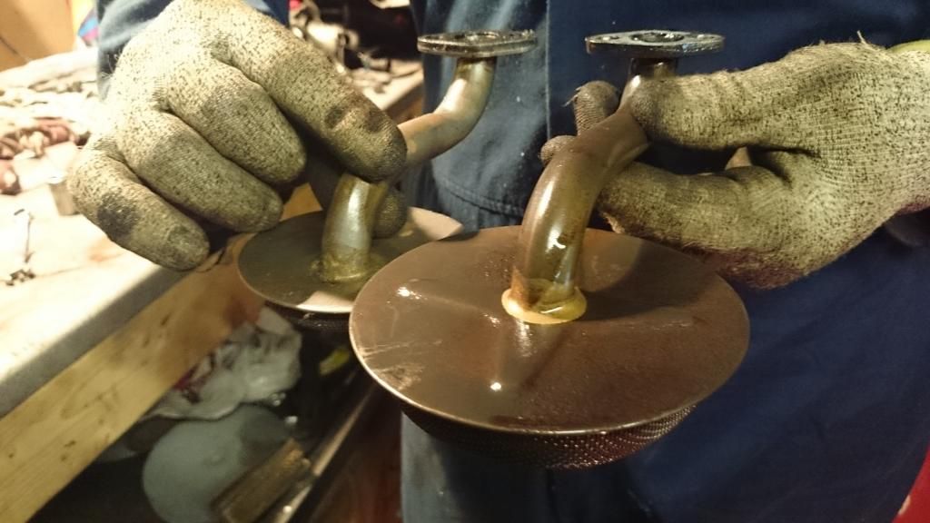

With the sump removed, surprisingly clean
An early style oil strainer alonside the much smaller later 12a version

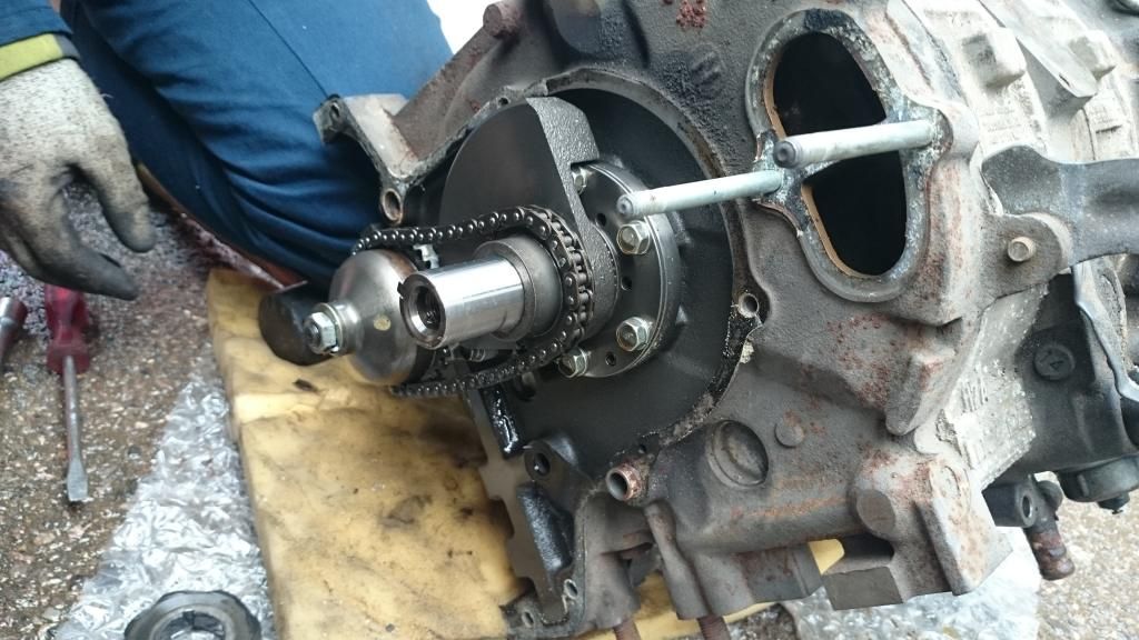

Front cover off
Once again, surprisingly clean!

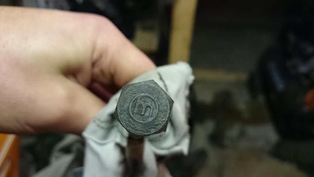

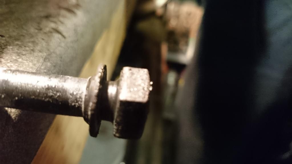

This is one of the long bolts that hold the motor sandwich in place. Note the 'washer' which is, in fact, a seal and is replaced at rebuild time.
This is a special bolt and is marked with the old mazda 'm' to identify it from the others. The reason for the specialness escapes me right now. Ask Mr Tool and he will explain :) More later .......
