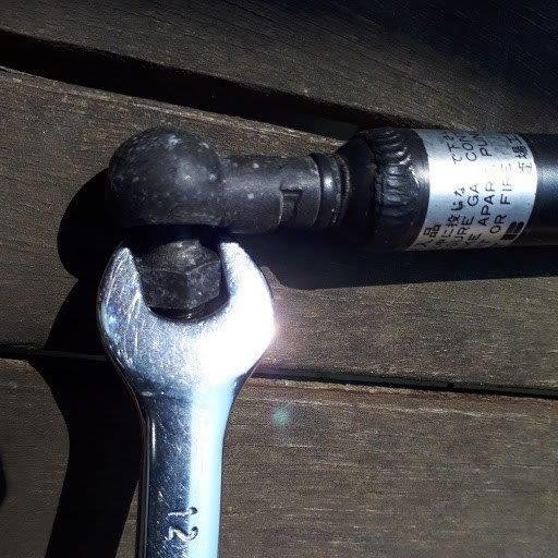

Anyone know what size spanner removes the strut from the body frame?
Needs quite a thin spanner to get in there too.
12mm too large and 11mm too small. Don't want to round the thing off. Only replacing one side for now.

^^ the nut on mine is a very snug 12mm. I assume series 2 & 3 use the same struts!

Re: Rear hatch struts - regas as good as new
Oh. Wasn't expecting that. I would have thought S2/S3 would be the same as well although Mazda does love playing that game of changing sizes and thread pitches for no apparent rerason.
Ingenuity required then.
