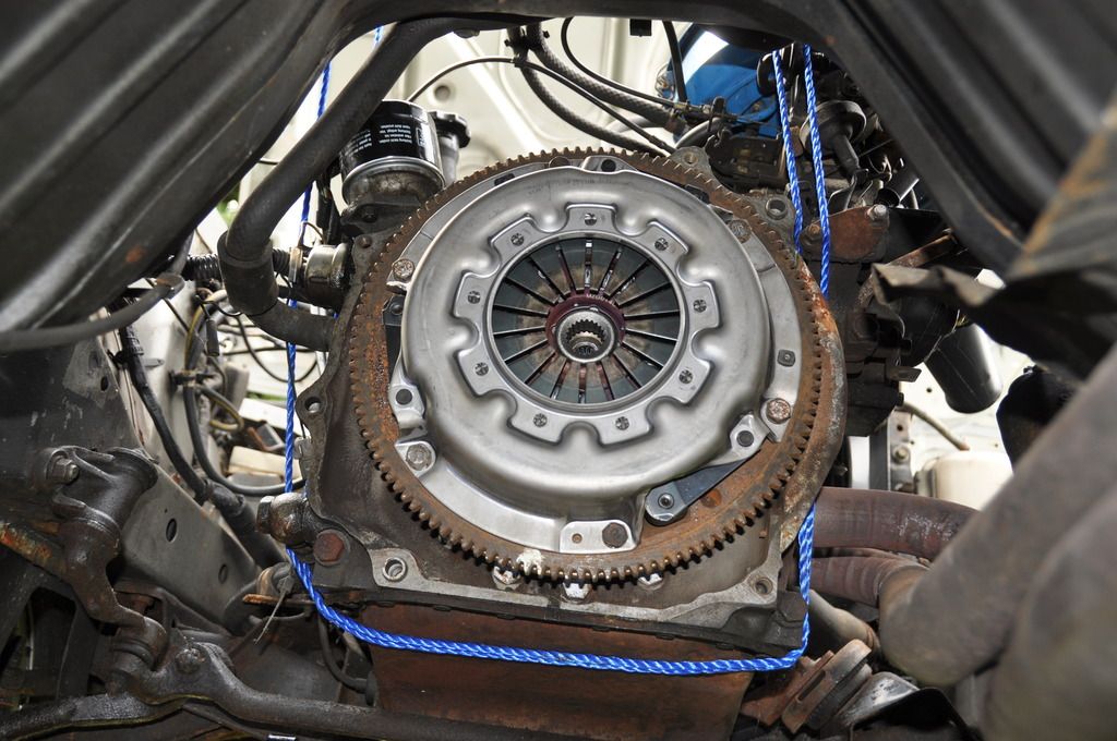

New Exedy clutch fitted;

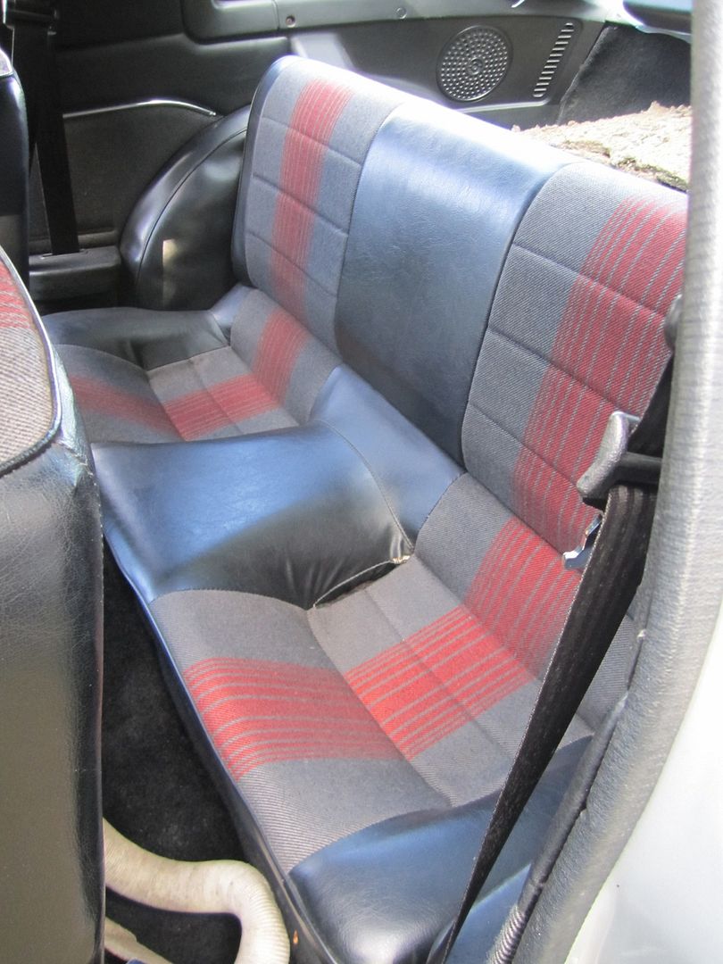

Rear seat in good shape

Very good basic for making the car perfect in future. Why you tape the rear wing hole? No aerial?
Some extra points for red stripe :lol:
Hope you can have fun next week and ride your car before the snow is coming.
It's always the best in return for your services.
