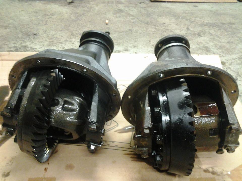

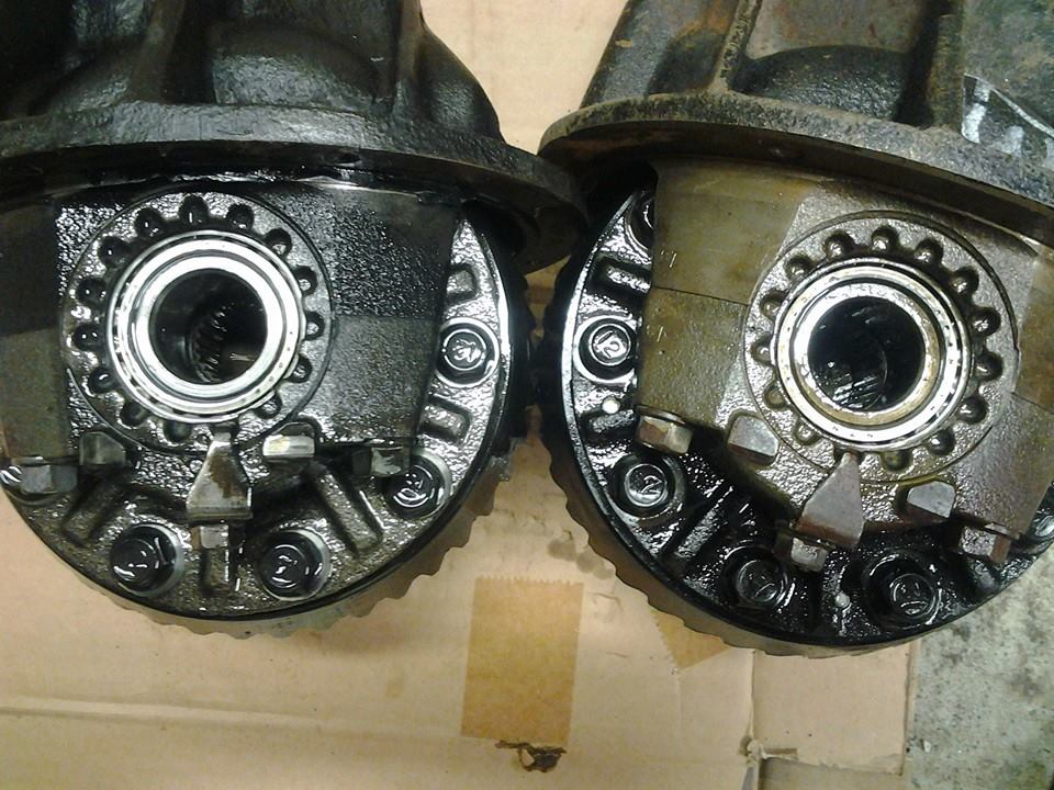

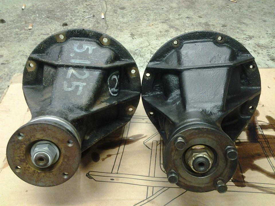

re japi
Posts: 198
Location: Finland
Re: Project Finnish dirtkicker
Post by re japi »
Here they are. Only difference I can see is that spline thing. I put my 24 spline shaft to lsd diff, it just turned around there. So that 26 spline has bigger diameter too...
No I´m very very confused :D (hp)
stock diff on left, lsd diff on right
lsd diff on left, stock diff on right
Stock diff on left, lsd diff on right
You have a S3 LSD. You need a S3 rear end to use it, assuming the flanges are the same.
Or you need 24 spline side gears for the LSD. That's the expensive part.
