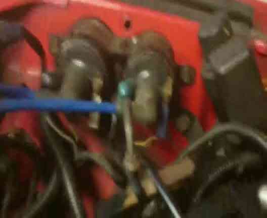

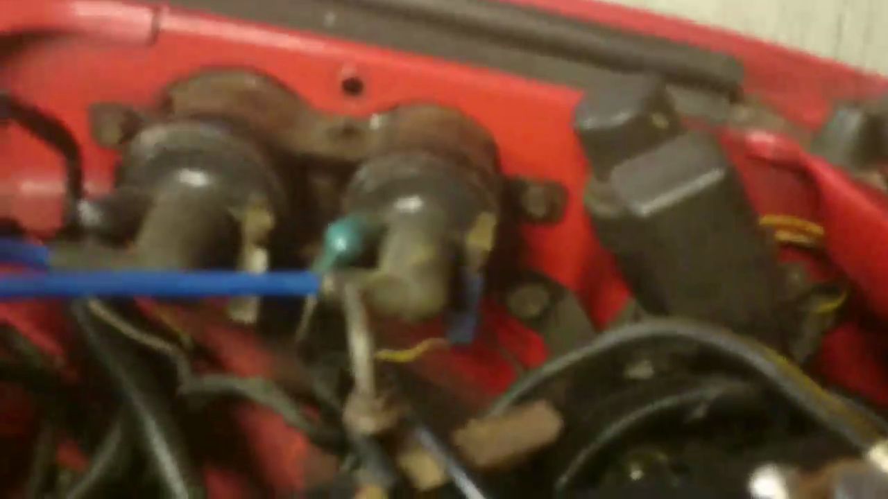

Sparks off trailing coil. (rear rotor HT leads disconnected) It's not the HT lead to the dizzy either, tried several with same result. Odd.

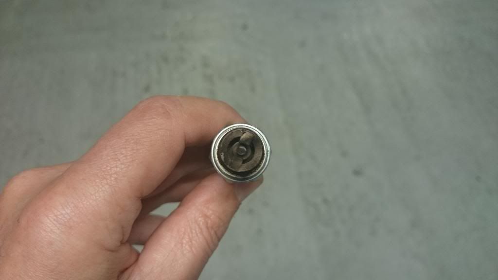

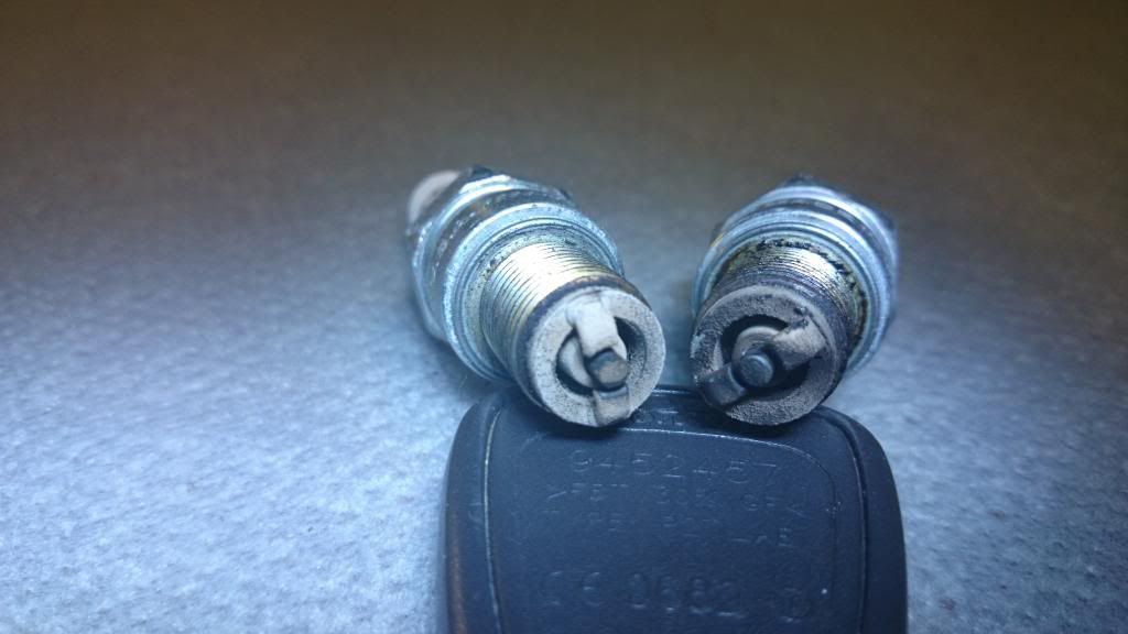

Plugs out of the good rotor ...
Trailing is very light grey ... signs of a little lean?
Leading is darker
This is the same result as the previous two sets that have come out. Nothing earth shattering, just interesting.

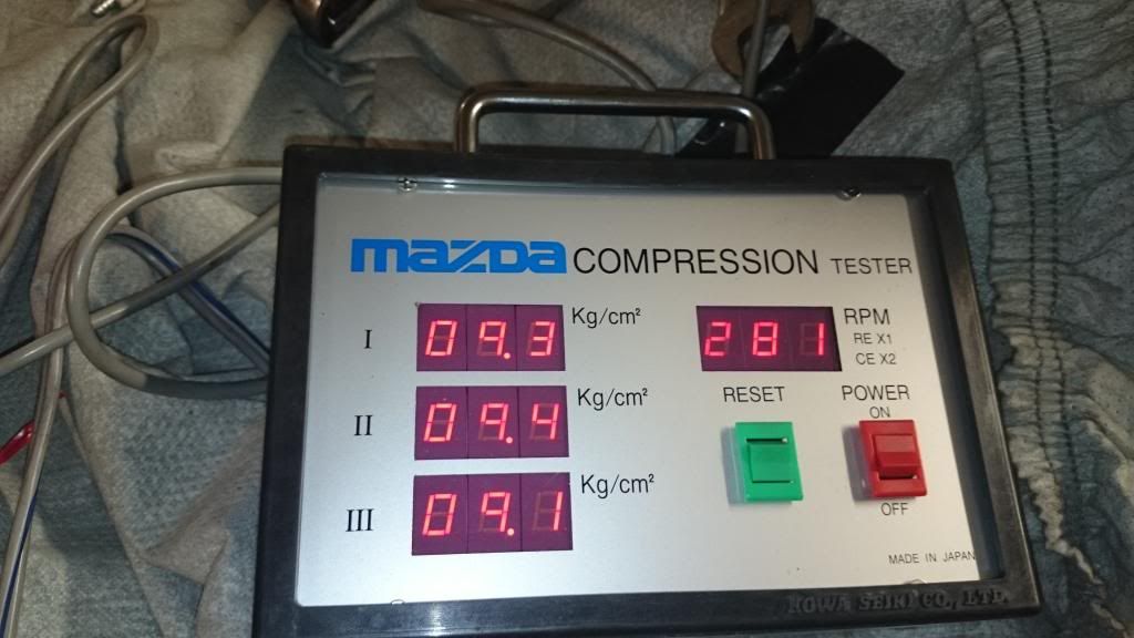

Mr TOOL and his magic box of compression measurement made a special house call.
The bad news ... front rotor totally fails with BIG FAT ZERO.
The good news ... rear rotor gives a stunning performance
So in this case, knowing the numbers is a big plus. Cuts down the shopping list for a start.
