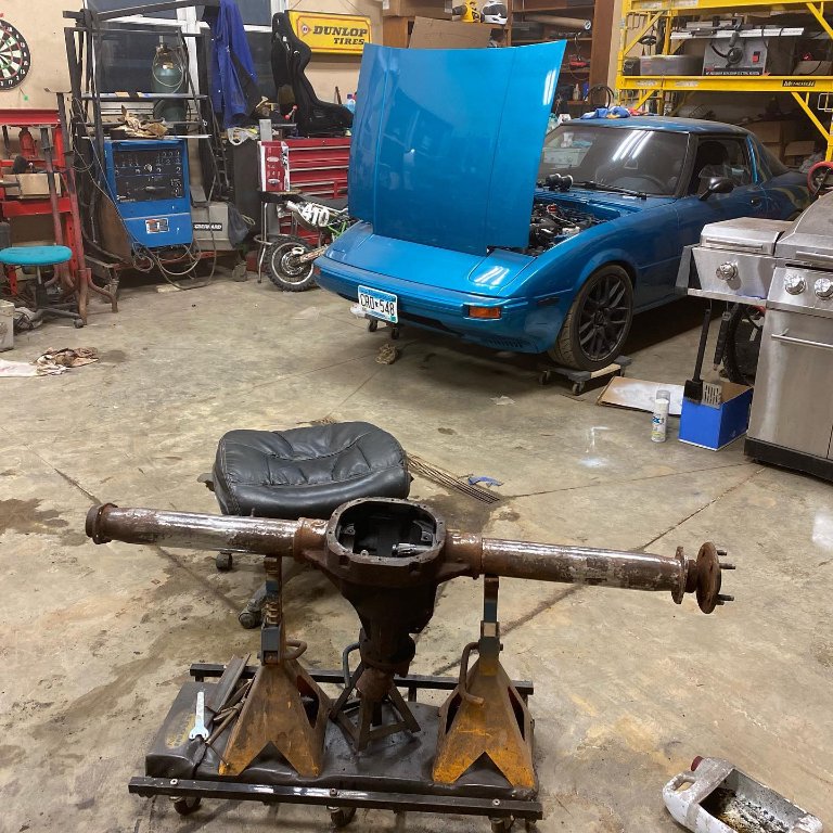

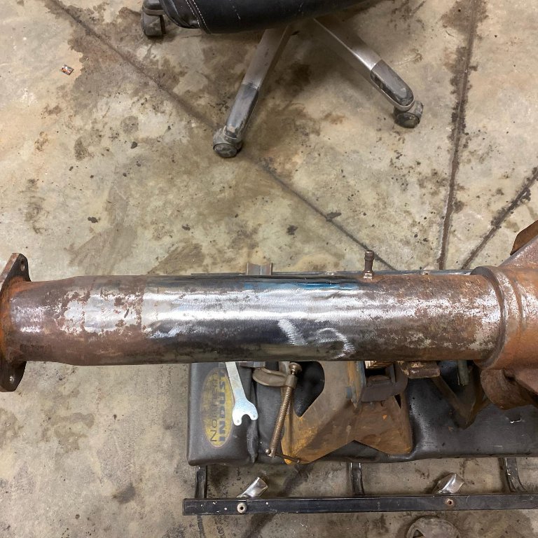

got my ford rear end cut and welded... came to a halt as I 2nd guess some other stuff with the build of it..

DWNUNDR wrote: Tue Feb 04, 2020 6:03 pm got my ford rear end cut and welded... came to a halt as I 2nd guess some other stuff with the build of it..
Axle is looking pretty good there. In a bit of a dilemma? :?

no dilemma... just want to clarify some measurements, and which way I want to go with brakes ie: fc calipers and custom brackets (grannyspeed sells a kit or make my 5letter ones to fit using custom designed brackets (me) or use ford stuff... which I need to replace due to rusted condition it all came with.. but then the ebrake wont work...
then I also need to get axle face to axle face measurements from stock axle compared to my custom rear setup... then know if my current rims will work... if they dont then I may just buy a pair of 5 bolt ones to suit and run stock ford axles... Im hoping the length overall is about an inch less, then if my thoughts are correct it will bring my current rims in nicely as they sit right out and if I lower it more it will rub... so far it doesnt where it sits...
THEN I need to finish my custom brackets for the control arms.. ie flowjet them at work.. but what Id like to do is get a half cut of a first gen and using the stock arms etc hang it on a wall/stand as a jig then be able to locate exactly where to weld to locate the rear end correctly.. then once that is done I need to make a bracket for the watts link??.... or I have to drop the rear end out of my car and I dont want to do that till it blows up or till Im ready.. Id rather not blow it up as I could sell it for a few hundo and pay for the 8.8 conversion Ive created haha
