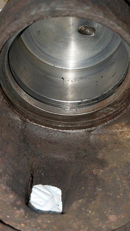

Although my car passed the MOT, the tester did mention a slight drag on both the front brakes, so I thought I should check it out. I had, not long ago, cleaned and re-greased (Ceratec) the sliders, so, unsurprisingly, that wasn't the issue. Nor was it a hydraulic issue. The pads were also freely sliding on the end clips and the "Z" spring was in position correctly. However, the pistons were not retracting freely, so I decided to remove the driver side caliper first to take a look. Before disconnecting the hydraulic line, I used the brake system to push out the piston into a block of wood, having discovered from experience, this is the best way to get the piston out.
The caliper needed some TLC!
Driver side brake piston caliper , before cleaning.jpg (64.82 KiB) Viewed 12613 times

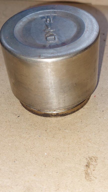

The piston seal and rubber boot were in excellent condition, but I have a new set, so will use those on re-assembly.
Driver side brake piston, after cleaning 2.jpg (55.01 KiB) Viewed 12613 times
The inner bore was fine, and so was the piston, but I couldn't slide the piston back in as rust had accumulated around the bore outside the piston seal. Here I have removed the piston seal and started to remove the rust. Once finished, without the seal replaced, the piston slid freely in and out.
Driver side brake piston caliper bore.jpg (76.29 KiB) Viewed 12613 times

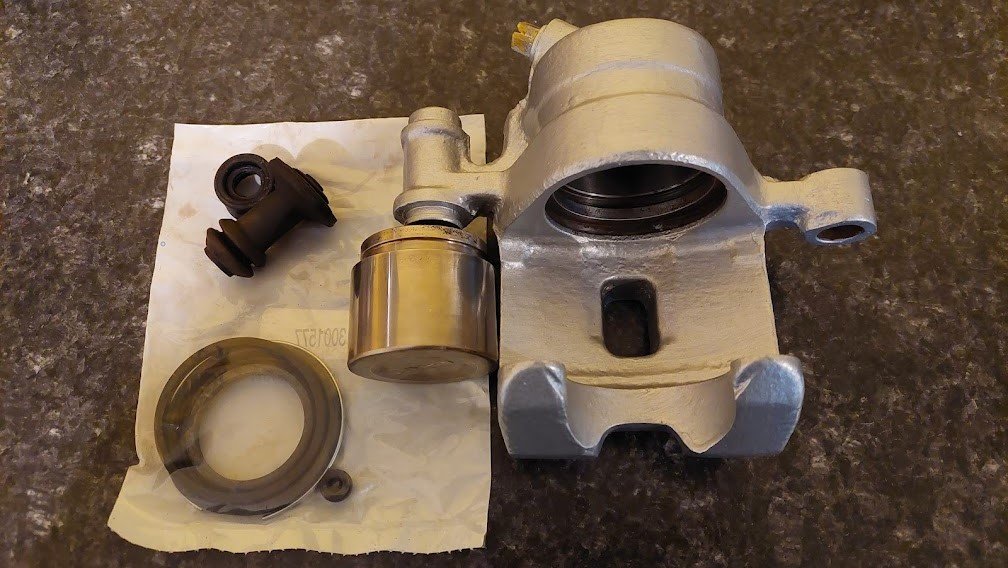

I removed all the rust I could, degreased the caliper and gave it two coats of Hammerite smooth silver. Nearly ready to re-assemble, just waiting for the Hammerite to cure - it still seems a little soft and tacky after 24 hours :?
Driver side brake caliper kit.jpg (126.95 KiB) Viewed 12613 times
Re: KIMI 3 - 1984 Series 3
nice work, it's usually rust under the piston seal what makes it stick...... not the most enjoyable job to do but strangely satisfying whey they are all done and finished.

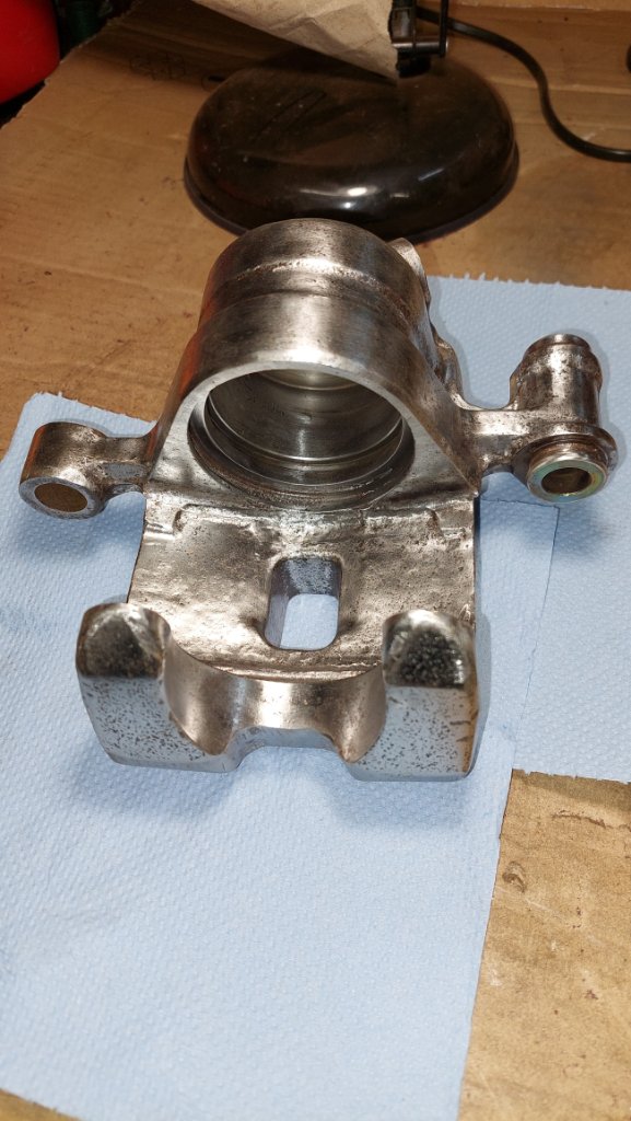

Passenger side front caliper refurb in progress....

Good work Malcolm, that is very shiny silver paint :clap: Do you cover it with lacquer?
Hi Pete. :D No, that's just the completion of cleaning as much rust as possible from the steel - no paint yet applied. Next stage is degrease, then two coats of Hammerite smooth silver (see earlier photo of completed driver side refurb'ed caliper).

Both front calipers now reinstalled and system bled. Ready for a test drive today, if roads are dry.
Passenger caliper with 2 coats of hammerite and new seals fitted.
