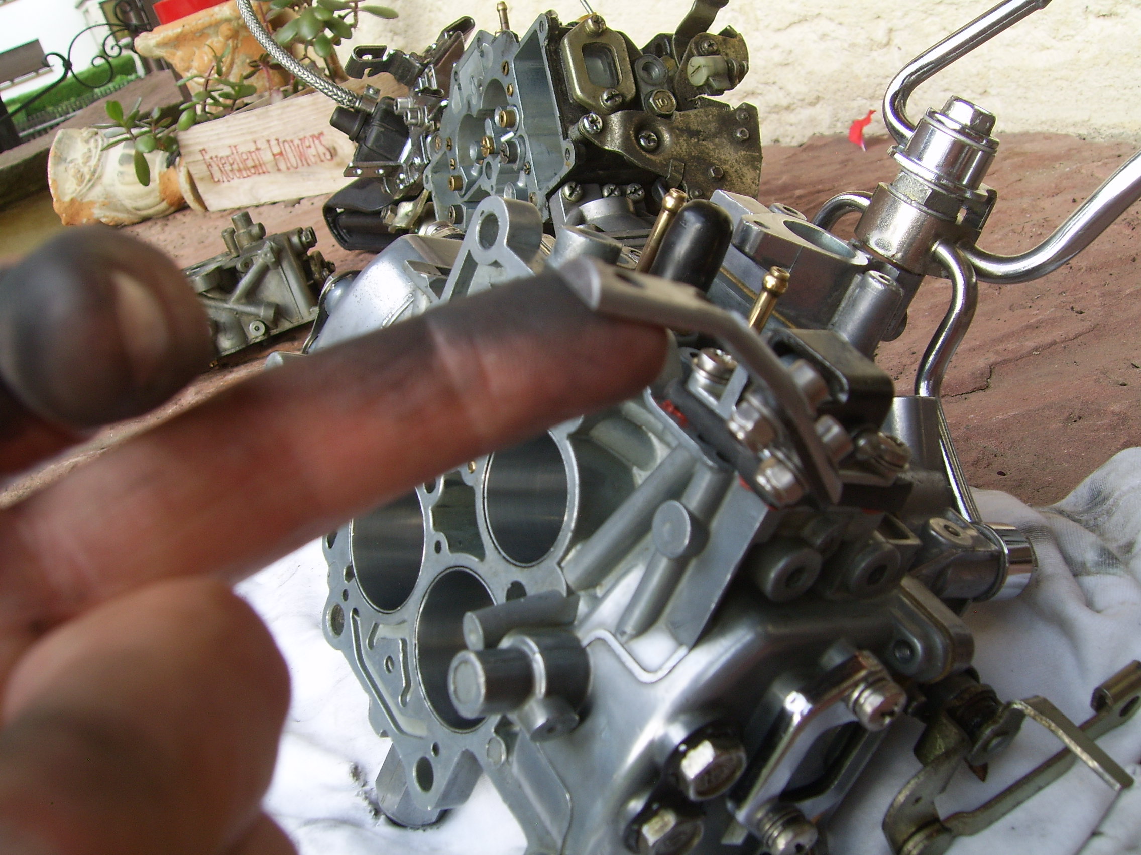

Looks like you did some excellent machining work there Thomas. More agressive than i did judging by the thin wall of the finished venturi. Is the a primary ventrui fitting inside the primary in that picture?
Is the signal still strong with the primary opened up? I guess it must anyway be stronger than if it was a 48 Ida Webber? And you have the joy that comes from driving with secondaries h[b[
Did you remove the choke?
biznatch wrote:Looks like you did some excellent machining work there Thomas. My friend Heintje do it needs 4 hoursMore agressive than i did judging by the thin wall of the finished venturi. Is the a primary ventrui fitting inside the primary in that picture? Yes
Is the signal still strong with the primary opened up? Yes bridgy idle at 1800 U/min I guess it must anyway be stronger than if it was a 48 Ida Webber? And you have the joy that comes from driving with secondaries h[b[ Yes i have cause of the good balanced engine but need some more detail tuning
Did you remove the choke?no

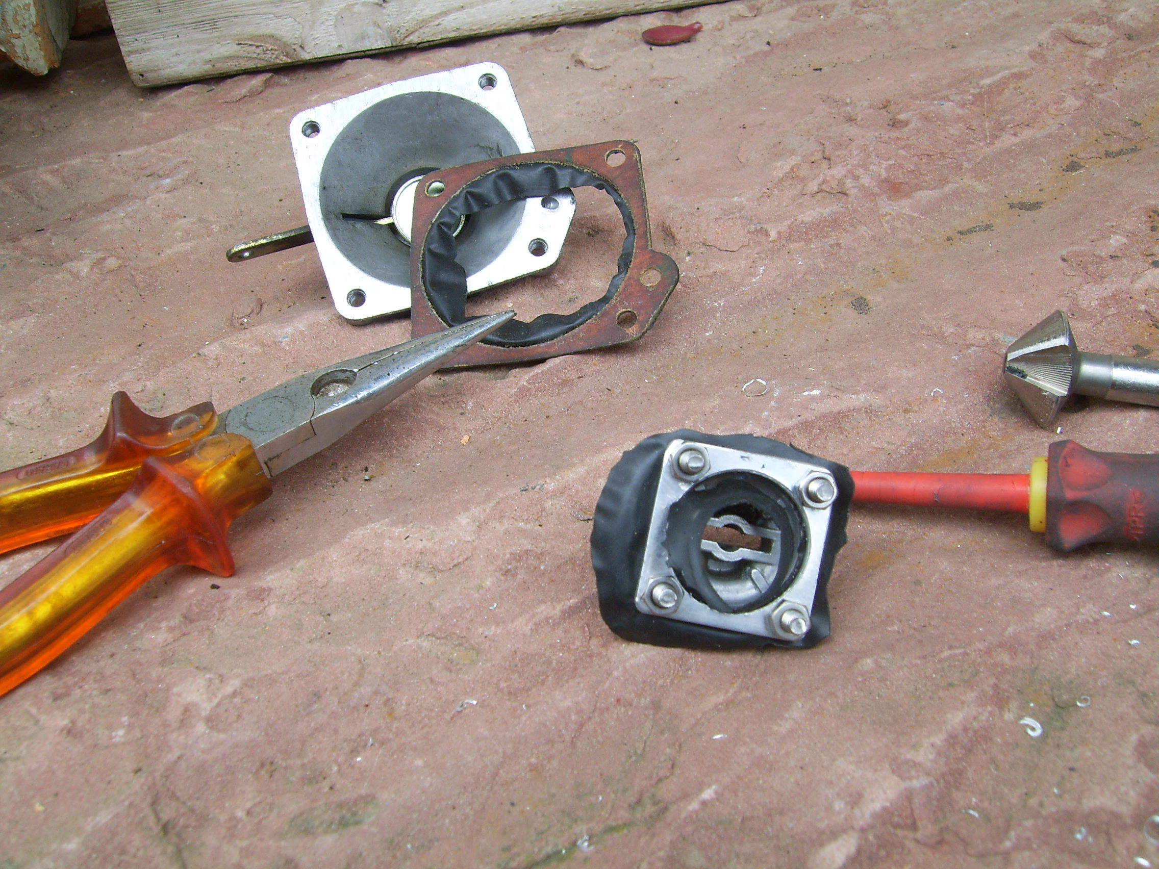

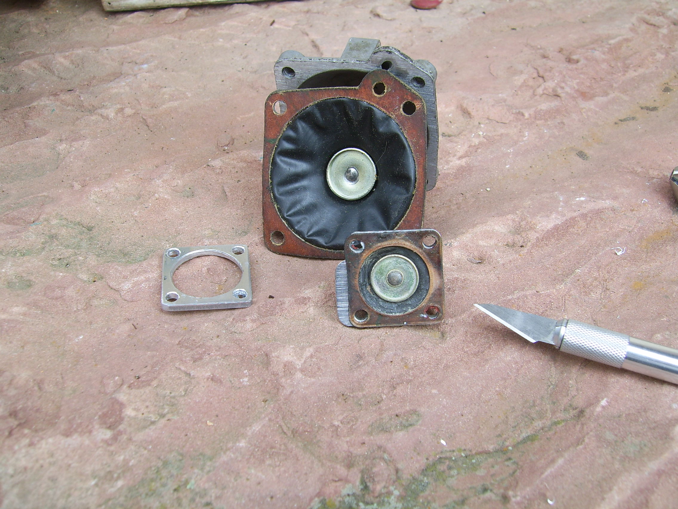

I did my own spacer for the accelerating pump housing. For sealing i take the old vacuum diaphragm.
the accelerating pump rod is the cut of part from the throttle valve shaft

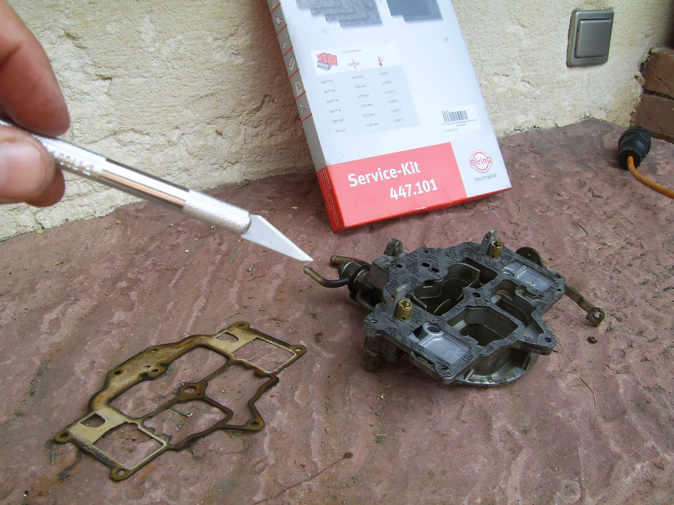

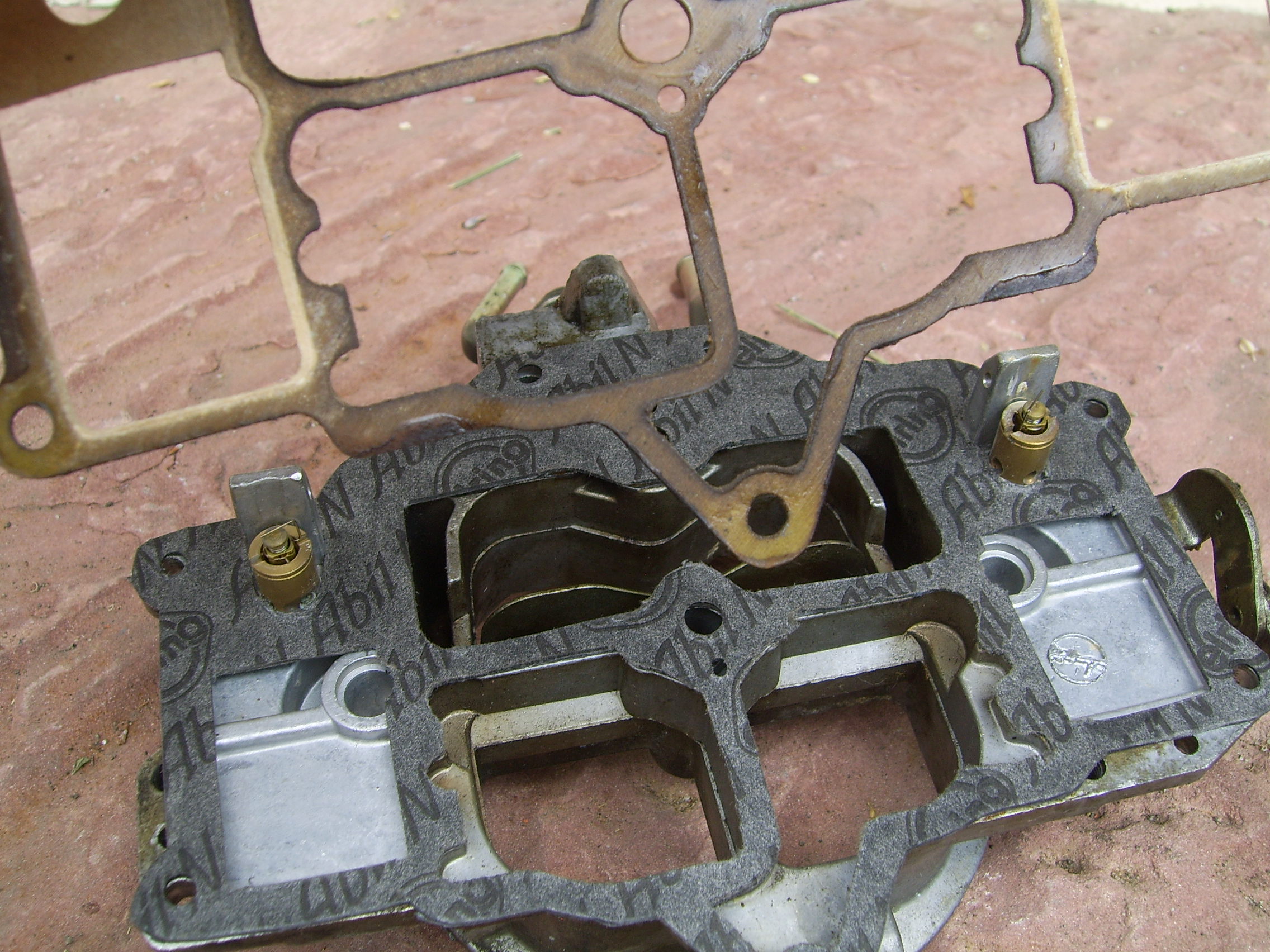

You can see the different between the homemade and the mazda seal:
Nice work Thomas, your gasket looks a lot better than the Mazda item
